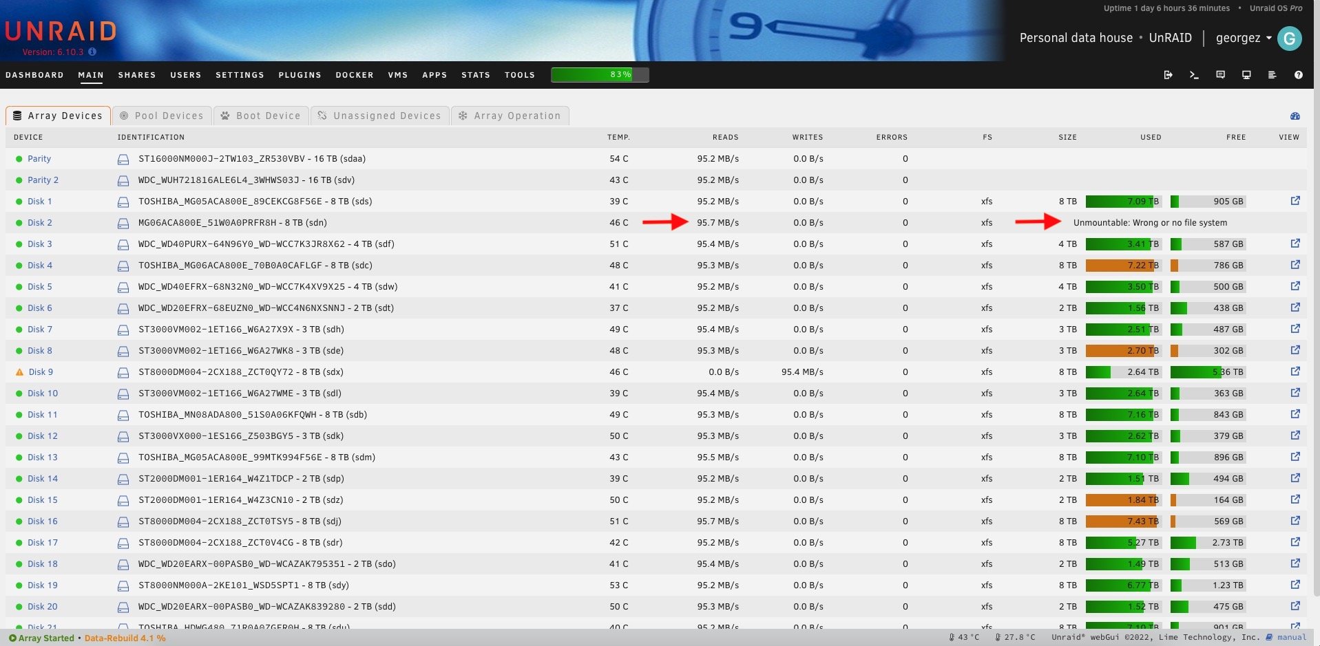

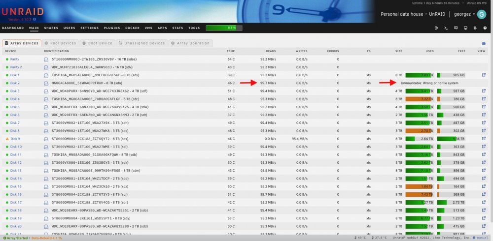

My array has 2 parity disks (one 16TB, one 8TB), recently one of the array disks (disk9, 3TB) was broken, so I bought a new 16TB, assigned it as the parity disk (to replace the old 8TB one), and re-assigned the old 8TB parity disk as disk9. When I started the array, everything seemed ok, the array first copied the parity data from the old 8TB disk to the new 16TB disk, then the array started rebuilding disk9.
But here comes a weird thing: one of my array disks (disk2) was marked as 'Unmountable: Wrong or no file system', but the array was still reading data from it to rebuild the disk9, is this even normal? Will the rebuild be good?

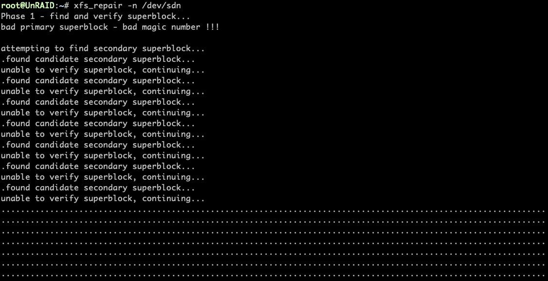

Ok, the rebuild has been complete, I've restarted the array in maintenance mode, use xfs_repair to scan the disk2 (sdn), xfs_repair is now looking hard for the superblock, will report when it's done.
That's not the correct device, see the link above, or just use the GUI.
What do you mean that's not the correct device, the /dev/sdn is the disk that's not mountable.

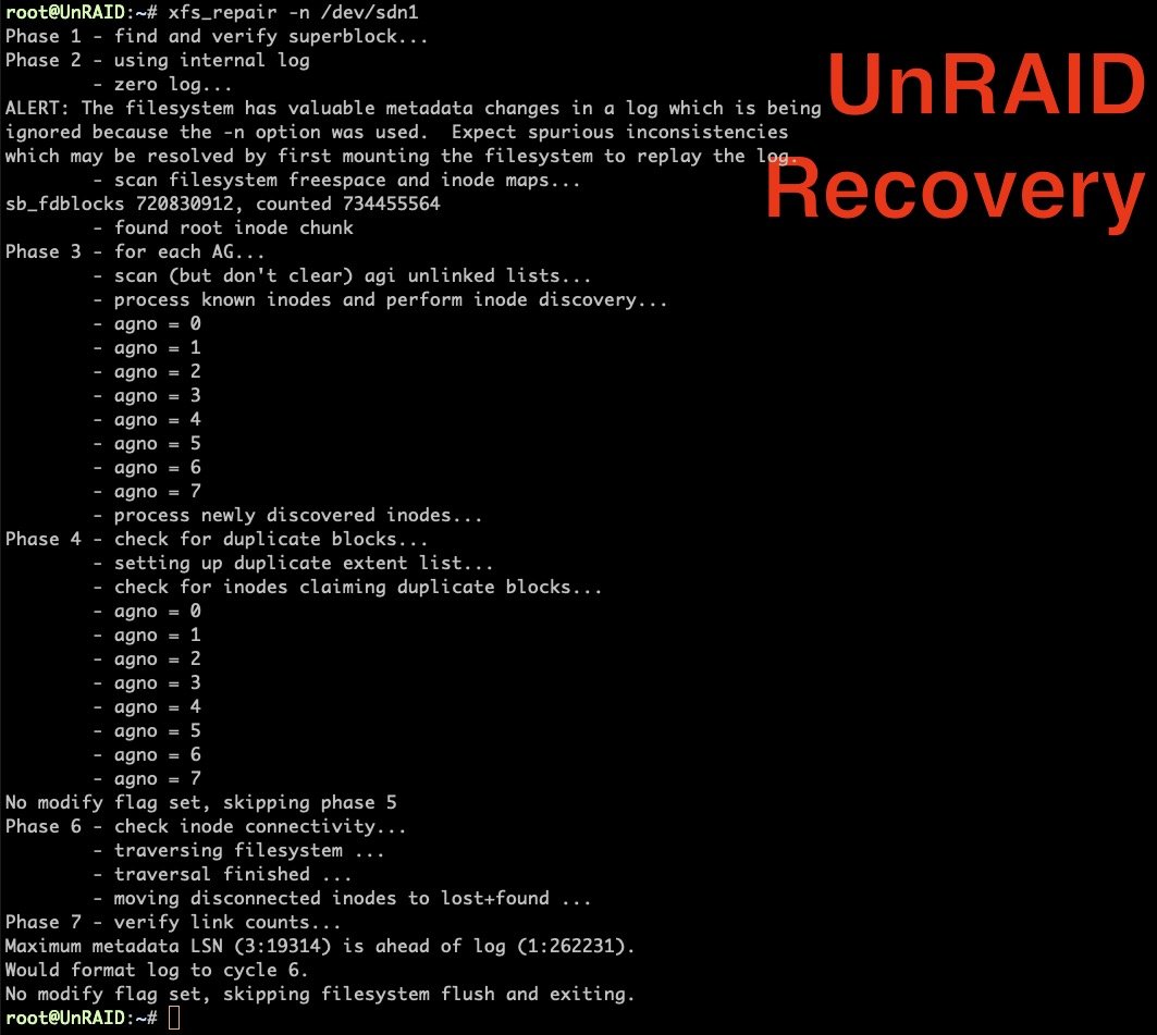

Ah I get your point! I need to scan 1st partition (/dev/sdn1) instead of the whole disk (/dev/sdn). I restarted the xfs_repair, this time it ends quickly with some kind of issue (shown in screenshot), I guess the next step is to re-run the xfs_repair to fix that?

Still not the correct way of doing, you must use the md device, or parity will become out of sync, use:
xfs_repair -v /dev/md2
Thanks for the clarification. Now the disk is fixed, I'm running a parity check with 'Write the corrections to parity' option checked, I assume it's the right way because their must be some mismatch between the parity and the disk being fix, so the parity needs to be updated.
