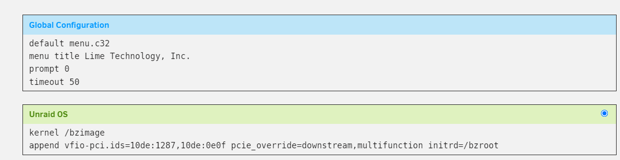

July 7, 20224 yr I am currently working on passingthrough a GT 730 and having trouble getting unRaid to stop using it. I have previously passed through this gpu without any vbios or issues, but that was with x2 GPU installed. I know it is possible to stop unraid from binding the GPU on boot but it doesnt seem to be working. What am I doing wrong? syslinux config: kernel /bzimage append vfio-pci.ids=10de:1287,10de:0e0f pcie_override=downstream,multifunction initrd=/bzroot

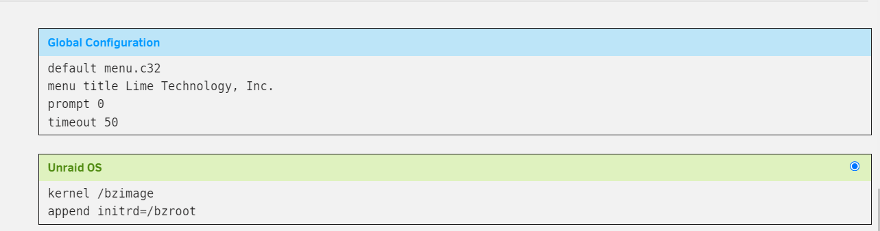

July 7, 20224 yr No that isolates it from the system. (And dont forget to also remove your manual edits to syslinux.cfg)

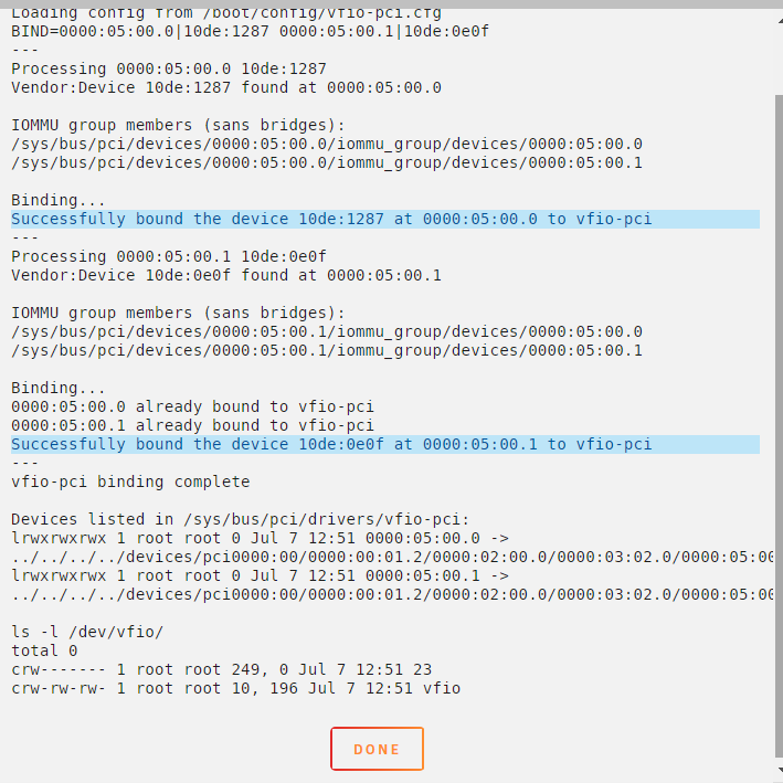

July 7, 20224 yr Author 6 minutes ago, Squid said: No that isolates it from the system. (And dont forget to also remove your manual edits to syslinux.cfg) Okay, it appears if though unraid believes its binding it, but then doesnt bind it...
July 7, 20224 yr Author 1 hour ago, Squid said: Why do you think it's not binding it. well its still using it at boot to display unraid terminal and wont let me use it for VM so im confused.
July 8, 20224 yr 12 hours ago, Servs said: its still using it at boot to display unraid terminal This is ok, you will get some video output on boot, because vfio driver attaches after some other things. You should have last lines on the monitor outputting something like: vfio-pci 0000:xx:xx.0: vgaarb: changed VGA decodes: olddecodes=io+mem,decodes=io+mem:owns=io+mem where vfio takes control over the gpu. 12 hours ago, Servs said: and wont let me use it for VM This depends on something else.
