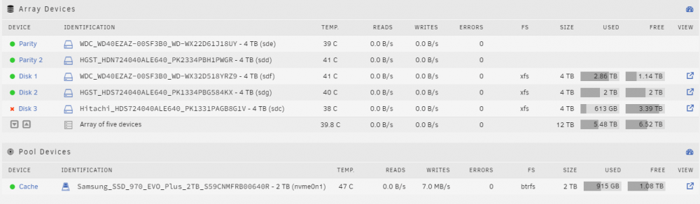

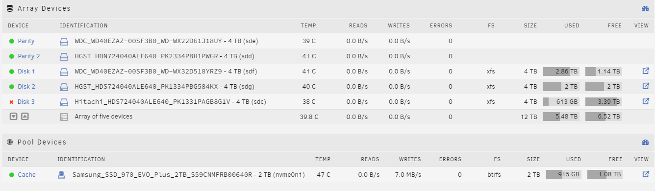

Device is disable. (Disk 3). When a device is disabled, what must be done to enable it?
The power cable to Drive 3 became disconnected. That as been corrected, but Drive 3 remains disabled. I have looked at other topics, and so far I have not found a solution. See attached Diagnostics and Drive info.
I am pretty sure the drive is OK. I can't find any errors in the logs, but I do not fully understand all the info in the logs. Currently the SMART extended self-test is 80% complete with no error being reported. The shorter version of SMART self-test passed.
I have rebooted the server a couple of times and stopped\started the array, but Drive 3 remains disabled.   When a device is disabled, what must be done to enable it?
I am also trying to figure out why Bluetooth is not working in Windows 10 nor Windows 11, but that is a lower priority right now. Just throwing it out there in case someone sees something obvious in the diagnostic files.
tower-diagnostics-20220709-0133.zip Hitachi_HDS724040ALE640_PK1331PAGB8G1V-20220709-0133 disk3 (sdc) - DISK_DSBL.txt
