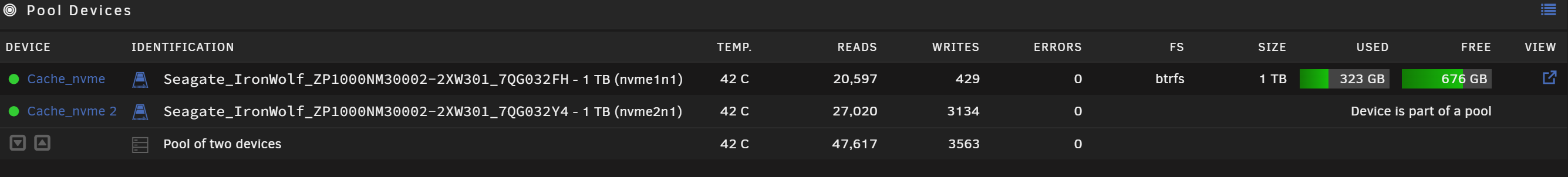

July 11, 20224 yr Hi, I woke up this morning to a Fix Common Problems error. This appears to be identical to this error: https://forums.unraid.net/topic/94659-solved-btrfs-issues/ My cache pool is this: I downloaded diagnostics, but it was inside a VM (stupidly), however I've attached the reports from the syslog folder. I was in a hurry to stop the server in case of corruption. Prior to this, I ran btrfs dev stats /mnt/cache_nvme It was full of errors. I tried a scrub and since rebooting I've run it again. you will note there are still errors but not nearly as much. I'm guessing the cache drives dropped out. Quote root@Nexus:~# btrfs dev stats /mnt/cache_nvme ERROR: cannot check /mnt/cache_nvme: No such file or directory ERROR: '/mnt/cache_nvme' is not a mounted btrfs device root@Nexus:~# btrfs dev stats /mnt/cache_nvme [/dev/nvme1n1p1].write_io_errs 0 [/dev/nvme1n1p1].read_io_errs 0 [/dev/nvme1n1p1].flush_io_errs 0 [/dev/nvme1n1p1].corruption_errs 0 [/dev/nvme1n1p1].generation_errs 4 [/dev/nvme2n1p1].write_io_errs 104169165 [/dev/nvme2n1p1].read_io_errs 31314052 [/dev/nvme2n1p1].flush_io_errs 4340 [/dev/nvme2n1p1].corruption_errs 0 [/dev/nvme2n1p1].generation_errs 0 root@Nexus:~# I've attached Diagnostics.zip which was before I stopped the array. After stopping the array, it couldn't find nvme2n1. I did a reboot to clear the logs as the system log was full. I've attached full diagnostics after rebooting into maintenance mode. I cannot restart docker or VM service, as they were on these drives. Currently, status is stuck on trying to unmount shares. I've had to kill a process to get it to shutdown. Could somebody please help? Fortunately, I did a lengthy sync of the important stuff last night to an undefined drive. Im wondering if this caused the issue in part?! Last parity check was on the 02/07/2022, completed without errors. I remain unsure what the next steps are? Should I dd an image of the cache, which is 500gb? I remain concerned about bitrot, corruption, etc. I've left the server shutdown for now. Diagnostics.zip nexus-diagnostics-20220711-1034.zip

July 11, 20224 yr Author Hi Jorge, thank you for taking the time to reply. I've mounted the second drive and running an rclone copy at the moment. I was going to dd image the disks, would you say it would be prudent to do?
July 11, 20224 yr Community Expert Solution Second 27 minutes ago, Geck0 said: I've mounted the second drive Jul 11 10:11:35 Nexus kernel: BTRFS: device fsid 653150f2-f281-4987-bb45-f3e553c14b9c devid 2 transid 534361 /dev/nvme2n1p1 scanned by udevd (1391) Jul 11 10:11:35 Nexus kernel: BTRFS: device fsid 653150f2-f281-4987-bb45-f3e553c14b9c devid 1 transid 542551 /dev/nvme1n1p1 scanned by udevd (1402) I assume you mean devid 2 (nvme2n1)? The other device will be out of sync. If yes it's always good to make sure backups are up to date, if you mounted devid2 by itself read/write best forward is to wipe the other one and then re-add to the pool.
