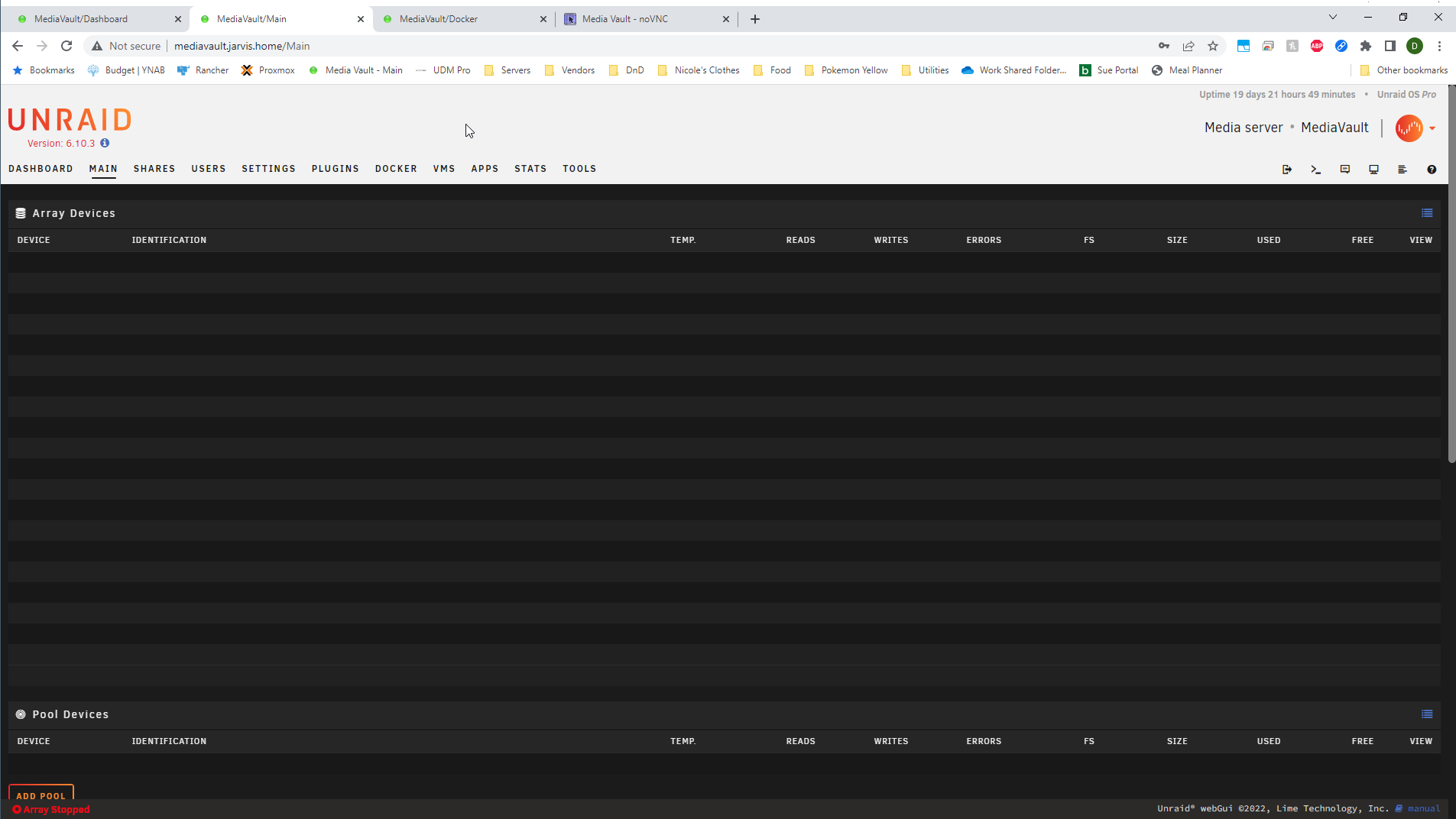

July 12, 20224 yr Hello, I recently got a pair of 16TB WD Golds and wanted to put one as my parity disk (upgrading from a 4TB) and then once that is completed, add in the other 16TB as a data disk plus move the old 4TB as another data disk. I have precleared both 16TB disks and had them mounted in unassigned devices as a local backup while I was figuring out some file system issues and waiting for my cloud backup to finish. Searching through the forum I found this process from @Squid which states: Quote Stop the array Assign the 12TB as parity drive Start the Array and let it build the parity drive After that's done, stop the array and add the original 8TB as a data drive 5. Unraid will clear it in the background and when that's done (hours), then the storage space is available. The standard way does give you a fall back, as the original parity drive is available for you to reinstall if something terrible goes wrong. I stopped the array and in Main clicked to select the 16TB disk to replace the existing parity drive. Once I did, the screen changed and now none of the disks are showing up: Refreshing the page does nothing, and switching back and forth to another page does nothing. Trying to open the log in the top right shows the window for a second and then closes without displaying any info. The unassigned devices section on main is just spinning with the wavy Unraid logo. Attempted to download diagnostics file, but it's just sitting there after clicking download. I wanted to post in here before I did anything else to not potentially mess something up. Thanks for your help. Unraid Pro v6.10.3 SOLUTION: This ended up being a DNS issue. I run PiHole as an Ubuntu VM on Unraid, as use that for local DNS resolution. When I stopped the array, it shut down the VM so Unraid would only display the cached webpage data. Once I changed the DNS info on Windows and went to the IP address of my server, the problem resolved itself. Edited July 14, 20224 yr by Arcaeus
July 12, 20224 yr Author Alright looks like we're back online. Do I have the process right or is there something else I should be doing?
July 12, 20224 yr Author 16TB drive is in and parity is rebuilding. This time I put "no disk" on parity, then selected the 16TB. Guess it just got hung up somewhere. Thanks for your help.
