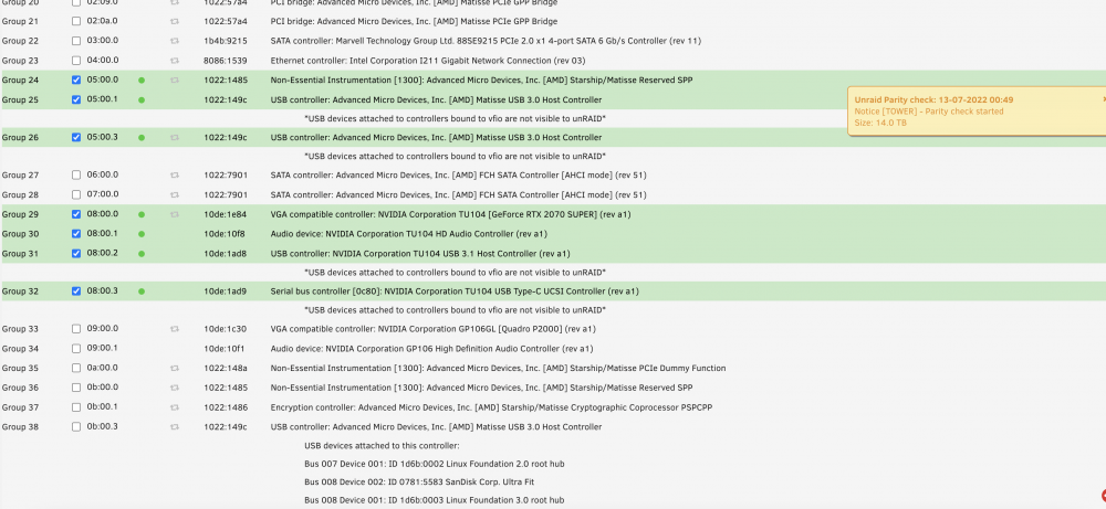

July 13, 20224 yr I had a windows VM that used to run just fine. Today I noticed my screen completely frozen and when I restarted the VM, it kept hanging on the TianoCore screen. I am on v6.9.2. Nothing was really changed in the VM settings or on Unraid before this happened. A few times I have also come across a blue screen during booting with Windows saying A required device isn't connected Some of the things I have tried out: I had a USB host controller passed through [Group 26 05:00.3] USB controller: Advanced Micro Devices, Inc. [AMD] Matisse USB 3.0 Host Controller. Reading a couple of other threads suggested passing through : Group 24 05:00.01 Non-Essential Instrumentation [1300]: Advanced Micro Devices, Inc. [AMD] Starship/Matisse Reserved SPP which led to an error saying Group 25 is not owned so passed through: Group 25 05:00.1 USB controller: Advanced Micro Devices, Inc. [AMD] Matisse USB 3.0 Host Controller [Note]: Did this through the VFIO - PCI plugin and rebooted each time Read about Ryzen 3900x needing a specific RAM speed. So reduced mine to 2667 (I have 4 sticks of ram with 4 slots) I copied over the original VM XML Windows VM XML - Original - Worked previously, not working now: <?xml version='1.0' encoding='UTF-8'?> <domain type='kvm' id='1'> <name>Windows 10</name> <uuid>b7f4eb1d-93e5-c186-769f-9df71797fb45</uuid> <metadata> <vmtemplate xmlns="unraid" name="Windows 10" icon="windows.png" os="windows10"/> </metadata> <memory unit='KiB'>33554432</memory> <currentMemory unit='KiB'>33554432</currentMemory> <memoryBacking> <nosharepages/> </memoryBacking> <vcpu placement='static'>8</vcpu> <cputune> <vcpupin vcpu='0' cpuset='7'/> <vcpupin vcpu='1' cpuset='19'/> <vcpupin vcpu='2' cpuset='8'/> <vcpupin vcpu='3' cpuset='20'/> <vcpupin vcpu='4' cpuset='9'/> <vcpupin vcpu='5' cpuset='21'/> <vcpupin vcpu='6' cpuset='10'/> <vcpupin vcpu='7' cpuset='22'/> <emulatorpin cpuset='11,23'/> </cputune> <resource> <partition>/machine</partition> </resource> <os> <type arch='x86_64' machine='pc-i440fx-4.2'>hvm</type> <loader readonly='yes' type='pflash'>/usr/share/qemu/ovmf-x64/OVMF_CODE-pure-efi.fd</loader> <nvram>/etc/libvirt/qemu/nvram/b7f4eb1d-93e5-c186-769f-9df71797fb45_VARS-pure-efi.fd</nvram> </os> <features> <acpi/> <apic/> <hyperv> <relaxed state='on'/> <vapic state='on'/> <spinlocks state='on' retries='8191'/> <vpindex state='on'/> <synic state='on'/> <stimer state='on'/> <reset state='on'/> <vendor_id state='on' value='1234567890ab'/> <frequencies state='on'/> </hyperv> <kvm> <hidden state='on'/> </kvm> <vmport state='off'/> <ioapic driver='kvm'/> </features> <cpu mode='host-passthrough' check='none' migratable='on'> <topology sockets='1' dies='1' cores='4' threads='2'/> <cache mode='passthrough'/> <feature policy='require' name='topoext'/> </cpu> <clock offset='localtime'> <timer name='rtc' present='no' tickpolicy='catchup'/> <timer name='pit' present='no' tickpolicy='delay'/> <timer name='hpet' present='no'/> <timer name='hypervclock' present='yes'/> <timer name='tsc' present='yes' mode='native'/> </clock> <on_poweroff>destroy</on_poweroff> <on_reboot>restart</on_reboot> <on_crash>restart</on_crash> <devices> <emulator>/usr/local/sbin/qemu</emulator> <disk type='file' device='disk'> <driver name='qemu' type='qcow2' cache='writeback' discard='unmap'/> <source file='/mnt/disks/2K1720072392/Windows 10/vdisk1.snap' index='2'/> <backingStore type='file' index='3'> <format type='raw'/> <source file='/mnt/disks/2K1720072392/Windows 10/vdisk1.img'/> <backingStore/> </backingStore> <target dev='hdc' bus='scsi'/> <boot order='1'/> <alias name='scsi0-0-0-2'/> <address type='drive' controller='0' bus='0' target='0' unit='2'/> </disk> <disk type='file' device='cdrom'> <driver name='qemu' type='raw'/> <source file='/mnt/user/isos/virtio-win-0.1.185.iso' index='1'/> <backingStore/> <target dev='hdb' bus='sata'/> <readonly/> <alias name='sata0-0-1'/> <address type='drive' controller='0' bus='0' target='0' unit='1'/> </disk> <controller type='scsi' index='0' model='virtio-scsi'> <alias name='scsi0'/> <address type='pci' domain='0x0000' bus='0x00' slot='0x03' function='0x0'/> </controller> <controller type='virtio-serial' index='0'> <alias name='virtio-serial0'/> <address type='pci' domain='0x0000' bus='0x00' slot='0x05' function='0x0'/> </controller> <controller type='sata' index='0'> <alias name='sata0'/> <address type='pci' domain='0x0000' bus='0x00' slot='0x04' function='0x0'/> </controller> <controller type='pci' index='0' model='pci-root'> <alias name='pci.0'/> </controller> <controller type='usb' index='0' model='qemu-xhci' ports='15'> <alias name='usb'/> <address type='pci' domain='0x0000' bus='0x00' slot='0x07' function='0x0'/> </controller> <interface type='bridge'> <mac address='52:54:00:78:43:fd'/> <source bridge='br0'/> <target dev='vnet0'/> <model type='virtio'/> <alias name='net0'/> <address type='pci' domain='0x0000' bus='0x00' slot='0x02' function='0x0'/> </interface> <serial type='pty'> <source path='/dev/pts/0'/> <target type='isa-serial' port='0'> <model name='isa-serial'/> </target> <alias name='serial0'/> </serial> <console type='pty' tty='/dev/pts/0'> <source path='/dev/pts/0'/> <target type='serial' port='0'/> <alias name='serial0'/> </console> <channel type='unix'> <source mode='bind' path='/var/lib/libvirt/qemu/channel/target/domain-1-Windows 10/org.qemu.guest_agent.0'/> <target type='virtio' name='org.qemu.guest_agent.0' state='disconnected'/> <alias name='channel0'/> <address type='virtio-serial' controller='0' bus='0' port='1'/> </channel> <input type='tablet' bus='usb'> <alias name='input0'/> <address type='usb' bus='0' port='1'/> </input> <input type='mouse' bus='ps2'> <alias name='input1'/> </input> <input type='keyboard' bus='ps2'> <alias name='input2'/> </input> <hostdev mode='subsystem' type='pci' managed='yes'> <driver name='vfio'/> <source> <address domain='0x0000' bus='0x08' slot='0x00' function='0x0'/> </source> <alias name='hostdev0'/> <rom file='/mnt/user/isos/Edited-EVGA.RTX2070Super.8192.190621.rom'/> <address type='pci' domain='0x0000' bus='0x00' slot='0x06' function='0x0'/> </hostdev> <hostdev mode='subsystem' type='pci' managed='yes'> <driver name='vfio'/> <source> <address domain='0x0000' bus='0x08' slot='0x00' function='0x1'/> </source> <alias name='hostdev1'/> <address type='pci' domain='0x0000' bus='0x00' slot='0x08' function='0x0'/> </hostdev> <hostdev mode='subsystem' type='pci' managed='yes'> <driver name='vfio'/> <source> <address domain='0x0000' bus='0x08' slot='0x00' function='0x2'/> </source> <alias name='hostdev2'/> <address type='pci' domain='0x0000' bus='0x00' slot='0x09' function='0x0'/> </hostdev> <hostdev mode='subsystem' type='pci' managed='yes'> <driver name='vfio'/> <source> <address domain='0x0000' bus='0x08' slot='0x00' function='0x3'/> </source> <alias name='hostdev3'/> <address type='pci' domain='0x0000' bus='0x00' slot='0x0a' function='0x0'/> </hostdev> <hostdev mode='subsystem' type='pci' managed='yes'> <driver name='vfio'/> <source> <address domain='0x0000' bus='0x05' slot='0x00' function='0x3'/> </source> <alias name='hostdev4'/> <address type='pci' domain='0x0000' bus='0x00' slot='0x0b' function='0x0'/> </hostdev> <memballoon model='none'/> </devices> <seclabel type='dynamic' model='dac' relabel='yes'> <label>+0:+100</label> <imagelabel>+0:+100</imagelabel> </seclabel> </domain> Windows VM XML - Current - Non working: <?xml version='1.0' encoding='UTF-8'?> <domain type='kvm' id='6'> <name>Windows 10</name> <uuid>b7f4eb1d-93e5-c186-769f-9df71797fb45</uuid> <metadata> <vmtemplate xmlns="unraid" name="Windows 10" icon="windows.png" os="windows10"/> </metadata> <memory unit='KiB'>33554432</memory> <currentMemory unit='KiB'>33554432</currentMemory> <memoryBacking> <nosharepages/> </memoryBacking> <vcpu placement='static'>8</vcpu> <cputune> <vcpupin vcpu='0' cpuset='7'/> <vcpupin vcpu='1' cpuset='19'/> <vcpupin vcpu='2' cpuset='8'/> <vcpupin vcpu='3' cpuset='20'/> <vcpupin vcpu='4' cpuset='9'/> <vcpupin vcpu='5' cpuset='21'/> <vcpupin vcpu='6' cpuset='10'/> <vcpupin vcpu='7' cpuset='22'/> <emulatorpin cpuset='11,23'/> </cputune> <resource> <partition>/machine</partition> </resource> <os> <type arch='x86_64' machine='pc-i440fx-4.2'>hvm</type> <loader readonly='yes' type='pflash'>/usr/share/qemu/ovmf-x64/OVMF_CODE-pure-efi.fd</loader> <nvram>/etc/libvirt/qemu/nvram/b7f4eb1d-93e5-c186-769f-9df71797fb45_VARS-pure-efi.fd</nvram> </os> <features> <acpi/> <apic/> <hyperv> <relaxed state='on'/> <vapic state='on'/> <spinlocks state='on' retries='8191'/> <vpindex state='on'/> <synic state='on'/> <stimer state='on'/> <reset state='on'/> <vendor_id state='on' value='1234567890ab'/> <frequencies state='on'/> </hyperv> <kvm> <hidden state='on'/> </kvm> <vmport state='off'/> <ioapic driver='kvm'/> </features> <cpu mode='host-passthrough' check='none' migratable='on'> <topology sockets='1' dies='1' cores='4' threads='2'/> <cache mode='passthrough'/> <feature policy='require' name='topoext'/> </cpu> <clock offset='localtime'> <timer name='rtc' present='no' tickpolicy='catchup'/> <timer name='pit' present='no' tickpolicy='delay'/> <timer name='hpet' present='no'/> <timer name='hypervclock' present='yes'/> <timer name='tsc' present='yes' mode='native'/> </clock> <on_poweroff>destroy</on_poweroff> <on_reboot>restart</on_reboot> <on_crash>restart</on_crash> <devices> <emulator>/usr/local/sbin/qemu</emulator> <disk type='file' device='disk'> <driver name='qemu' type='qcow2' cache='writeback' discard='unmap'/> <source file='/mnt/disks/2K1720072392/Windows 10/vdisk1.snap' index='2'/> <backingStore type='file' index='3'> <format type='raw'/> <source file='/mnt/disks/2K1720072392/Windows 10/vdisk1.img'/> <backingStore/> </backingStore> <target dev='hdc' bus='scsi'/> <boot order='1'/> <alias name='scsi0-0-0-2'/> <address type='drive' controller='0' bus='0' target='0' unit='2'/> </disk> <disk type='file' device='cdrom'> <driver name='qemu' type='raw'/> <source file='/mnt/user/isos/virtio-win-0.1.185.iso' index='1'/> <backingStore/> <target dev='hdb' bus='sata'/> <readonly/> <alias name='sata0-0-1'/> <address type='drive' controller='0' bus='0' target='0' unit='1'/> </disk> <controller type='scsi' index='0' model='virtio-scsi'> <alias name='scsi0'/> <address type='pci' domain='0x0000' bus='0x00' slot='0x03' function='0x0'/> </controller> <controller type='virtio-serial' index='0'> <alias name='virtio-serial0'/> <address type='pci' domain='0x0000' bus='0x00' slot='0x05' function='0x0'/> </controller> <controller type='sata' index='0'> <alias name='sata0'/> <address type='pci' domain='0x0000' bus='0x00' slot='0x04' function='0x0'/> </controller> <controller type='pci' index='0' model='pci-root'> <alias name='pci.0'/> </controller> <controller type='usb' index='0' model='qemu-xhci' ports='15'> <alias name='usb'/> <address type='pci' domain='0x0000' bus='0x00' slot='0x07' function='0x0'/> </controller> <interface type='bridge'> <mac address='52:54:00:78:43:fd'/> <source bridge='br0'/> <target dev='vnet0'/> <model type='virtio'/> <alias name='net0'/> <address type='pci' domain='0x0000' bus='0x00' slot='0x02' function='0x0'/> </interface> <serial type='pty'> <source path='/dev/pts/0'/> <target type='isa-serial' port='0'> <model name='isa-serial'/> </target> <alias name='serial0'/> </serial> <console type='pty' tty='/dev/pts/0'> <source path='/dev/pts/0'/> <target type='serial' port='0'/> <alias name='serial0'/> </console> <channel type='unix'> <source mode='bind' path='/var/lib/libvirt/qemu/channel/target/domain-6-Windows 10/org.qemu.guest_agent.0'/> <target type='virtio' name='org.qemu.guest_agent.0' state='disconnected'/> <alias name='channel0'/> <address type='virtio-serial' controller='0' bus='0' port='1'/> </channel> <input type='tablet' bus='usb'> <alias name='input0'/> <address type='usb' bus='0' port='1'/> </input> <input type='mouse' bus='ps2'> <alias name='input1'/> </input> <input type='keyboard' bus='ps2'> <alias name='input2'/> </input> <hostdev mode='subsystem' type='pci' managed='yes'> <driver name='vfio'/> <source> <address domain='0x0000' bus='0x08' slot='0x00' function='0x0'/> </source> <alias name='hostdev0'/> <rom file='/mnt/user/isos/Edited-EVGA.RTX2070Super.8192.190621.rom'/> <address type='pci' domain='0x0000' bus='0x00' slot='0x06' function='0x0'/> </hostdev> <hostdev mode='subsystem' type='pci' managed='yes'> <driver name='vfio'/> <source> <address domain='0x0000' bus='0x08' slot='0x00' function='0x1'/> </source> <alias name='hostdev1'/> <address type='pci' domain='0x0000' bus='0x00' slot='0x08' function='0x0'/> </hostdev> <hostdev mode='subsystem' type='pci' managed='yes'> <driver name='vfio'/> <source> <address domain='0x0000' bus='0x08' slot='0x00' function='0x2'/> </source> <alias name='hostdev2'/> <address type='pci' domain='0x0000' bus='0x00' slot='0x09' function='0x0'/> </hostdev> <hostdev mode='subsystem' type='pci' managed='yes'> <driver name='vfio'/> <source> <address domain='0x0000' bus='0x08' slot='0x00' function='0x3'/> </source> <alias name='hostdev3'/> <address type='pci' domain='0x0000' bus='0x00' slot='0x0a' function='0x0'/> </hostdev> <hostdev mode='subsystem' type='pci' managed='yes'> <driver name='vfio'/> <source> <address domain='0x0000' bus='0x05' slot='0x00' function='0x0'/> </source> <alias name='hostdev4'/> <address type='pci' domain='0x0000' bus='0x00' slot='0x0b' function='0x0'/> </hostdev> <hostdev mode='subsystem' type='pci' managed='yes'> <driver name='vfio'/> <source> <address domain='0x0000' bus='0x05' slot='0x00' function='0x1'/> </source> <alias name='hostdev5'/> <address type='pci' domain='0x0000' bus='0x00' slot='0x0c' function='0x0'/> </hostdev> <hostdev mode='subsystem' type='pci' managed='yes'> <driver name='vfio'/> <source> <address domain='0x0000' bus='0x05' slot='0x00' function='0x3'/> </source> <alias name='hostdev6'/> <address type='pci' domain='0x0000' bus='0x00' slot='0x0d' function='0x0'/> </hostdev> <memballoon model='none'/> </devices> <seclabel type='dynamic' model='dac' relabel='yes'> <label>+0:+100</label> <imagelabel>+0:+100</imagelabel> </seclabel> </domain> Windows VM Log: -no-user-config \ -nodefaults \ -chardev socket,id=charmonitor,fd=31,server,nowait \ -mon chardev=charmonitor,id=monitor,mode=control \ -rtc base=localtime,driftfix=slew \ -global kvm-pit.lost_tick_policy=delay \ -no-hpet \ -no-shutdown \ -boot strict=on \ -device qemu-xhci,p2=15,p3=15,id=usb,bus=pci.0,addr=0x7 \ -device virtio-scsi-pci,id=scsi0,bus=pci.0,addr=0x3 \ -device ahci,id=sata0,bus=pci.0,addr=0x4 \ -device virtio-serial-pci,id=virtio-serial0,bus=pci.0,addr=0x5 \ -blockdev '{"driver":"file","filename":"/mnt/disks/2K1720072392/Windows 10/vdisk1.img","node-name":"libvirt-3-storage","cache":{"direct":false,"no-flush":false},"auto-read-only":true,"discard":"unmap"}' \ -blockdev '{"node-name":"libvirt-3-format","read-only":true,"discard":"unmap","cache":{"direct":false,"no-flush":false},"driver":"raw","file":"libvirt-3-storage"}' \ -blockdev '{"driver":"file","filename":"/mnt/disks/2K1720072392/Windows 10/vdisk1.snap","node-name":"libvirt-2-storage","cache":{"direct":false,"no-flush":false},"auto-read-only":true,"discard":"unmap"}' \ -blockdev '{"node-name":"libvirt-2-format","read-only":false,"discard":"unmap","cache":{"direct":false,"no-flush":false},"driver":"qcow2","file":"libvirt-2-storage","backing":"libvirt-3-format"}' \ -device scsi-hd,bus=scsi0.0,channel=0,scsi-id=0,lun=2,device_id=drive-scsi0-0-0-2,drive=libvirt-2-format,id=scsi0-0-0-2,bootindex=1,write-cache=on \ -blockdev '{"driver":"file","filename":"/mnt/user/isos/virtio-win-0.1.185.iso","node-name":"libvirt-1-storage","auto-read-only":true,"discard":"unmap"}' \ -blockdev '{"node-name":"libvirt-1-format","read-only":true,"driver":"raw","file":"libvirt-1-storage"}' \ -device ide-cd,bus=sata0.1,drive=libvirt-1-format,id=sata0-0-1 \ -netdev tap,fd=33,id=hostnet0,vhost=on,vhostfd=34 \ -device virtio-net-pci,netdev=hostnet0,id=net0,mac=52:54:00:78:43:fd,bus=pci.0,addr=0x2 \ -chardev pty,id=charserial0 \ -device isa-serial,chardev=charserial0,id=serial0 \ -chardev socket,id=charchannel0,fd=35,server,nowait \ -device virtserialport,bus=virtio-serial0.0,nr=1,chardev=charchannel0,id=channel0,name=org.qemu.guest_agent.0 \ -device usb-tablet,id=input0,bus=usb.0,port=1 \ -device vfio-pci,host=0000:08:00.0,id=hostdev0,bus=pci.0,addr=0x6,romfile=/mnt/user/isos/Edited-EVGA.RTX2070Super.8192.190621.rom \ -device vfio-pci,host=0000:08:00.1,id=hostdev1,bus=pci.0,addr=0x8 \ -device vfio-pci,host=0000:08:00.2,id=hostdev2,bus=pci.0,addr=0x9 \ -device vfio-pci,host=0000:08:00.3,id=hostdev3,bus=pci.0,addr=0xa \ -device vfio-pci,host=0000:05:00.0,id=hostdev4,bus=pci.0,addr=0xb \ -device vfio-pci,host=0000:05:00.1,id=hostdev5,bus=pci.0,addr=0xc \ -device vfio-pci,host=0000:05:00.3,id=hostdev6,bus=pci.0,addr=0xd \ -sandbox on,obsolete=deny,elevateprivileges=deny,spawn=deny,resourcecontrol=deny \ -msg timestamp=on 2022-07-13 08:03:56.527+0000: Domain id=6 is tainted: high-privileges 2022-07-13 08:03:56.527+0000: Domain id=6 is tainted: host-cpu char device redirected to /dev/pts/0 (label charserial0) VFIO Config - These are the only things bound in config:
July 13, 20224 yr Author Found this in system logs when booting the VM. This is probably related but I don't know why this would show up all of a sudden Jul 13 02:00:39 Tower kernel: vfio-pci 0000:08:00.0: vfio_ecap_init: hiding ecap 0x1e@0x258 Jul 13 02:00:39 Tower kernel: vfio-pci 0000:08:00.0: vfio_ecap_init: hiding ecap 0x19@0x900 Jul 13 02:00:39 Tower kernel: vfio-pci 0000:08:00.0: No more image in the PCI ROM Jul 13 02:00:39 Tower kernel: vfio-pci 0000:05:00.0: vfio_ecap_init: hiding ecap 0x19@0x270 Jul 13 02:00:39 Tower kernel: vfio-pci 0000:05:00.0: vfio_ecap_init: hiding ecap 0x25@0x400 Jul 13 02:00:39 Tower kernel: vfio-pci 0000:05:00.0: vfio_ecap_init: hiding ecap 0x26@0x410 Jul 13 02:00:39 Tower kernel: vfio-pci 0000:05:00.0: vfio_ecap_init: hiding ecap 0x27@0x440 Jul 13 02:00:39 Tower kernel: vfio-pci 0000:05:00.3: enabling device (0000 -> 0002)
