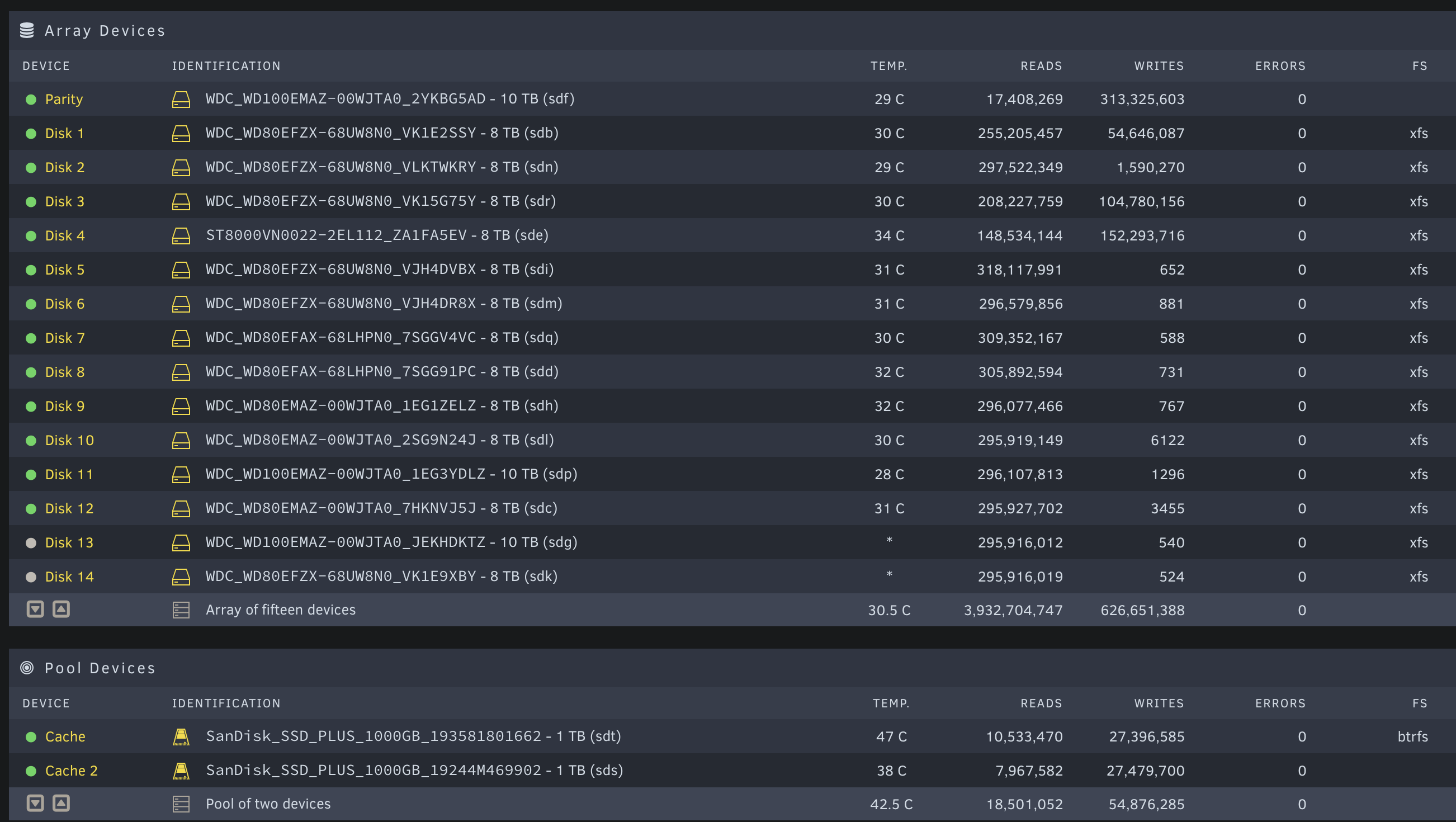

July 13, 20224 yr Hello All, I am hoping to get some help. I noticed that my cache was filling up and is being written to along with some disks on the array (see pic below) I checked the syslog and saw line below a lot; build_sam_account: smbpasswd database is corrupt! username root with uid 0 is not in unix passwd database! Does anyone know how to fix this? I am submitting a copy of the log file. I only have a few dockers, radarr, sonarr, tdarr, emby, nginx, mariadb, nextcloud and cloudflare. I just checked and don't have Ftp enabled nor do I have telnet enabled. I am submitting a copy of the diagnostics log file below. Thank you in advance. jiraiya-diagnostics-20220713-1036.zip
July 13, 20224 yr Community Expert Solution Do the recover password procedure, should fix that: https://wiki.unraid.net/Manual/Troubleshooting#Lost_root_Password
July 13, 20224 yr Author Thank you so much for the quick response JorgeB, I'll do that now and get back if I have a problem. Just out of curiosity though, any idea why I'm getting all those writes all of a sudden, is it the corrupt smbpasswd? Thanks Wil.
July 13, 20224 yr Community Expert Just now, gyrene2083 said: Just out of curiosity though, any idea why I'm getting all those writes all of a sudden, is it the corrupt smbpasswd? No, but since the above procedure deletes that file it should fix it.
