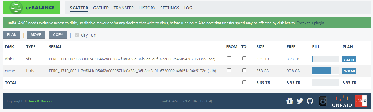

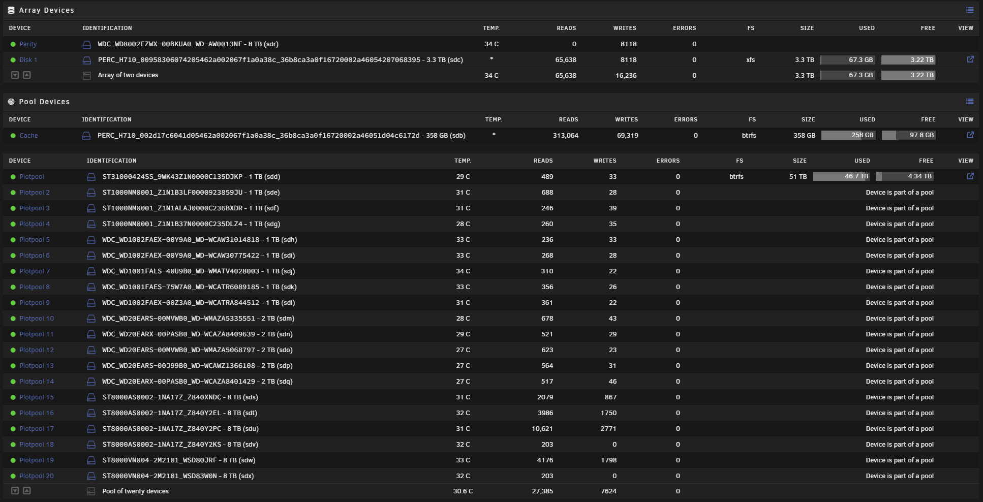

July 14, 20224 yr Author I'm just as confused as you.... not only that, ALL of my disk space isn't being used/seen... Here is what I see in the pool settings: Disk usage: I have 67TB worth of disk space but only 51TB is being utilized. That leads me to believe that SOMETHING is in Raid 1, which is hinted at within the pool settings. Thank you again for everyone's assistance. In a nutshell, I have hundreds of Chia plots that I'm hesitant to shuffle around. Regards, Chris R. *I have unBALANCE installed as well but doesn't show the pool disks when I go to the UI. Edited July 14, 20224 yr by Tymarand Added info
July 14, 20224 yr Author 15 hours ago, Arbadacarba said: Do you mean to say that you have a raid card with a raid0 configured? Or are you just assuming that the pool is raid 0? Yes to the first question, no to the second - Sorry for the confusion. I have a hardware RAID card in my R720 that I have used to create RAID 0 disks from the internal 2.5" disks... one is 3 x 120GB SSDs = 1 x 360GB and the rest of the drives are mashed together for another RAID 0 = 3.3TB All my other disks are housed in a NetApp DS4246... the parity disk and all of the pool disks In my screenshots above, you can see the labels for the PERC are the hardware RAID disks. Edited July 14, 20224 yr by Tymarand

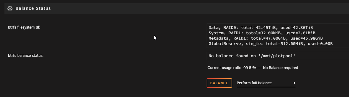

July 14, 20224 yr Community Expert 15 minutes ago, Tymarand said: That leads me to believe that SOMETHING is in Raid 1, which is hinted at within the pool settings. Data is in raid0, probably a btrfs issue, does not always calculate correct spaces for pools with different size devices, but all the space should be usable. 16 minutes ago, Tymarand said: In a nutshell, I have hundreds of Chia plots that I'm hesitant to shuffle around. Since Unraid supports a lot of pools I would recommend using smaller pools, i.e., I also do some "farming" and have for example 6x1TB, 5x2TB, 3x3TB, 2x8TB, etc, they all have a share called plots, so no need to add each pool separately to Chia and it's much easier to manage, also if there's a disk problem you only lose one pool.
