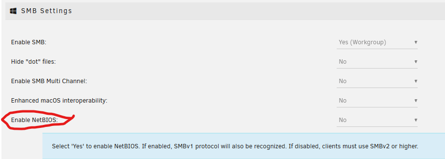

Are you using the SMB 'guest' mode to access your server?  IF you are make sure this setting is turned on:
Realize that there are serious security issues with SMBv1.  You should use it only if you have devices that can not use SMBv2 or higher...
Edited by Frank1940
