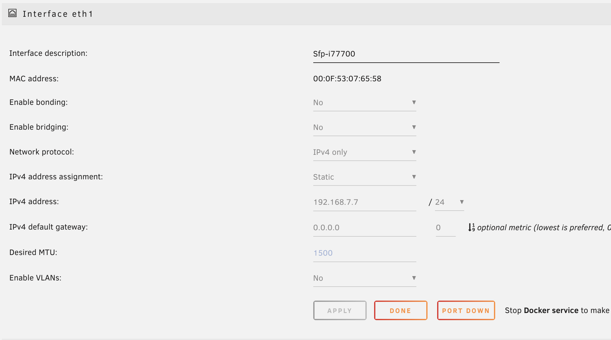

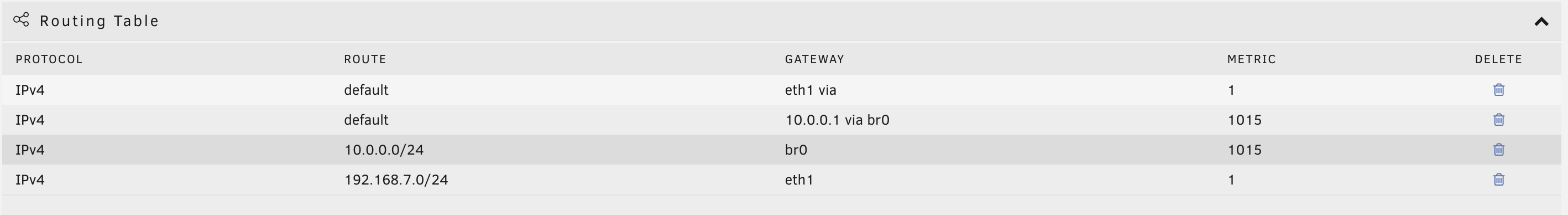

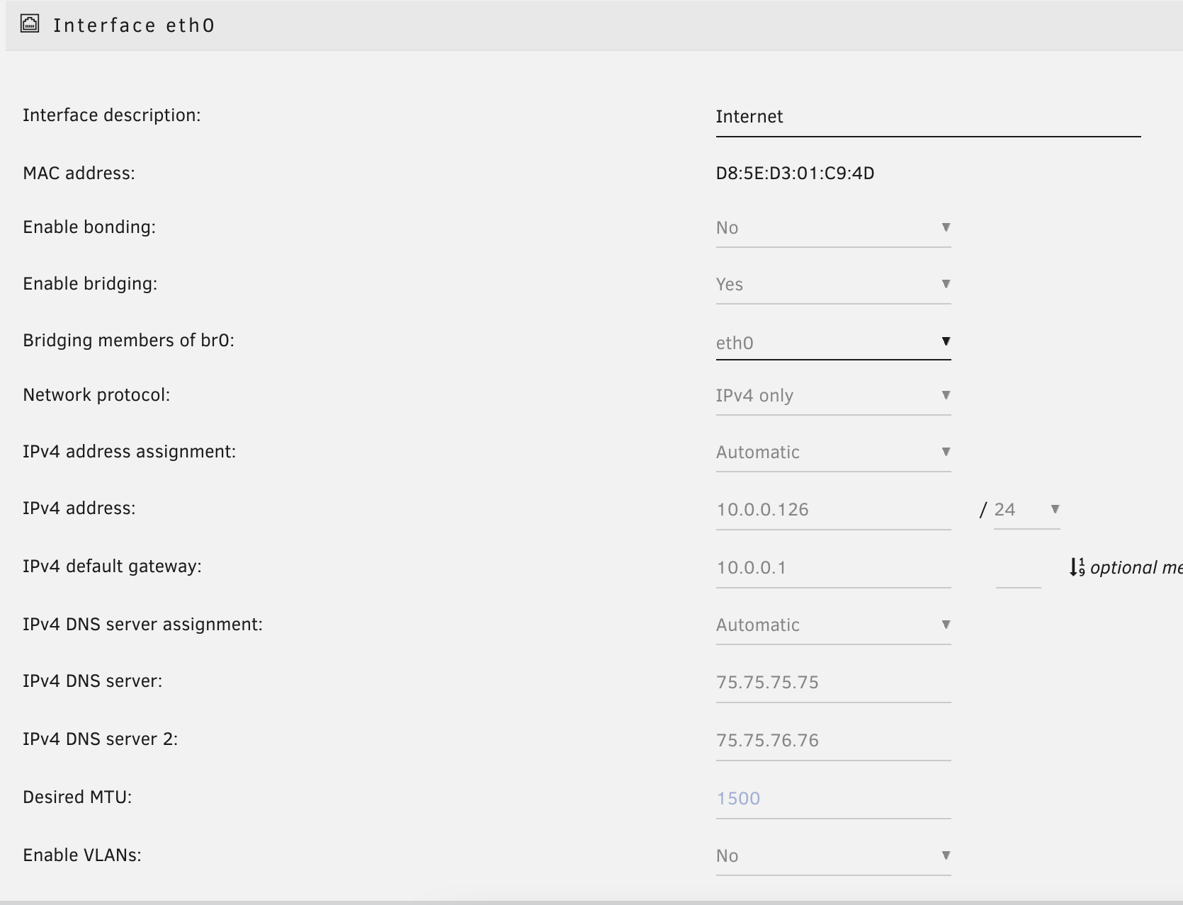

July 14, 20224 yr Hi, Some one please help me. Actually I'm not at all happy with unraid os (I bought pro by the reviews in google). I have one lan port on my motherboard and installed a network card (10 gbps sfp+). onboard lan port (eth0) connected to internet and my sfp+ to lan (to transfer the data from old truenas server). But the unraid os is using default gateway thru sfp+ port to connect to internet. I searched how to set the default port to use for internet. But no luck favoured. Can some one please help me.

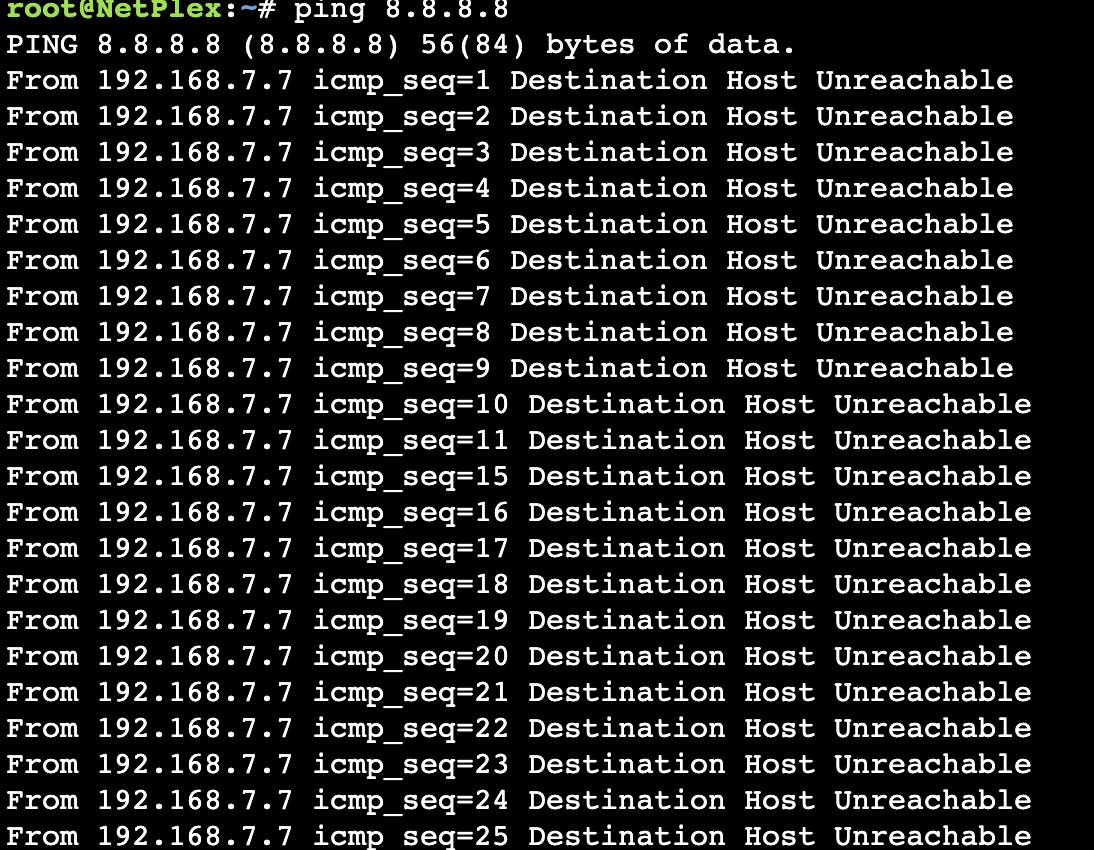

July 14, 20224 yr Author Thanks for the reply. Here which I don't understand is when do ping its trying to use eth1 (10G NIC). But I need to change to eth0 to connect to internet. How can I set it up.
July 15, 20224 yr 1) As said you need blank the gateway instead setting it to 0.0.0.0 2) My test as below, it is "from" 8.8.8.8 not like yours, I also make test by disconnect the cable and it won't route out to other port. The seq no. have interrupt. ( You also have interrupt that means some packet lost ) Edited July 15, 20224 yr by Vr2Io

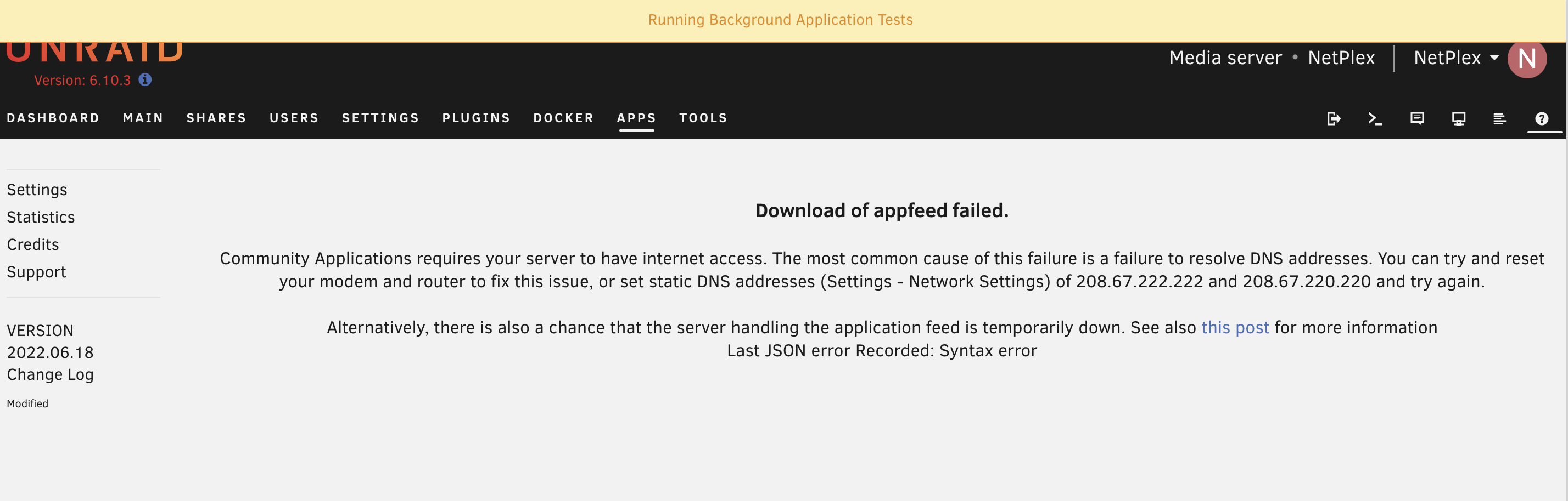

July 15, 20224 yr Author Thank you very much. Now I'm getting response from 8.8.8.8. But still I cannot access the apps.
July 15, 20224 yr 19 minutes ago, NetPlex said: But still I cannot access the app This usually mean access Internet fail, does Unraid plugin page success check have update or not. Seems some bug that Unraid will lost access Internet after network change, but it will resume when apply network setting again. i.e. clear some digit at IP then resum then apply. Edited July 15, 20224 yr by Vr2Io
