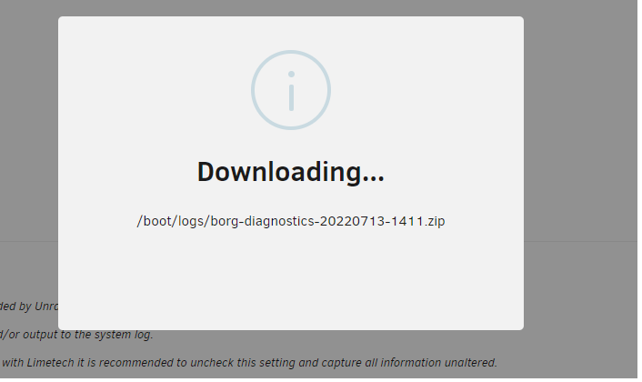

July 14, 20224 yr I have another ticket open : But I'm unable to download diagnostics. Any way to force the issue so I can submit the diag? Thanks.

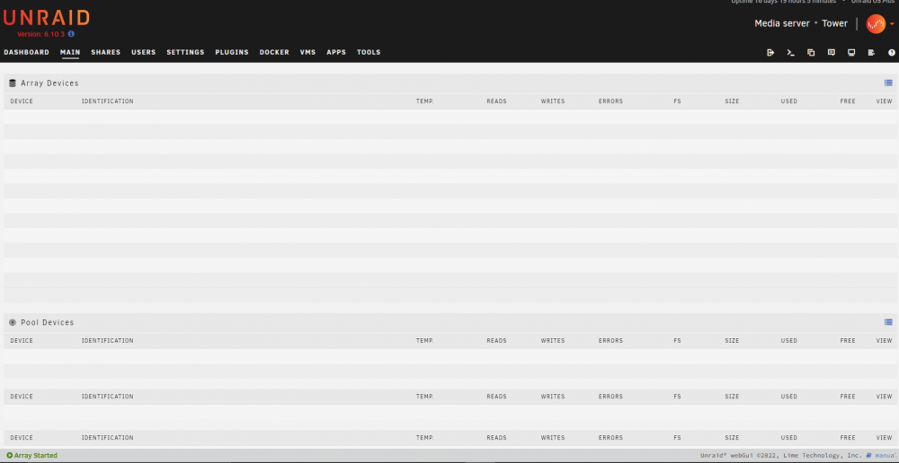

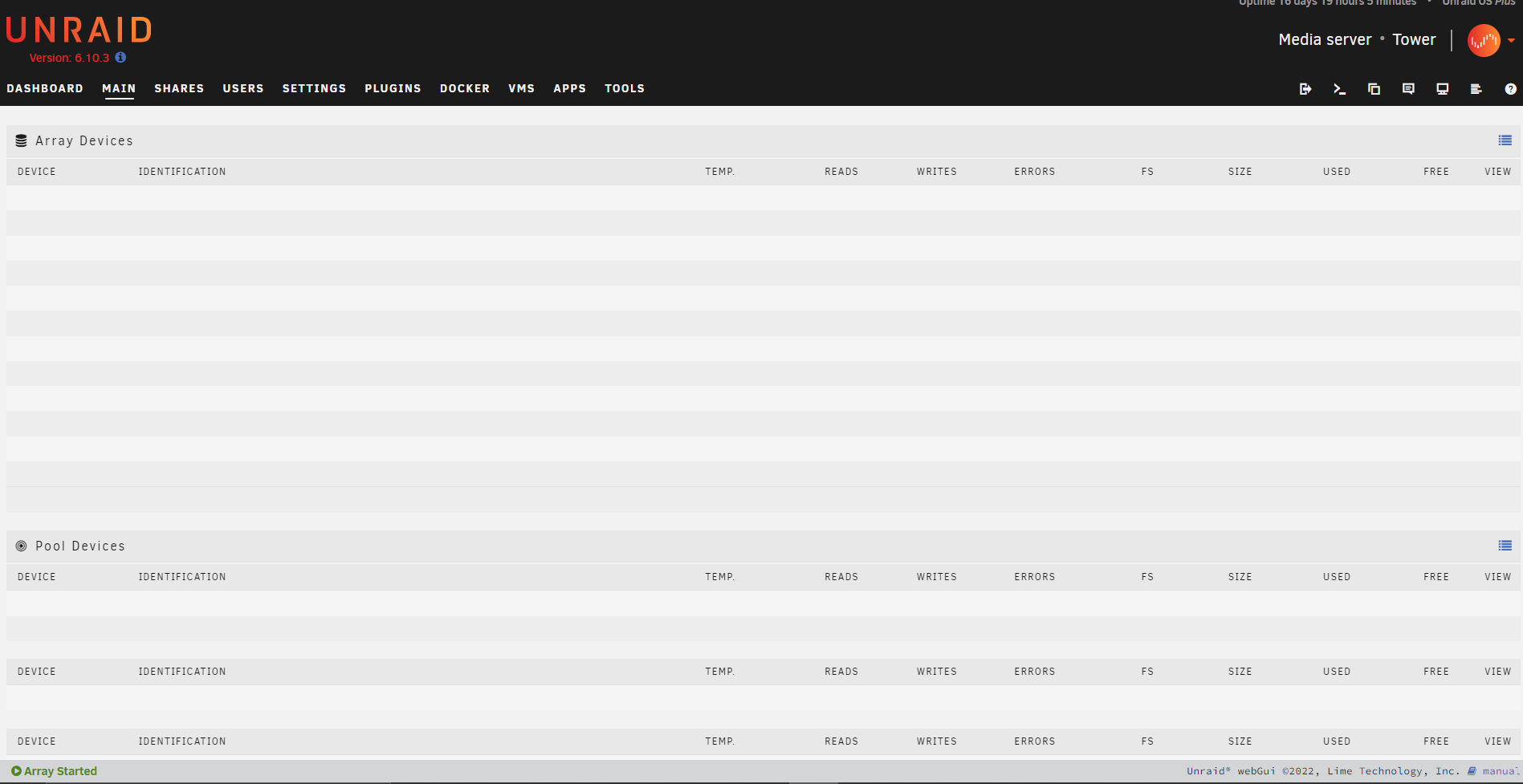

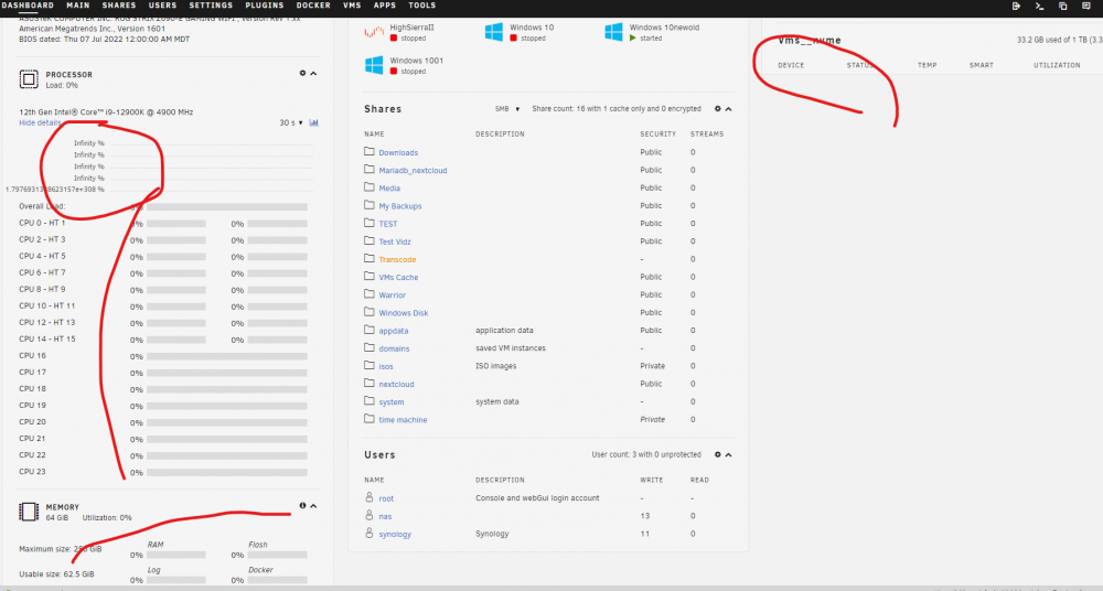

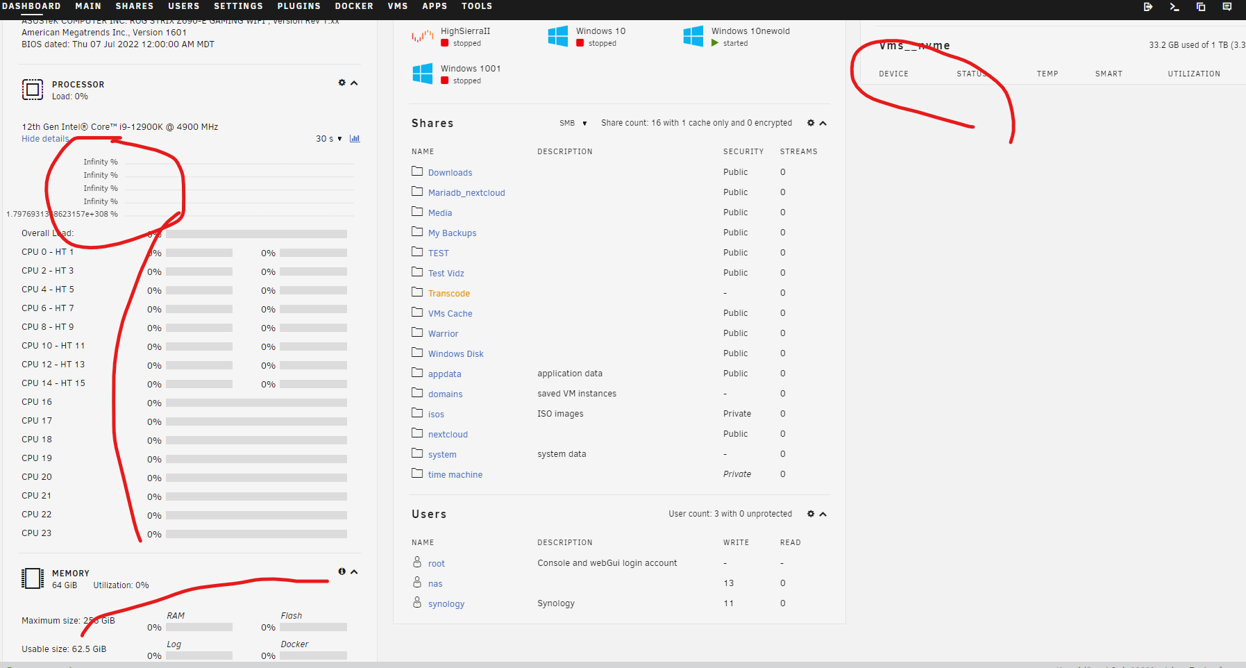

August 17, 20223 yr I cannot download diagnostics either. I am running a VM and I think Plex works, but the Main page doesn't display anything. The Dashboard displays infinite/null information.
August 18, 20223 yr There diagnostics should complete. Look on the flash drive in the /logs folder But, you probably anecdotally have a browser tab open on a mobile android device that you've completely forgotten about that is causing these issues. Close all tabs on all devices

August 21, 20223 yr On 8/18/2022 at 5:29 AM, Squid said: There diagnostics should complete. Look on the flash drive in the /logs folder It looks like you’re correct. They didn’t download from my browser but they did go to the flash. Thank you 🙏🏼 On 8/18/2022 at 9:40 AM, ljm42 said: I'm guessing you have the UD Preclear plugin installed? see https://forums.unraid.net/topic/112073-my-servers-releases/#comment-1154449 I believe this may have been the issue. Thank you for chiming in! Simple restart did the trick 🔌
