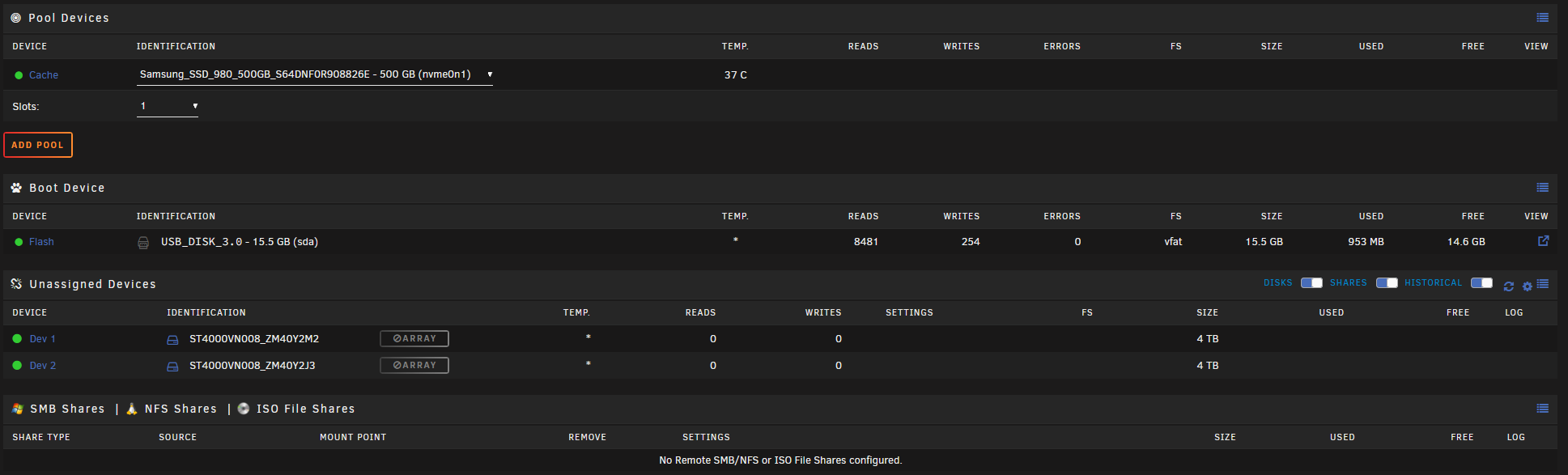

Two drives in "Unassigned Devices" that have "Array" grayed out
Hello there nice folks at Unraid.
I have a problem that started when I replaced one of my drives without removing the old one from the array first. I of course turned everything off and all, but I should have done things differently. But when I did that two drives started acting out and I couldn't mount them back on and they had errors and hazzle and xfs_repair did nothing. I suspect it was some kind of conflict from the other drive. After some googling I saw a post where someone just made a new config, figuring I didn't have anything to lose I just did it. That didn't really do anything so I'm going to you guys with this. I have diagnostics from after the new config, maybe that can shed some light?
Thank you so much guys.
cybertron-diagnostics-20220714-1804.zip
The gray 'Array' showing on the UD disks is because Unraid does not recognize them as Unassigned Disks.  Try clicking on the double arrows in the upper right of the UD page.  That will tell Unraid to re-evaluate Unassigned Disks.

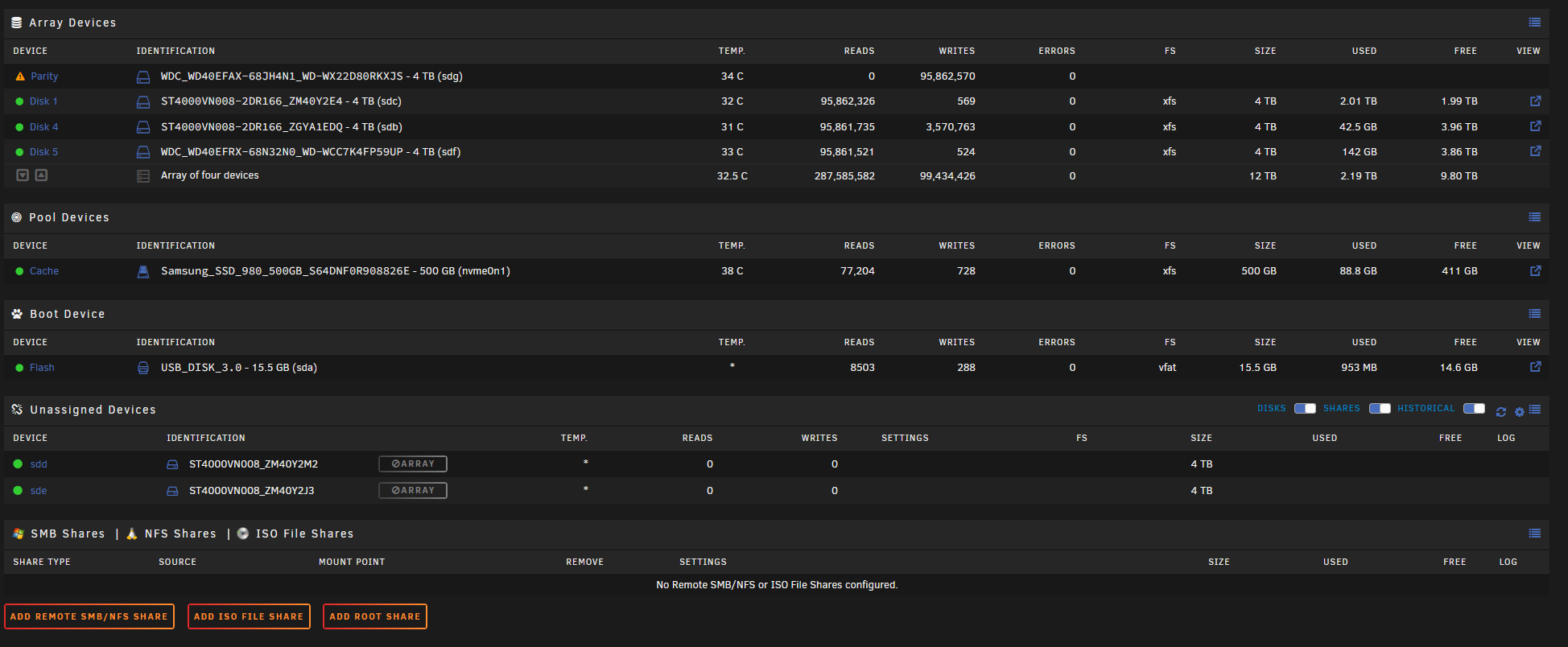

I tried to press the refresh arrows like you suggested but it only said "Success" but nothing happened.

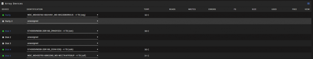

I just finished the parity check and I restarted the server (tried the arrow refresh thing again, still nothing). It booted up with the array offline and it looked like this:

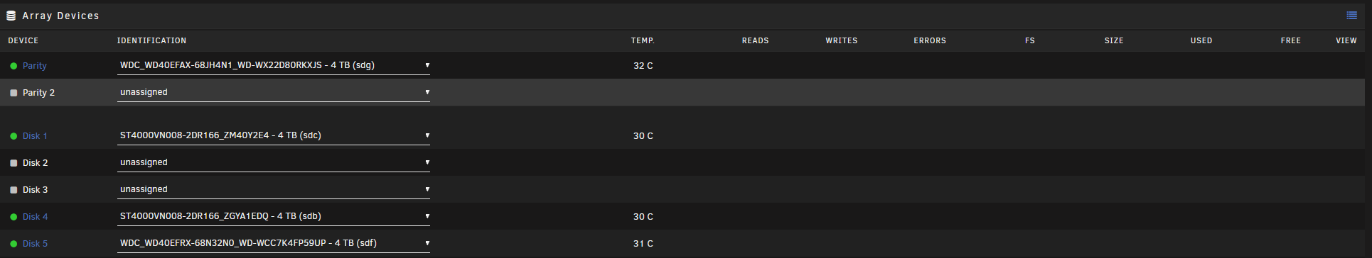

But when I tried to add them to the array they became like this again:
I checked the logs on the disks and this is what comes up on the top one:
