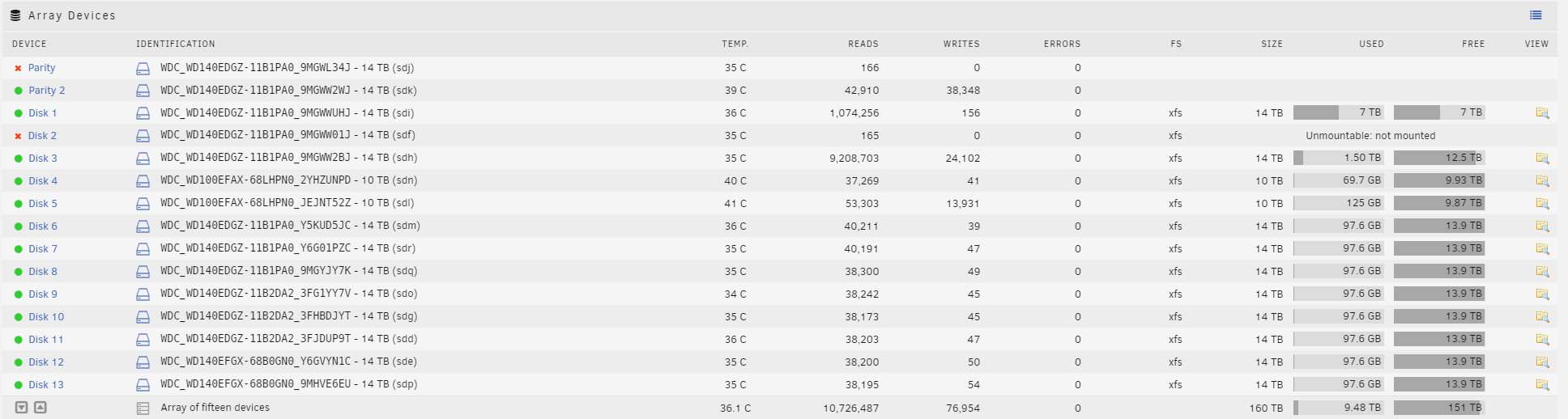

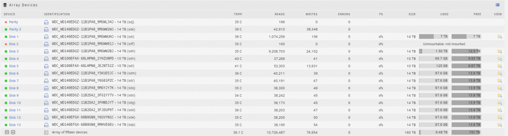

Never had any problems with my 6 month old server.  Today I lost 1 of the parity drives and Disk 2 (both 14tb).   I am copying all my files as we speak onto my 2nd unraid server.  There is a red X on parity 1, and disk 2 says Unmountable: not mounted
All of the drives were purchased in November/December 2021 - I don't know what happened.   I don't want to make the issue worse so i am asking for some assistance before i make a critical mistake.  Please let me know what to do next.
I have attached a screenshot of the drive array, not sure if this provides anything but let me know

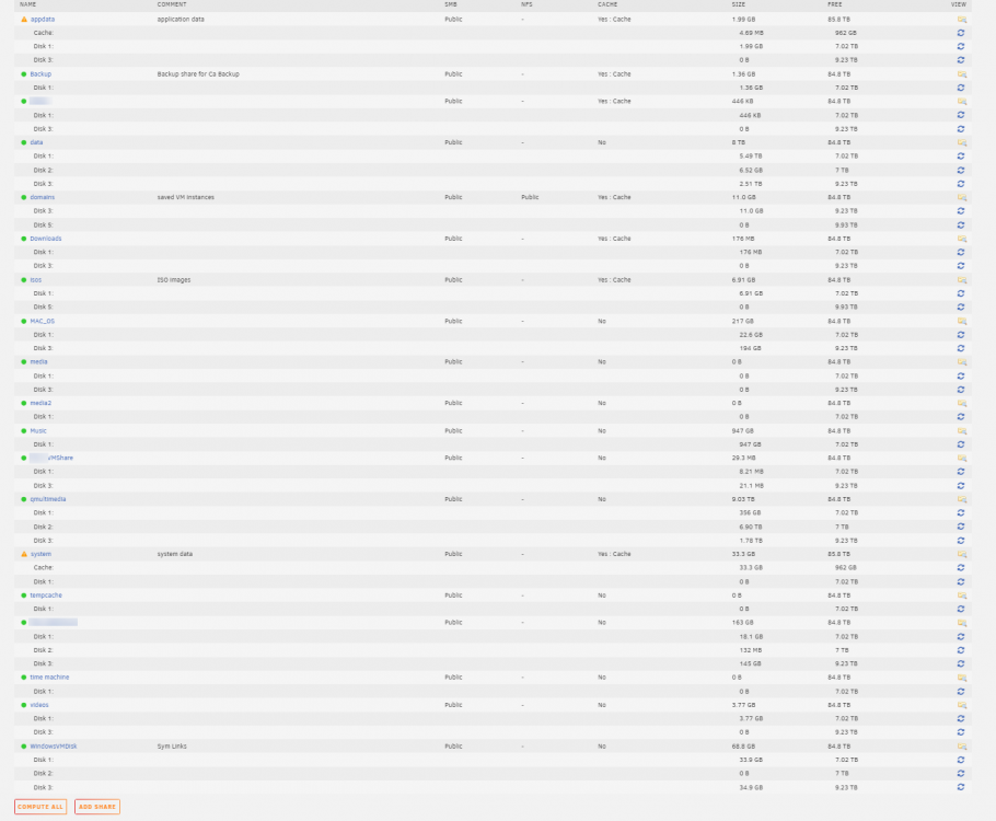

I'm just going to put a reminder here for some things we can look at later after you get your array fixed.
Why do you have 250G docker.img? Looks like 20G would be plenty for you. Have you had problems filling it?
And appdata, domains, system shares have files on the array.

You check the filesystem on the emulated disk2 just the same as you would if the drive were not missing/disabled/emulated.
Looks like it was already in that state when you booted. Physical disk2 SMART looks OK.

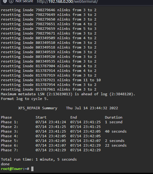

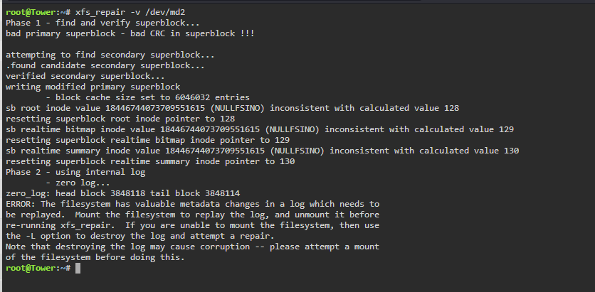

I did everything in disk filesystem.  stopped array.   Ran in Maint mode, xfs_repair -v  /dev/md2   (it ran and seems like it's ok) but disk2 is red X and 2nd parity is red X.   I still don't see all the data from disk2.   Do I spin it down (disk2) now???    All I have done is rebooted but disk2 is still not alive......   Not quite sure what to do.
Running an xfs_repair on the emulated disk2 will not remove the disabled (red ‘x’) state.   Disabled status can only be removed by doing a rebuild.   However it can clear a disk showing as unmountable.
You did not mention whether the xfs_repair output indicated errors or if completed successfully.   If not have you restarted the array in Normal mode and does the emulated disk2 now mount?   If so is there a lost+found folder on it and if so how much content?   Posting new diagnostics might be a good idea.
Here are some screenshots of what it said.  It seems like the repair was ok.  I will do new diagnostics also.   YES -- LOTS OF FILES / FOLDERS IN LOST+FOUND --  But can't I just rebuild from the Parity Disk 1 -    (there are 4252 items) -
I did what it said then ran it again and got the following at the end..

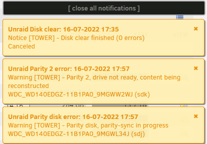

I stopped array again, changed the disk assignment from disk 2 (still empty there) and put it in disk 14.  It's a doing clean disk now.  Is that what I should have done?   I looked at the new config but i didnt want to cause a problem so i skipped that for now.   Please advise what i should do.  Been up for hours in the middle of night getting the files from lost+found so not thinking clearly at all.
No - what you have just done erases all its contents beyond any chance of revovery.
What was recommended was to instead try and mount it as an Unassigned Device as that might have mounted OK and you could then have copied files off it instead of trying to sort out the Lost+Found folder on the emulated disk.

I
I did do the unasssigned, see the previous message, but it wouldn't mount.  I clicked mount, it said mounting, but went right back to mount.
