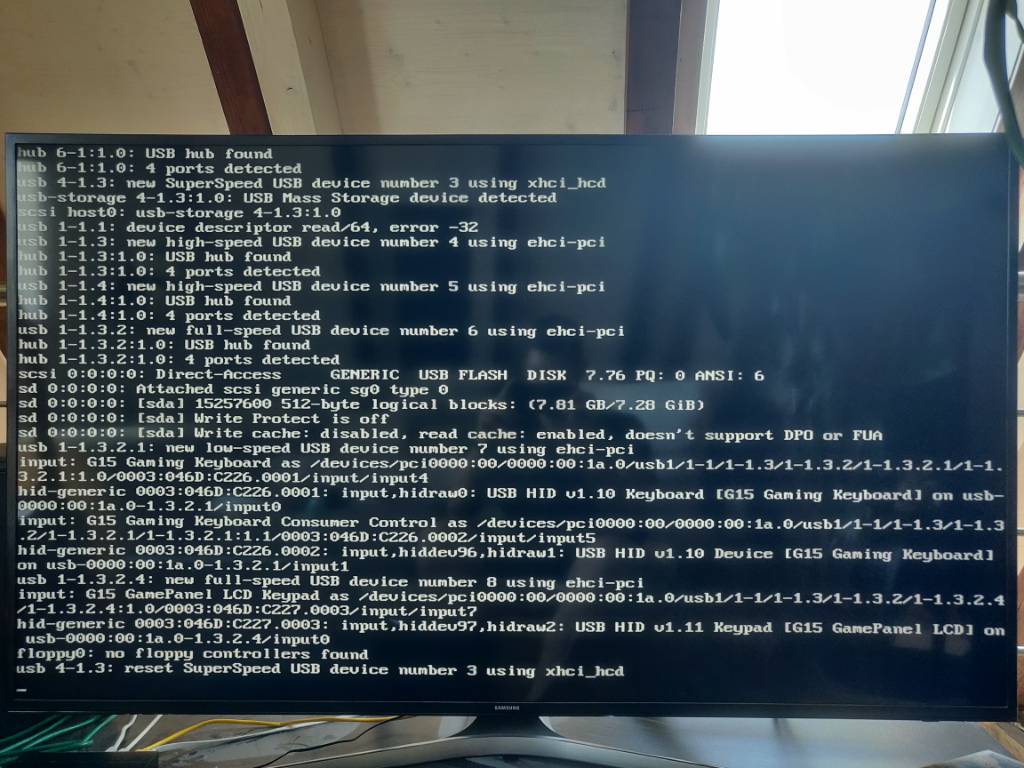

July 16, 20224 yr Hi!I am using an old Asus Maximus IV Board with an i5-3xxx and want to run Unraid on it. Unfortunately I cant get Unraid to fully start up. The machine always stops at the same point (See screenshot). The last line is always "usb 4-1.3: reset superspeed USB device... "I chose DHCP during creation of the USB drive, but I never detect the machine in the network.Whats rrally weird, is that of I disconnect and reconnect the keyboard, it is detected and new text appears on the screen. But even after that no WebUI available.What can I do to trouble shoot this? Thanks in advance! Heiko PS I had OpenMediaVault running in this machine before and everything worked... Gesendet von meinem ONEPLUS A6003 mit Tapatalk
July 16, 20224 yr Are you using a USB hub or is everything connected to the motherboard. You want the boot device connected to the board, not via a hub
July 16, 20224 yr Author Hi @Squid,I tried almost every USB-Port and I 'm not using a hub.I also disconnected everything else including harddisks except the hdmi cable and the keyboard.
July 17, 20224 yr Look like you use a USB3 stick on USB3, but it identify in generic ( this may BIOS realate ). Anyway what is brand model of that stick ? Officially approve ? Could you simple try other USB stick to check does booting success first.
July 17, 20224 yr Author I'll try another stick. The one I'm using is an Intenso Slimline 8GB. https://www.intenso.de/en/products/usb-sticks/slim-line
July 17, 20224 yr Author Okay, so I tried a couple of things. When I use another stick (Sandisk Ultra), Unraid will boot. I was even able to boot from the Intenso-stick and when it stops loading swap the stick out with the Sandisk and it would continue to load and start Unraid. Is there any way the get the Intenso Stick to work? I bought it because it is so small and will just disappear in the back IO panel. The other Problem is, that I used the Sandisk before and can't use it for trial purposes any more... (You have reached your limit on trial extensions, please consider purchasing a license)

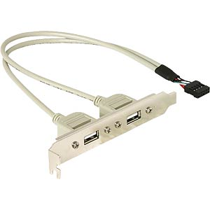

July 21, 20224 yr Author I just ended using another stick I had laying around and attached it to an internal usb via on of these PCI-slot brackets that I just leave laying around in the case for the moment. Thanks for the help though, I would have never blamed it on the stick 😅
