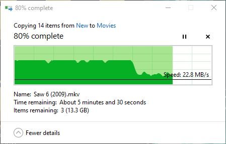

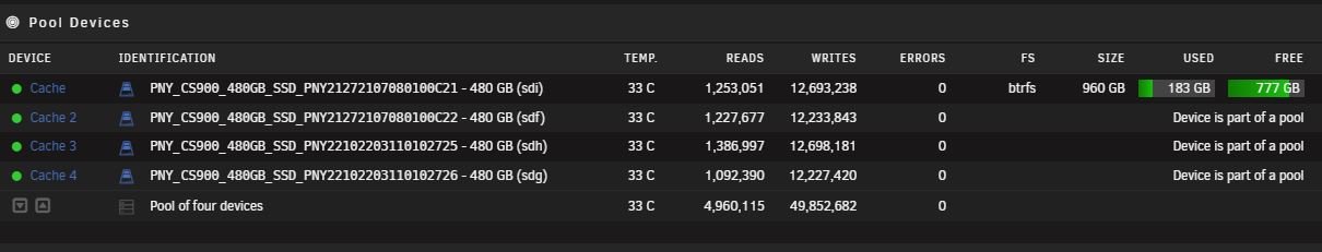

I originally had 2 SSDs in RAID 0 for my Cache pool.  When the drives went on sale I decided to get two more and change the pool to RAID 10.  Ever since it has been exhibiting some strange write performance issues.  It starts writing just fine at 110-120 MB/s (limited by my network speed).  However, after a few GB are copied the speed drops to between 20-40 MB/s.  This never happened while I was using RAID 0 and can't for the life of me understand why it would start behaving this way now.  Is this an odd limitation of the btrfs file system?

Docker and VM Manager were disabled at the time. That's not really the issue though as I was able to recover all of that from backup.  Everything is back up and appears to be running normally but this weird issue writing to the cache drive is a bit annoying.
