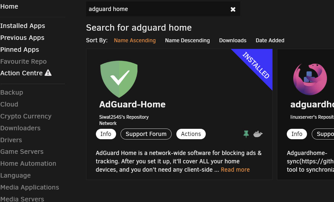

July 17, 20224 yr I am planning on installing AdGuard Home on my unraid server. There is an 'official' docker container but when I search from within Unraid I am shown a version from a repository I have never heard of. How do I get the official one? How do I know that the results I get are 'safe'?
July 17, 20224 yr 5 hours ago, MacOwens said: How do I get the official one? Im using this, and its official

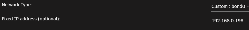

February 21, 20242 yr On 7/17/2022 at 8:09 PM, Masterwishx said: Im using this, and its official Hi, it shows popup that needs custom network. Can You tell me something what custom network I need to install that container?
February 22, 20242 yr 21 hours ago, MarianKoniuszko said: Hi, it shows popup that needs custom network. Can You tell me something what custom network I need to install that container? using bond0 ,if you have eth0 or br0 use them and fixed ip

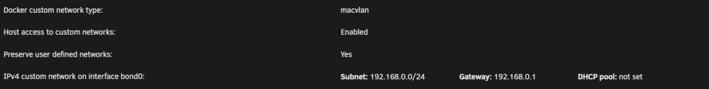

February 22, 20242 yr 10 minutes ago, MarianKoniuszko said: There's only `bridge` or `host` network to choose. check your docker settings : Host access to custom networks = Enabled ? Edited February 22, 20242 yr by Masterwishx
February 22, 20242 yr 28 minutes ago, Masterwishx said: check your docker settings : Host access to custom networks = Enabled ? Thank You. I have now custom: br0. What is fixed IP?
February 24, 20242 yr On 2/22/2024 at 9:57 PM, MarianKoniuszko said: What is fixed IP? its you static IP you want for the container ( 192.168.0.198 for example)

February 28, 20242 yr 2 minutes ago, MarianKoniuszko said: But on first steps after install I noticed that it show me as my main address 192.168.0.2. I have now 192.168.0.1 for my router so I remember few Years ago it broke everything because my router site stop working and all my port forwarding also. So I will not risk that again. Regards. Sure , its your choice . i have no problem at all , also have 192.168.0.1 for my router ,192.168.0.199 for unraid , and 192.168.0.198 for adguard its where you set fixed ip

March 1, 20242 yr On 2/28/2024 at 9:56 PM, MarianKoniuszko said: Can You tell me how can I make static IP in router? I have TP-Link Archer x72 router and when I want to set static IP I have to give Adguard IP and MAC. Is there MAC for Adguard? No Need to set up it in router , just setup the Fixed IP for Adguard in Unraid it will be OK.
