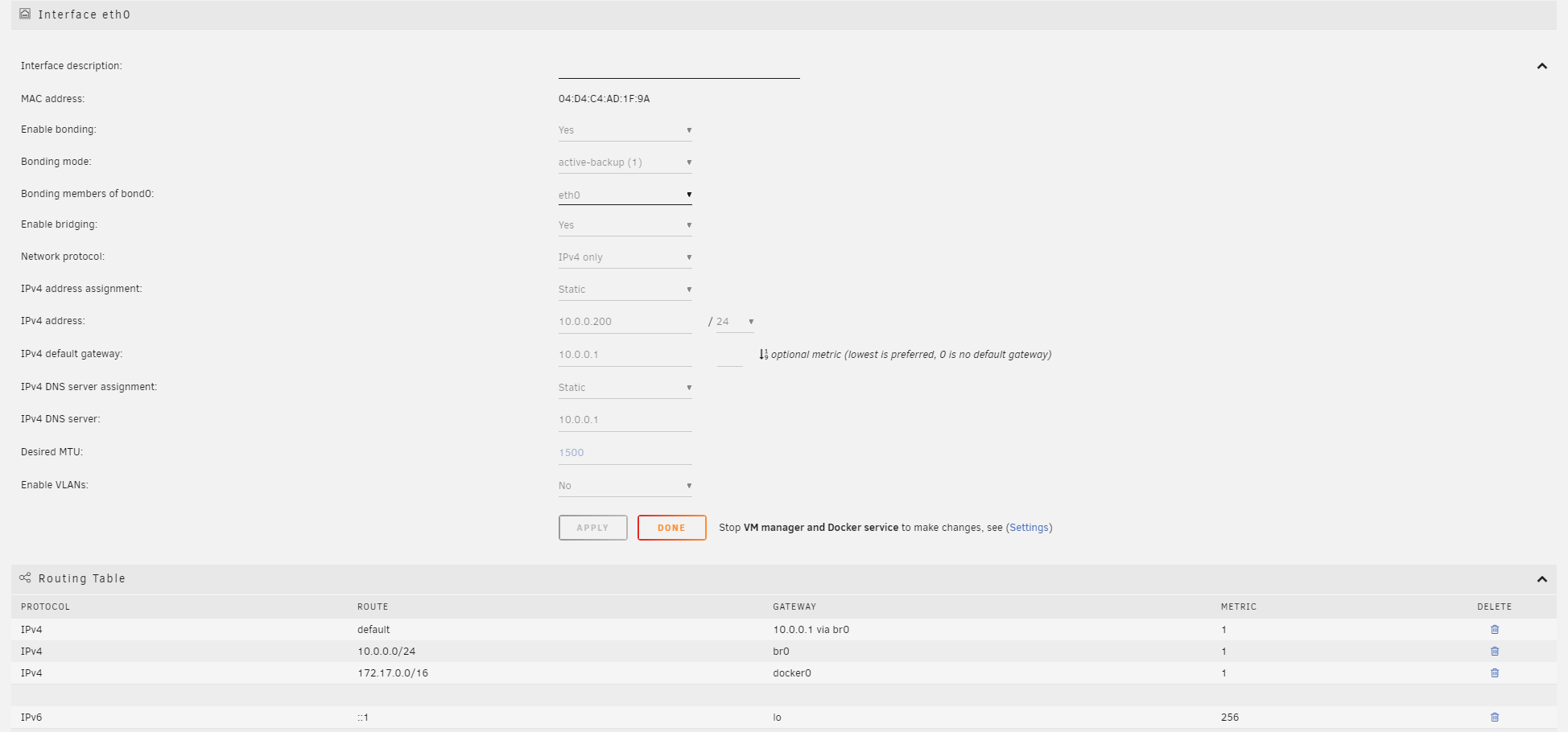

I have recently setup a new router with a new IP address range (10.0.0.0/24), I can connect to any docker services when I have no VM's running but as soon as i start a VM i can no longer connect to the service running inside the docker container.
Can someone please assist? I can't see anything that is misconfigured in the IP tables or Network settings. I have not been sucessfull in finding a solution on Google.

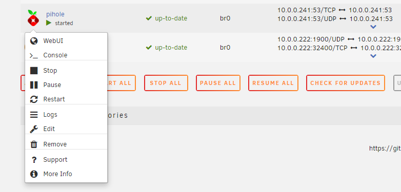

If i try and connect to the  docker service via WebUI it times out.
But as soon as i stop the  VM i can access the docker service.

Thanks for the suggestions. I deleted /boot/config/network.cfg and restarted and the issue has been resolved.
