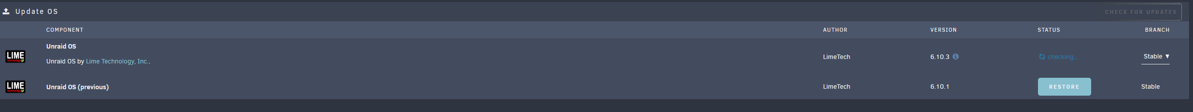

So I reverted to 6.10.1 which is what I am running now.

P.S. you should update to latest stable, v6.10.3

Thanks, I appreciate that and have followed your instructions I will post back should the issue re-arise. Also regarding updating to 10.6.3 I AM on 10.6.3 stable already.
