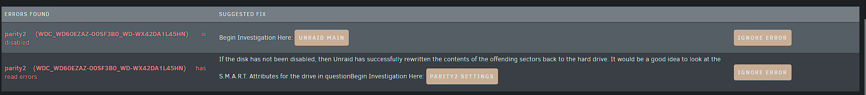

Fix Common problems states that they are Read Errors, however my syslog shows a wall of the following write errors before the drive is disabled:
kernel: md: disk29 write error, sector=XXXXXXX

(photo of my "Fix Common Problems" report:)
