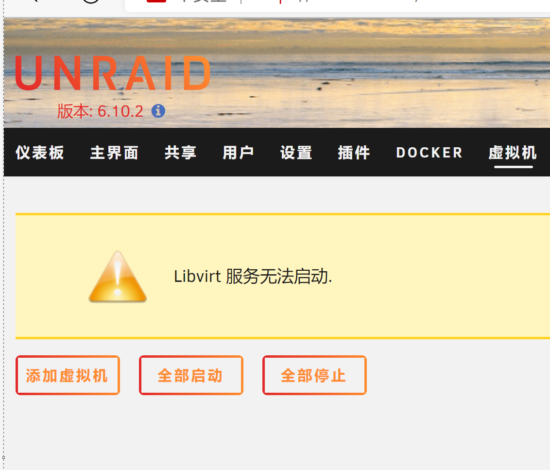

I got a issue that vm crash and no reponse for everything. At this moment, I can't open the unraid webui --> VM, no response for the browser.
Other papge is OK at the same time. So I go to setting and stop the VM function. And then, I start VM function again. But I can't manager the VM in the webui which show as the screenshop. Libvrit service can't start. The only way to fix is reboot the unraid.
What's the problem? How can I fixup without reboot the whole server.
I try to restart the libvirt but fail.
