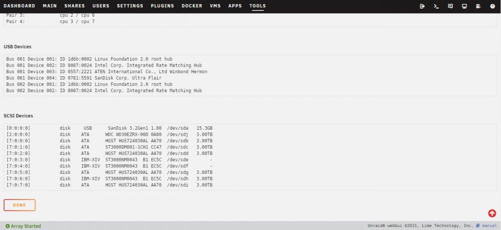

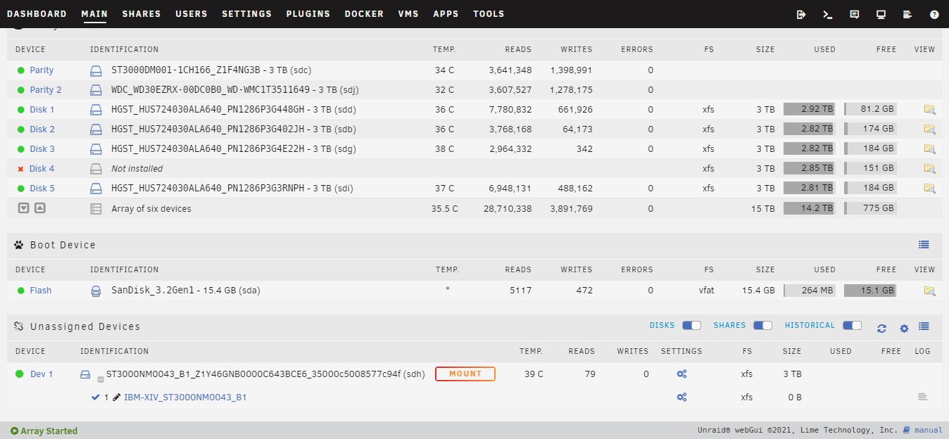

I have an Unraid Server, its running out of space, bought some new drives, installed the drives and hooked them up, but only one drive is recognized by the Unraid Server at all? and even then I try to mount the drive but it wont let me, even though the drive came out with zero errors. Luckily the Drives are recognized by the system, and that leaves me to here. I am lost and confused please Help!

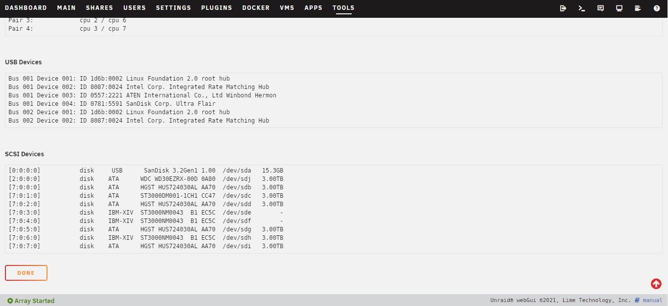

I provided some screenshots of the drives
The Drives with the "IBM-XIV" are the unrecognized ones
Do you mean you are trying to mount the drive as an Unassigned Device? Has the drive been formatted with a filesystem Unassigned Devices can mount?
No SMART report for these in diagnostics. What kind of disks are these? How are they attached?
Yes like new disks? I hope that makes sense... my "missing disk" was an old disk that had hella errors but was unmountable so I took it out
My main problem is that the "IBM-XIV" disks wont show up in the unassigned disk area, and I cant use them...
Also one of the drives that are in the unassigned area doesn't want to mount... so I'm pretty confused
You should shrink the array by doing New Config without that disk and rebuilding both parity. You currently already have a failed disk as far as the array is concerned so you have already used up the protection of one parity.
Or if you can get those other disks recognized you could use one of them to replace/rebuild that missing slot.
Either way, you need to do something about it. Doesn't matter at all if there was nothing on the drive, it is still a missing drive as far as parity is concerned until you either rebuild the missing drive or rebuild parity.
