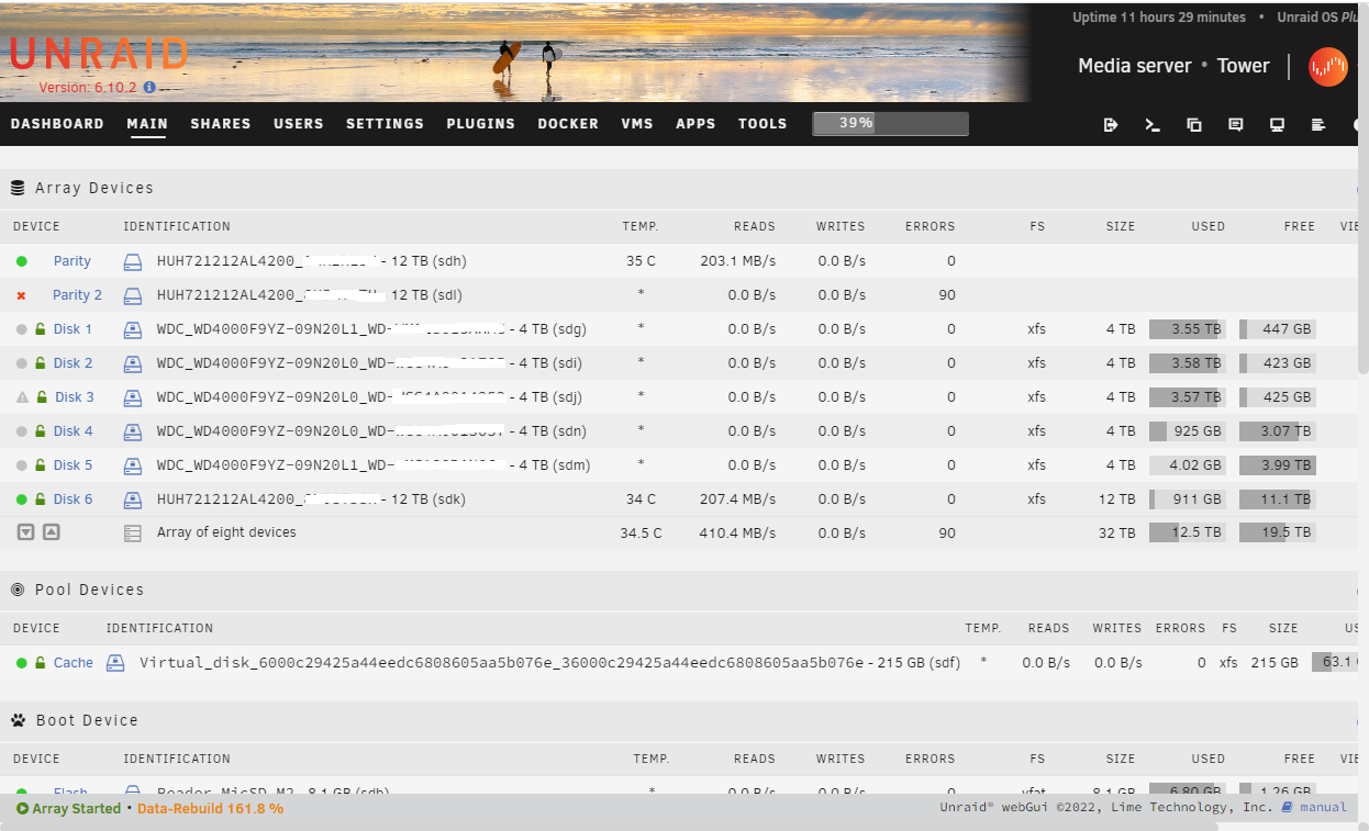

Post a screenshot of Main - Array Devices.
13 minutes ago, trurl said:
Diagnostics just shows it invalid, not disabled. It will be invalid until rebuild finishes.
D3 is the one that's invalid (as you say, this is expected). Q is disabled (DISK_DSBL).
Here. Thanks.

Just above the View column is a toggle to switch from write speed to total writes. I never care about speed so always leave that the other way. Wonder what yours shows if you toggle it.
