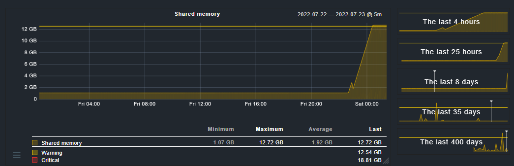

July 23, 20224 yr Hello y'all, My monitoring tools started showing my Unraid server was using a lot of shared memory. Here is the chart from the last 24 hours (with the server mostly idling): So, I did a little bit of search on the web and tried the following: root@server:~# free -m total used free shared buff/cache available Mem: 64191 30582 18970 13022 14638 19920 Swap: 0 0 0 root@server:~# ipcs -m ------ Shared Memory Segments -------- key shmid owner perms bytes nattch status Not much to see here, except I do see there are indeed 12+ GB worth of shared memory. I then stumbled upon the following post (https://stackoverflow.com/a/40712727/1689179) and script: cd /proc for i in `ls -d * | grep -v self` do if [[ -f $i/statm ]];then echo -n "$i "; cat $i/statm | perl -lan -e 'print ($F[2] * 4096)'; fi done | sort -nr -k2 | head I got the following results: root@server:~# sh test 1034 49528832 19397 30261248 2919 29437952 1445 26116096 1062 24440832 5986 23838720 5598 23777280 5807 23760896 6567 23732224 6266 23629824 root@server:~# ps -p 1034 -p 19397 -p 2919 -p 25669 -p 1062 -p 5986 -p 5598 -p 5807 -p 6567 -p 6266 PID TTY TIME CMD 1034 ? 03:52:53 dockerd 1062 ? 01:44:31 containerd 2919 ? 00:08:48 mono-sgen 5598 ? 04:03:06 qemu-system-x86 5807 ? 15:12:03 qemu-system-x86 5986 ? 15:52:44 qemu-system-x86 6266 ? 2-19:39:15 qemu-system-x86 6567 ? 04:24:21 qemu-system-x86 19397 ? 00:41:01 Plex Media Serv So dockerd/containerd and qemu. I don't see anything relevant in the logs... what could have triggered the sudden raise of shared memory usage?
