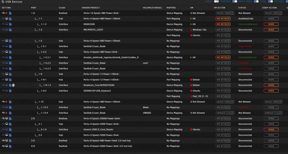

I 've just ckeck the box where the conbee is displayed...
I can see my conbee in my vm, but I can' t use it.
3 minutes ago, Auden69 said:
Unraid 6.10.3
You have to map as a serial port which cannot be done from the template. You have to edit the xml have a look a this thread. I have added support to my usb manage plugin for serial mapping.
Edited by SimonF

Bus 001 Device 001 Port 1-0	  ID 1d6b:0002 Linux Foundation 2.0 root hub
Bus 001 Device 002 Port 1-3	  ID ffff:5678 USB Disk 2.0
Bus 001 Device 003 Port 1-11	  ID 0403:6001 Future Technology Devices International, Ltd FT232 Serial (UART) IC
Bus 001 Device 118 Port 1-12	  ID 1cf1:0030 Dresden Elektronik ZigBee gateway [ConBee II]
Bus 002 Device 001 Port 2-0	  ID 1d6b:0003 Linux Foundation 3.0 root hub
Device 118 ??? It's not a problem ?

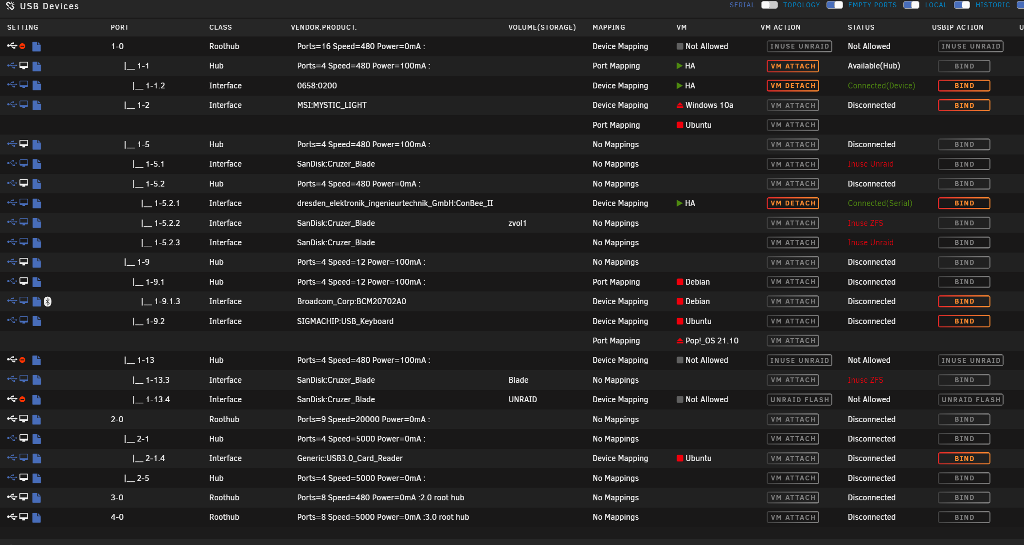

EDIT : Oups I forgot Unckeck the device... I can see the lines now. I 'm still testing...
Edited by Auden69
Finally, i found "dev/serial/by-id/usb-QEMU_QEMU_USB_SERIAL_1-0000:00:07.7-4-if00-port0" in HA hardware page
So in my z2m(docker) configuration file i put  :
