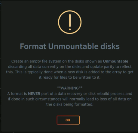

July 24, 20224 yr Community Expert 2 hours ago, David13858 said: seen some suggestions online about moving it to unassigned devices and formatting then moving it back to the array for a rebuild Where did you see that? Everything about that is wrong. Absolutely no point in formatting a drive that is going to be used for rebuild since the entire disk is going to be overwritten regardless of whether it is empty, full, or even never formatted. And rebuilding won't fix unmountable anyway. And even more dangerous is mentioning format in any discussion regarding unmountable filesystem except to strongly warn a user against doing that, since that is how many people make a critical mistake that makes it impossible to recover their data. Format is a write operation. It writes an empty filesystem to the disk. If you format a disk in the array, Unraid treats that write just as it does any other, by updating parity. So after formatting a disk in the array, rebuilding will result in that empty filesystem. So now that I have taken the time to hopefully prevent you from doing something terribly wrong, I will look at your diagnostics.

July 24, 20224 yr Author 2 hours ago, ChatNoir said: I've cleaned that up, please only post the zip file. My Apologies, I dragged the zip file across so I must have pressed the wrong button to split them up. It was on reddit so not the most reliable "i dont know if there is an easier way to recovery but what i would do is remove the drive from the array, format it with the unassigned devices plugin and add it back to the array to rebuild the parity. beside this i would recommend getting a UPS so a power loss does not knock out your server anymore." I was 50/50 on the format so you have definitely stopped me from that mistake. Oh ok, this was the first time I had ever looked at the sys logs, I will setup persistent logs to avoid that error next time. Yes, there are a few smart errors on some disks [8, 9, 12, 20, 21] (This is the spreadsheet I have to keep on top of things) I will check the filesystem and get back with the results tomorrow. I was having some issues with docker filling up quickly, I was pressed for time fixing the issue so I had to quickly bump it to 50g to keep everything working but then never set it back to 20 since it was working ok. Primarily cost at the moment, the important data I have is backed up a second PC so I didn't think it was essential to do it but It is on my list of jobs (as well as a UPS) I ended up getting disks 12-19 free all at the same time and I was already set up for 24 drives so I couldn't pass up the opportunity. My plan is too slowly phase them out. I just moved disk 20 from the parity slot and replaced it with a new drive, I was hoping it would last a bit longer before filling up. The next plan is disk 21 getting the boot.
July 24, 20224 yr Community Expert 20 minutes ago, David13858 said: "i dont know if there is an easier way to recovery but what i would do is remove the drive from the array, format it with the unassigned devices plugin and add it back to the array to rebuild the parity. beside this i would recommend getting a UPS so a power loss does not knock out your server anymore." Wow! Everything about that is wrong. And they say "rebuild the parity" when what they apparently mean is rebuild the data disk from parity. Fuzzy language often is a sign of fuzzy thinking. 26 minutes ago, David13858 said: a few smart errors on some disks [8, 9, 12, 20, 21] 27 minutes ago, David13858 said: disks 12-19 free all at the same time Do you have Notifications setup to alert you immediately by email or other agent as soon as a problem is detected? Those disks don't look terrible, though one does have a pending sector. After you get disk20 taken care of you might consider an extended self-test on all of them. You will have to disable spindown on the disk to get the test to complete. 40 minutes ago, David13858 said: I just moved disk 20 from the parity slot and replaced it with a new drive, I was hoping it would last a bit longer before filling up. The next plan is disk 21 getting the boot. Could you clarify this? Especially since disk20 is the one currently unmountable. Do you mean you replaced parity with a new disk, and used the previous parity as disk20?

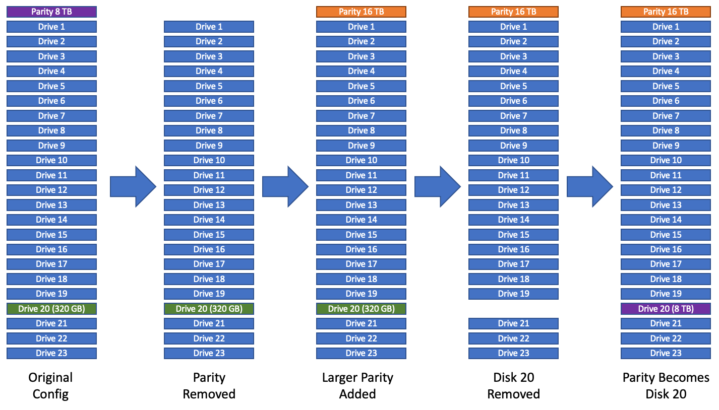

July 25, 20224 yr Community Expert 31 minutes ago, David13858 said: Disk20 used to be the parity drive. So when the 16 TB drive came, I took Disk 20 (6ZL) out of the array and re-built the parity to the 16 TB (DM7). Then formatted Disk 20 and added it to the array as a normal drive. This does not sound possible as you can never have an array drive that is bigger than either of the parity drives. I’m still confused
July 25, 20224 yr Author 1 minute ago, itimpi said: This does not sound possible as you can never have an array drive that is bigger than either of the parity drives. I’m still confused Sorry, this is my terrible explanation skills. (Disk 20 = Drive 6ZL) Previously: Parity = Drive 6ZL (8 TB) Array = Drive 1 to 23 (Maximum Size 8TB) Current: Parity = Drive DM7 (16 TB) Array = Drive 1 to 23 (Maximum Size 8 TB) In the array Disk 20 is now Drive 6ZL (The drive that previously occupied that spot was removed) Hopefully that sounds a little less cryptic.
July 26, 20224 yr Community Expert You replaced parity with a larger disk and let parity rebuild. Then you used the former parity disk to replace disk20 and let it rebuild. Is that correct? Or did you do something different?
