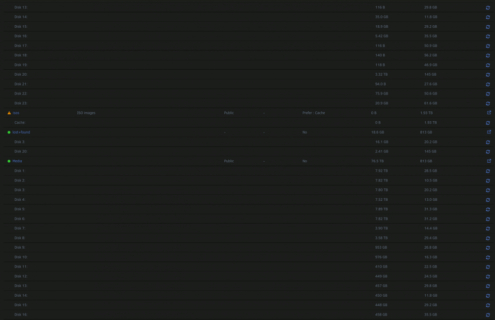

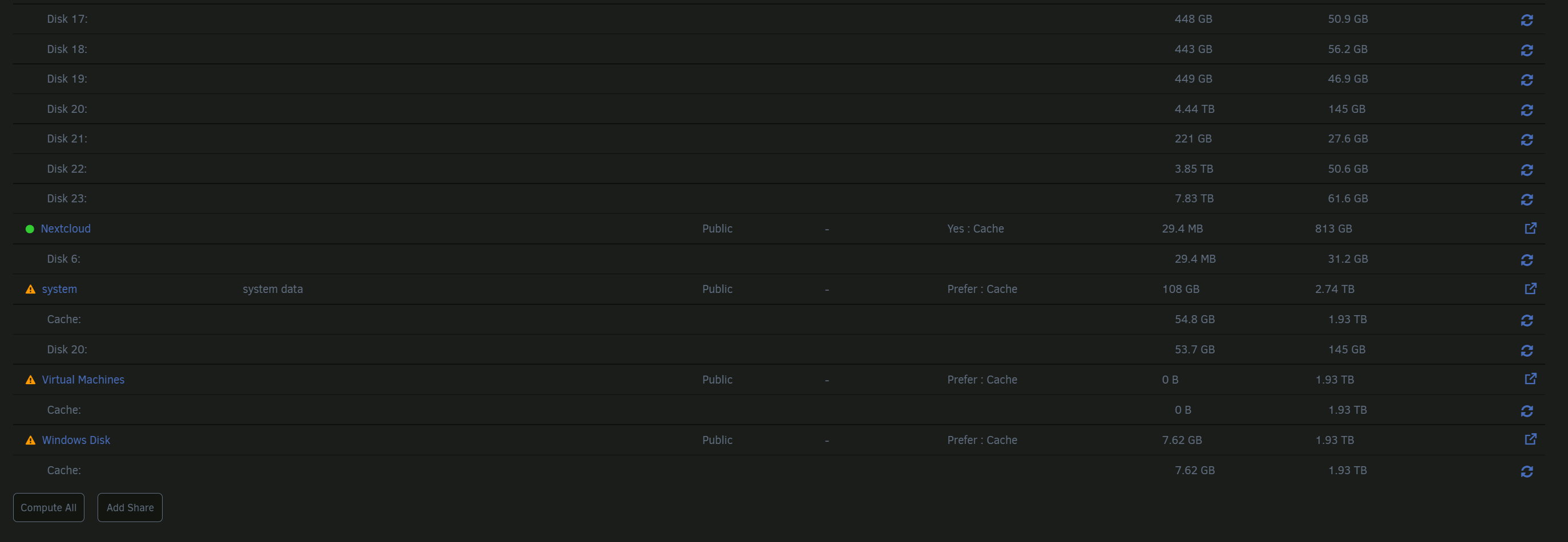

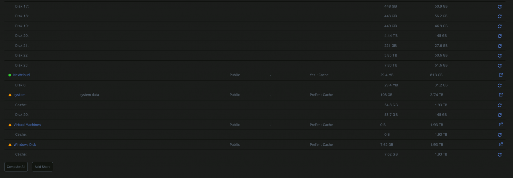

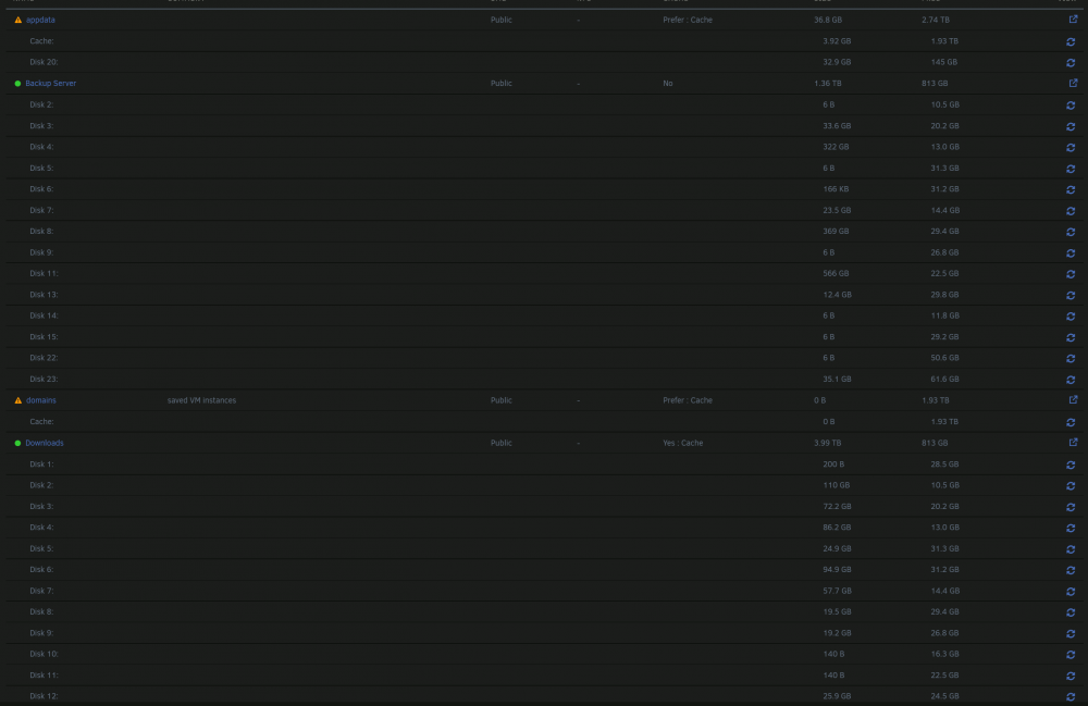

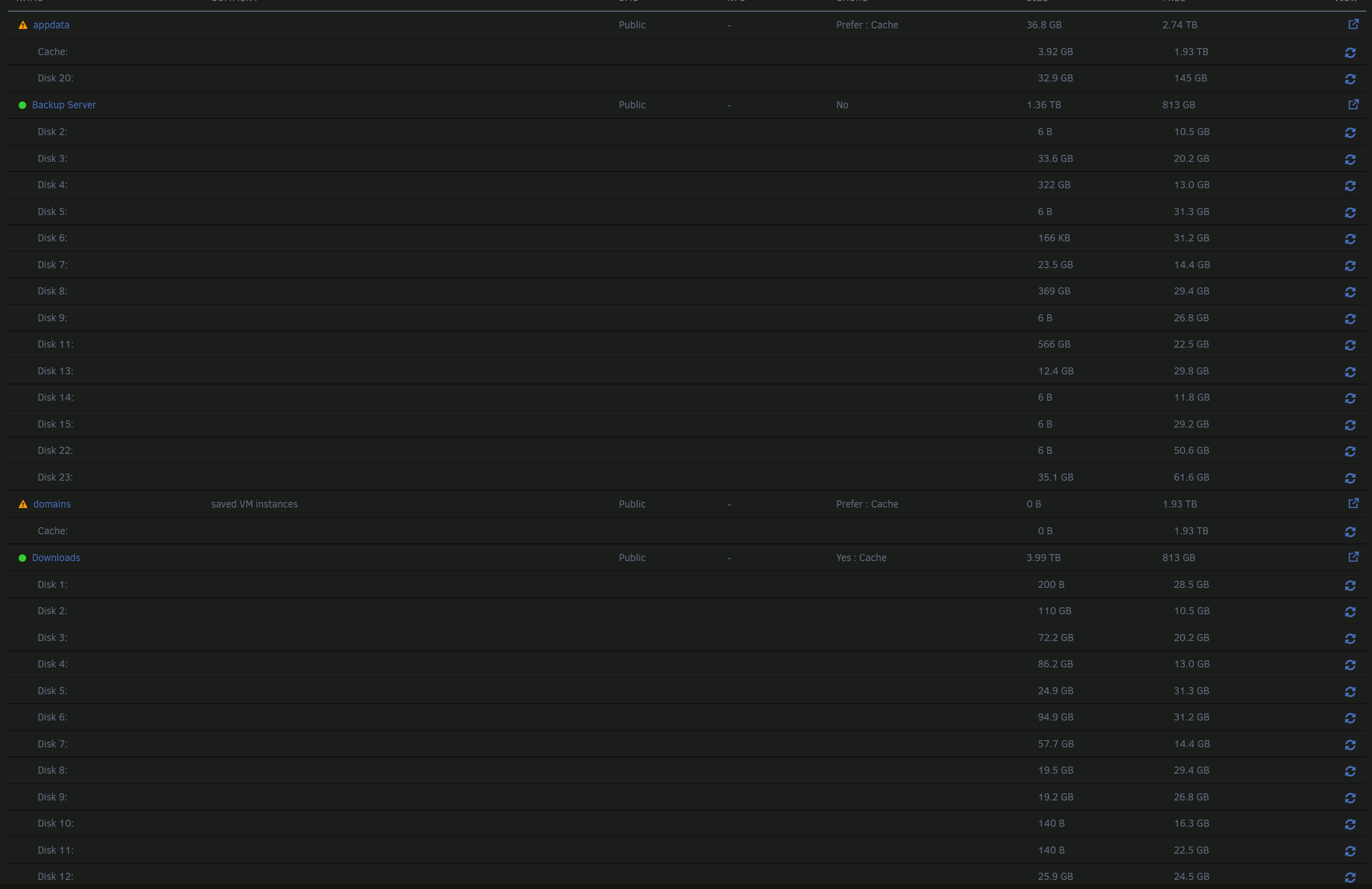

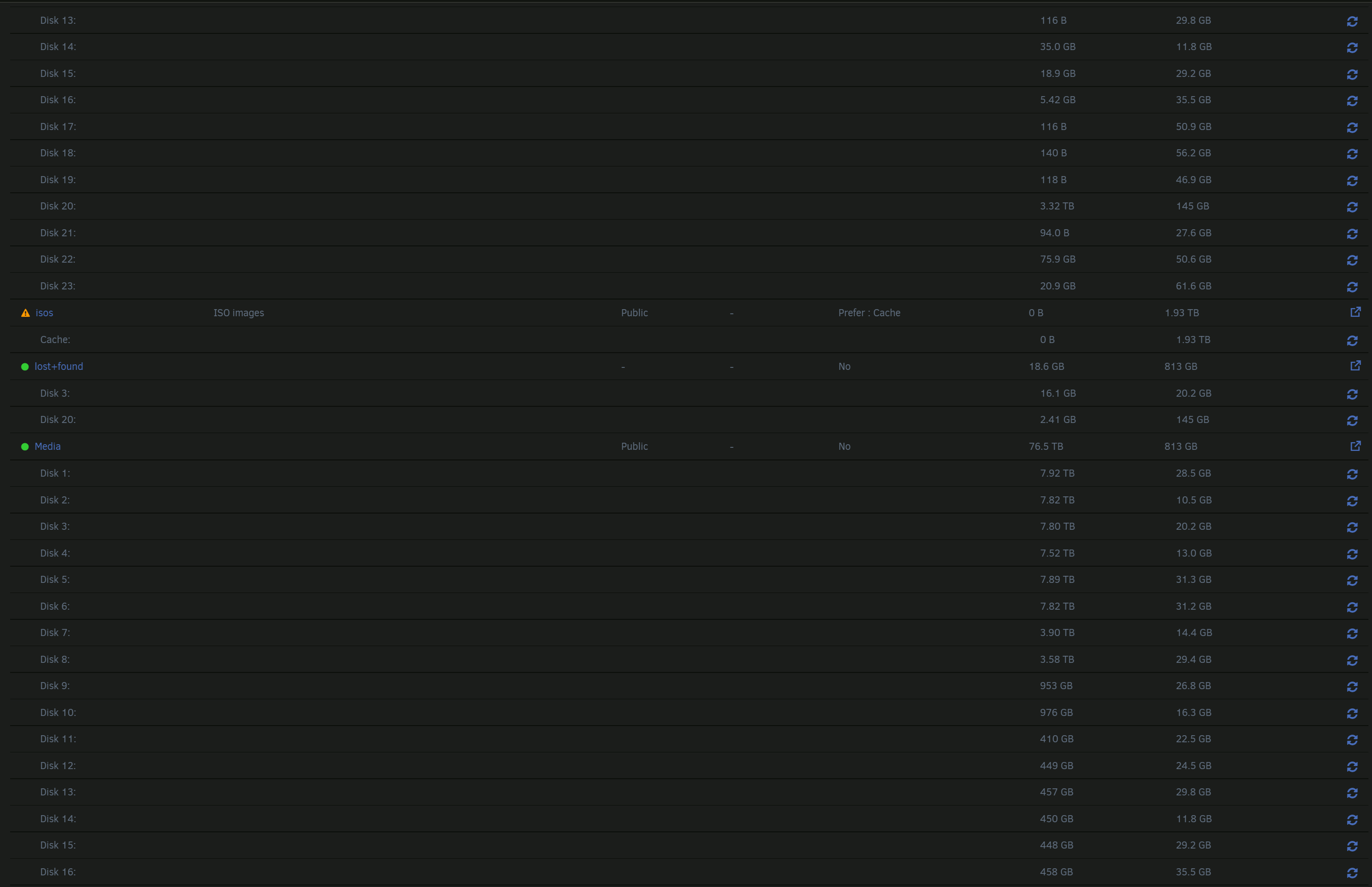

August 17, 20224 yr Community Expert Most of your disks are a lot fuller than I would recommend. On User Shares page, click Compute All button at bottom, wait for the complete results. Complete results will show how much of each disk is used for each user share. If you don't get complete results after a few minutes, refresh the page. Then post a screenshot.
August 17, 20224 yr Author I couldn't agree more, Once I am back up and running I will be replacing one of the smaller drives and doing some major housekeeping. Out of curiosity what should the recommended 'fullness' be ?
August 17, 20224 yr Community Expert Several things to notice in those screenshots. I will break this up into more than one post. lost+found has 18.6 GB, some on disk3 and some on disk20, since those are the disks that had filesystem repair. Have you taken a look at the contents of your lost+found share? lost+found is where filesystem repair puts things it can't figure out. Usually files with unknown names, from unknown folders. Often not worth the trouble to figure out what it all is, but linux 'file' command might be able to tell you what kind of data is in a file so you can try to open it. Do you have backups of anything important and irreplaceable?
August 17, 20224 yr Community Expert appdata (and system) has files on disk20. I wouldn't be surprised of some of lost+found was from appdata. You want all of appdata, domains, and system on fast pool (cache) so docker/VM performance won't be impacted by slower parity array, and so array disks can spin down since these files are always open. domains is already all on cache and set to go there, appdata and system have files on disk20 but are set to go to cache. Nothing can move open files, so you will have to disable Docker and VM Manager in Settings and run mover. Also, mover won't move duplicates so there may be some manual cleanup. Why do you have 50G docker.img? Have you had problems filling it? 20G is often more than enough, and making it larger won't fix filling it, it will only make it take longer to fill. The usual reason for filling docker.img is an application writing to a path that isn't mapped.
