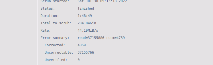

July 30, 20224 yr Author 12 hours ago, JorgeB said: Docker image is corrupt, you need to delete and re-create, before doing that run a scrub on the pool and make sure all errors are corrected, no signs of a device problem that I can see, at least in these diags. ran the scrub with correction, before i continue anything else i need to do to make sure all errors are corrected?
July 31, 20224 yr Community Expert Lots of uncorrectable errors, run another one and post the diags after it's done.
