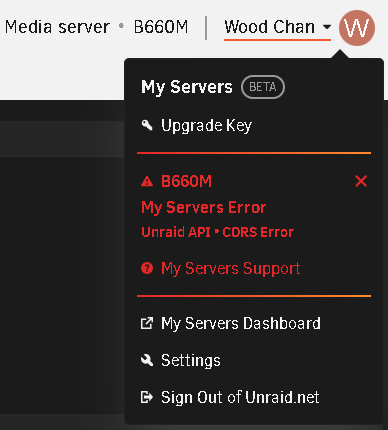

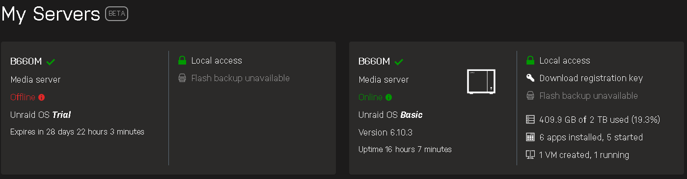

July 25, 20224 yr Above error maybe Flash GUID different? # unraid-api report -vv [ EDIT by ljm42 : when posting on the forum, best to use -v rather than -vv ] <-----UNRAID-API-REPORT-----> SERVER_NAME: B660M ENVIRONMENT: production UNRAID_VERSION: 6.10.3 UNRAID_API_VERSION: 2.47.1 (running) NODE_VERSION: v14.15.3 API_KEY: valid MY_SERVERS: authenticated MY_SERVERS_USERNAME: Wood Chan RELAY: connected MOTHERSHIP: ok ONLINE_SERVERS: B660M[owner="Wood Chan" guid="<snip>"] OFFLINE_SERVERS: ALLOWED_ORIGINS: http://localhost, http://192.168.0.66, https://192.168.0.66:3443, http://b660m, https://b660m:3443, http://b660m.local, https://b660m.local:3443, https://192-168-0-66.hash.myunraid.net:3443 HAS_CRASH_LOGS: no </----UNRAID-API-REPORT-----> Signed Out Server have right GUID but Online have wrong GUID. Have any suggest to fix this issue? THX.
July 25, 20224 yr Author Uninstall "My Servers" than install again fixed GUID wrong problem. But CDRS error still. Edited July 25, 20224 yr by Wood Chan
July 25, 20224 yr Solution 10 hours ago, Wood Chan said: ALLOWED_ORIGINS: http://localhost, http://192.168.0.66, https://192.168.0.66:3443, http://b660m, https://b660m:3443, http://b660m.local, https://b660m.local:3443, https://192-168-0-66.hash.myunraid.net:3443 These "ALLOWED_ORIGINS" are the urls that are able to access the server without a CORS error. What url are you using?
July 26, 20224 yr Author Thanks hit check link url. After use "My Servers" page "Remote access" url without CORS error.
