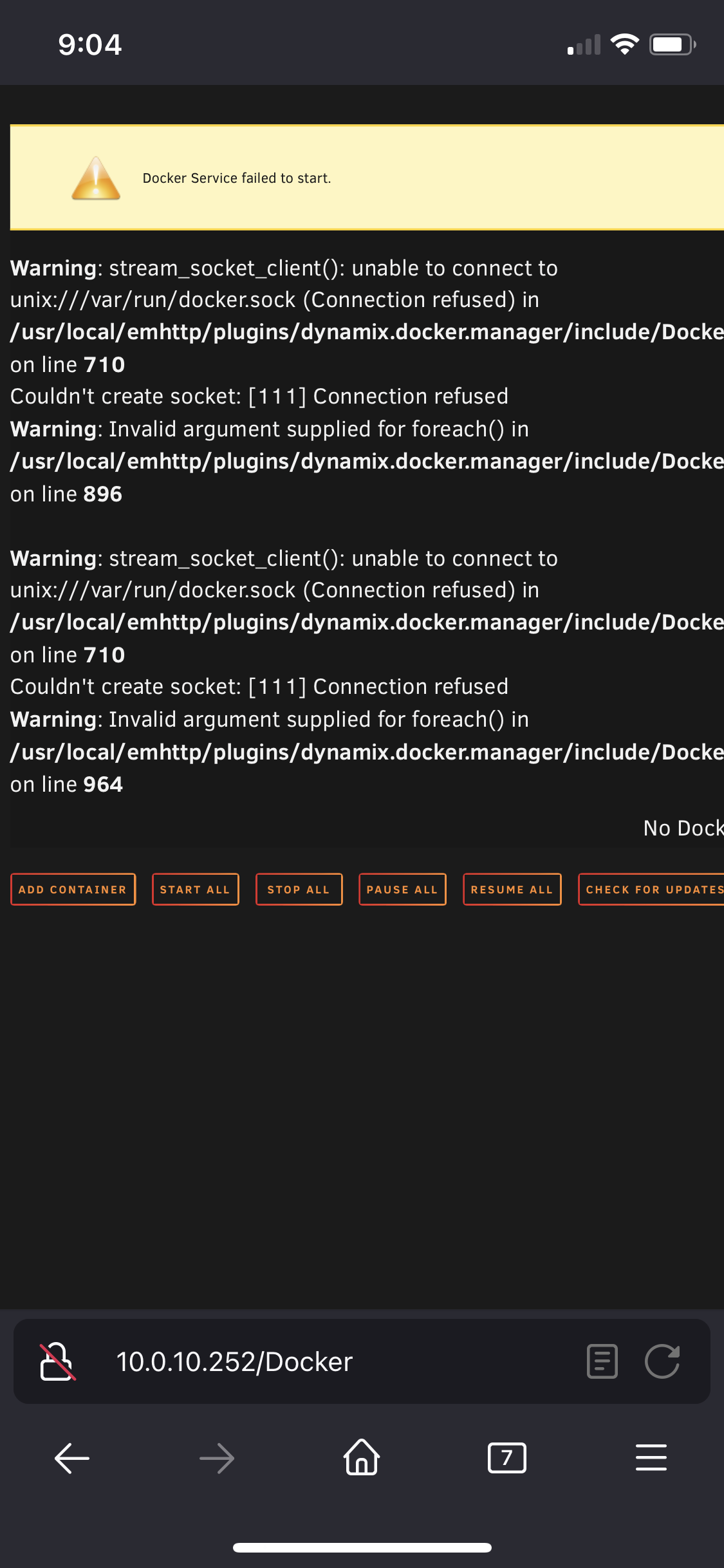

July 25, 20224 yr My docker failed randomly, i thought it was my usb flash drive as i had some input/output errors on the following boot and the webui wouldn't start. I have replaced my USB drive with a new one and restored from a backup but my docker still will not start. my array is mounted and my disks all look fine. Any suggestions? I see these errors in syslog Jul 25 05:29:42 Tower avahi-dnsconfd[3624]: Successfully connected to Avahi daemon. Jul 25 05:29:42 Tower emhttpd: shcmd (626): /usr/local/sbin/mount_image '/mnt/user/system/docker/docker.img' /var/lib/docker 50 Jul 25 05:29:42 Tower root: '/mnt/user/system/docker/docker.img' is in-use, cannot mount Jul 25 05:29:42 Tower emhttpd: shcmd (626): exit status: 1 Jul 25 05:29:43 Tower avahi-daemon[3615]: Server startup complete. Host name is Tower.local. Local service cookie is 3466694824. Jul 25 05:29:43 Tower avahi-daemon[3615]: Service "Tower" (/services/ssh.service) successfully established. Jul 25 05:29:43 Tower avahi-daemon[3615]: Service "Tower" (/services/smb.service) successfully established. Jul 25 05:29:43 Tower avahi-daemon[3615]: Service "Tower" (/services/sftp-ssh.service) successfully established. And this in the docker.log failed to start daemon: lstat /var/lib/docker/image/btrfs/layerdb/sha256/879bc71e199bc7a441949238d32c2a7779020ba3cbce6297c88d3489abfc8579: input/output error hoping there is someway to repair it as i don't remember my docker app settings i remember reinstalling an app a few months ago doesn't have the templates dropdown like it use too. tower-diagnostics-20220725-2231.zip Edited July 25, 20224 yr by Maticks
July 25, 20224 yr Author This was in the docker section when i went to the page. before the system crashed. Edited July 25, 20224 yr by Maticks
