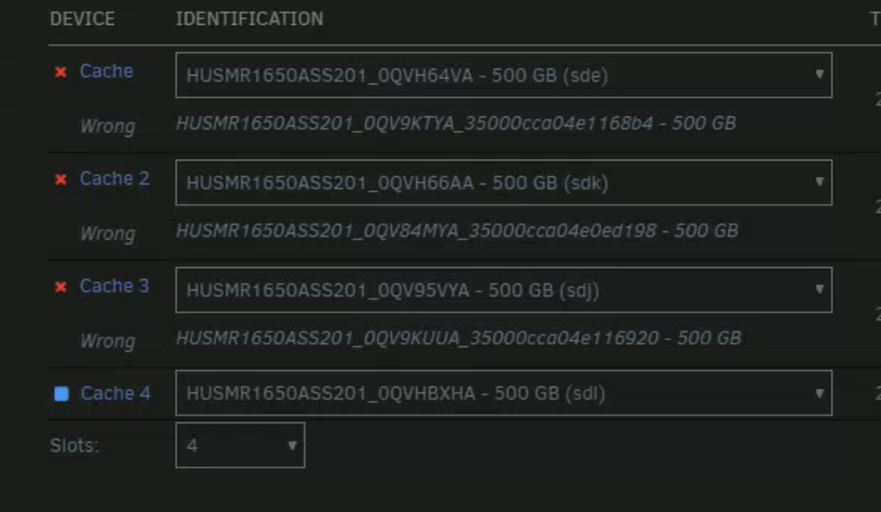

I am setting up a new unraid server and am still working through all the kinks. 3 of my SSDs refused to format no matter what HBA I attached it to so I just removed those.
I replaced them and then added them to the cache pool in place of the 3 broken ones. It worked correctly and I was able to format the pool. But the next time I rebooted, it says that the 3 drives are wrong and that it wants the 3 broken drives again. When I start the array it says that those 3 drives are disconnected and contents emulated. It also won’t let me reformat the pool.
I tried making the pool bigger and that didn’t work. I made the pool smaller and that worked but when I made it the right size again it pulled up the old config. I was able to format if I changed the file system to encrypted but a reboot still brings back the old config and then I converted back to regular and it let me format again but after a reboot it still has the old config. Deleting and remaking the pool also didn’t help. I can’t get unraid to forget the old broken drives.
Solved by JorgeB
Unassign all cache devices, start array, stop array, re-assign all cache devices, start array, that should do it.
You are amazing. I can’t believe it was that easy, the only thing I haven’t tried. I have spent like 3 days trying to fix this among other issues.
