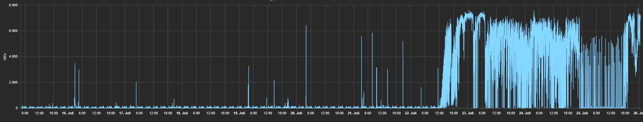

July 25, 20224 yr I have some trouble with the MyServers plugin. Over time it uploaded all couple of hours for a few hours. It startet 22nd of July - so a few days ago. Any ideas?

July 25, 20224 yr Solution Interesting, the issue is on the cloud server not your server. Looking into it, may take a few days though.

July 26, 20224 yr OK this should be resolved. Thanks for reaching out, we are checking to see if anyone else is affected by this as well. A little more detail if you want it... Going forward, you should only see these lines in your syslog when something changes on the flash drive: Jul 24 04:40:28 Server flash_backup: adding task: /usr/local/emhttp/plugins/dynamix.my.servers/scripts/UpdateFlashBackup update not every 10 minutes like we were seeing in your diagnostics. If you want, you can delete your existing gitflash log file: rm /var/log/gitflash so that it will be easy to spot any new errors (note that the occasional message in this file isn't really a problem, only if they are repeated multiple times)
