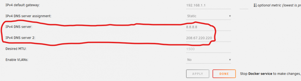

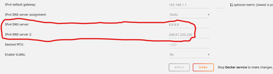

August 31, 20224 yr Community Expert Settings >>> Network Settings Then try to set up DNS servers as shown below:
