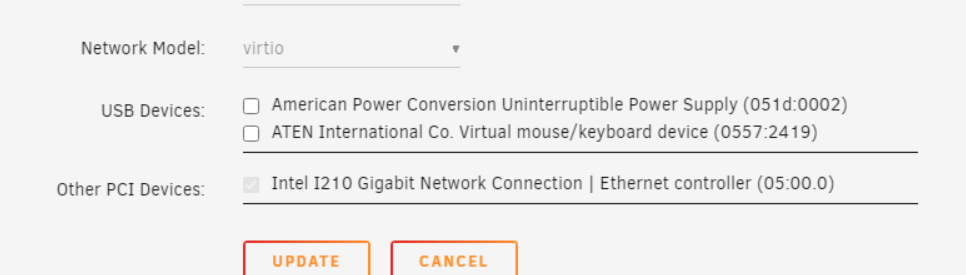

Not possible, but these addresses can change if you change/add/remove any harware, it's done by editing the VM config, in the end, it should be under "other PCI devices", just unselect it with the VM stopped, e.g.:
Interestingly, I started the array, with the VM set to autostart=off. Edited the config, and didn't see anything out of the ordinary in the config.
Started the VM and...
I then stopped the VM, and the SATA controller was present to be unchecked.
Of course, then drive 7 did the disabled thing again, so I had to do the maintenance mode stop/start of the array to get it enabled again. Couldn't stop the array so I had to reboot in safe mode, do the changes, (enabling disk 7 and adding the "new" disk from the SATA controller, Parity 2) and rebooted back into normal mode.
I had to reboot into safe mode because the array just wouldn't stop. Something seems very finicky.
But its rebooted, the VM is up, and the array is rebuilding for the 4th time in almost as many days.
