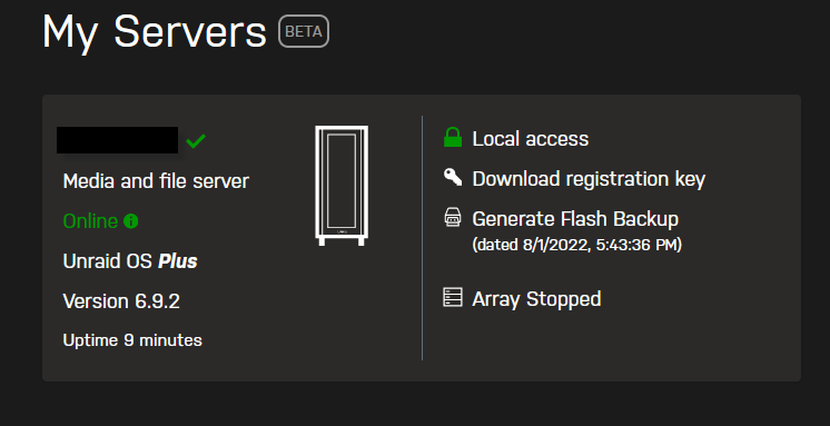

Installed new cache drive. Booted server. At login screen used username/password combination. Screen said they were invalid? Made a few more attempts only to now be locked out? I went through the My Servers page, and it shows the server is online, but I can't seem to login, even though I did not change my username/password settings prior to the cache drive failing.
JorgeB-
Thanks for the reply. I ran through that yesterday. I don't want to lose the other passwords, so I may try the second method shown to remove the characters in between the two colon characters.
Thanks.
Update:
Finally able to get the server back up and running. I installed the replacement nvme drive, and was finally able to get things back up and running. It looks like I probably lost my VMs, but I can re-create those. I did have some trouble logging into the server once I had the hardware replaced. It looks like the GUI does not like special characters in the password field. I had a "$" in my password, and I was unable to get it to save with that character in the password field. I removed it, and that seemed to be the fix. I'm running about 17 dockers for a total docker.img size of 17.6 GB. Thanks again to all that replied.
