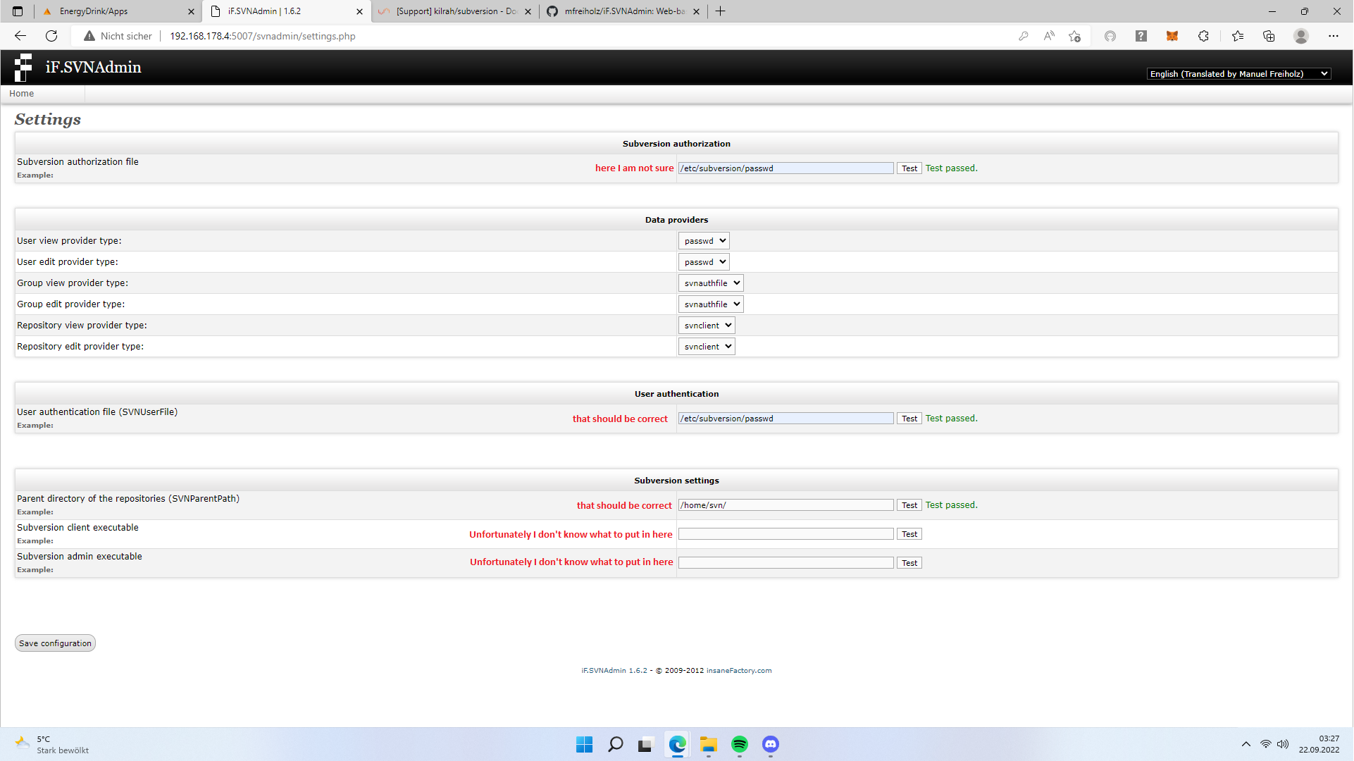

I've attached the picture, maybe you have an idea. (I wrote the text in red)svn_config.thumb.png.f5ccd929d9455a530c7e3b381a7fad88.png
I think the Subversion authorization file must be different than the user authentication file (SVNUserFile) but I'm not sure what the path is.

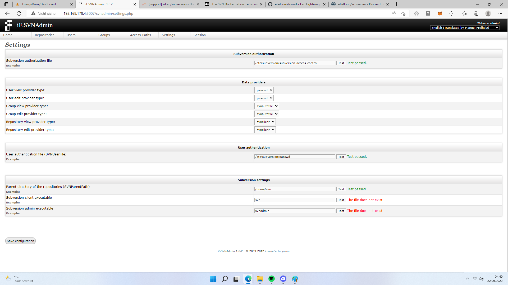

okay I found the solution and would like to share it, now I understand a little better what docker means with the paths and executable.
Even if it says "The file does not exist." the command must be specified in this case. Now I can also create a repository before there were only error messages.
I hope this helps someone...sorry to bother Kilrah unnecessarily.

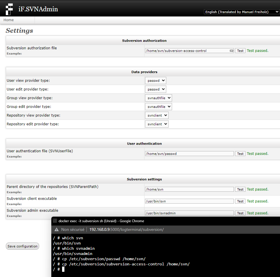

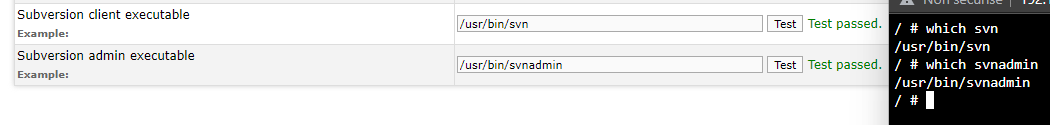

If you want them "correct" i.e. the full path you can check where those binaries are in the container by opening a console to the container and checking there. Also you'll probably want to copy the auth files to /home/svn so that they're stored in appdata on unraid side otherwise they'd be stored in the container and lost whenever it's updated.
There may be more steps needed to tell svn to use those though, don't have the time to look right now...
