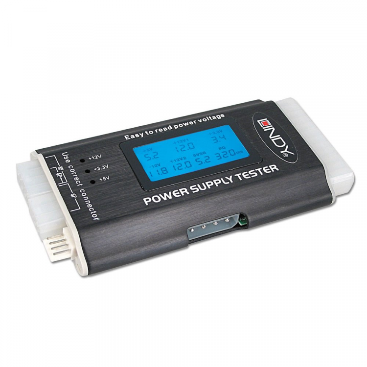

Have you tried a different motherboard? The board is in charge of changing the power state from standby to on, the PSU only supplies minimal power to the board until one of the PSU pins is held low, so if the motherboard doesn't hold that pin low, it will power off.
You can test that theory with a cheap PSU tester that plugs into the motherboard connection, one similar to this. With the tester plugged in, the PSU's should go to full on and stay that way as long as there is AC.
(image stolen from a quick search)

I'm not saying for sure it's the motherboard, but that's where I'd start my investigation from where you left off.
