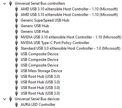

In Windows Device manager you can see my USB 3.0 devices. It also mentions Type-C for my GPU (A MSI 2070 Super Gaming X Trio) but the card doesn't have a Type-C port. I assume its for controlling the LED's. Device manager shows no issues with the drivers, and i've ran "Snappy driver installer" on the machine and it hasn't reported any driver issues either.

however your device manager is already showing USB 3.0 devices (mine were showing as USB 2.0 as your picture led me to investigate)
