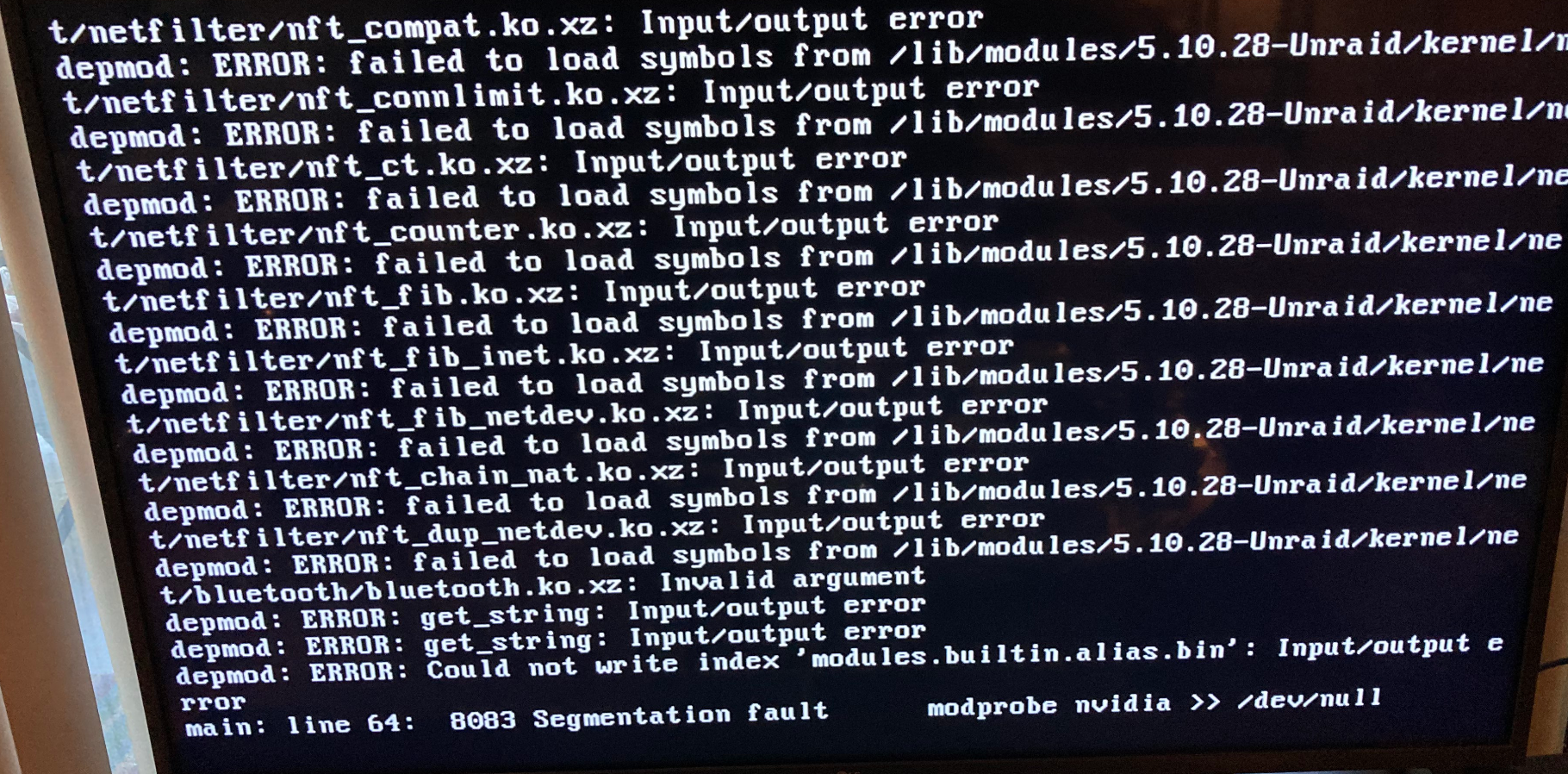

July 31, 20224 yr Hello, I recently had trouble with my server, it shows a lot of errors at startup and then freezes a few minutes after getting online. I managed to grab some of the system log after booting it again. I haven't made any hardware / major software changes recently so I'm not sure what could be causing the problem. I can supply any additional info that's needed as well. Thanks all! Update: I thought it could potentially be memory issues so I ran memtest, it didn't finish and popped up these errors eventually. UnraidLog.txt Edited August 1, 20224 yr by micromilk Typo + more context
August 2, 20224 yr Author I decided to remove one of my ram sticks and it seems to be in stable working order again. Thank you for the tip! Edited August 2, 20224 yr by micromilk Clarity
