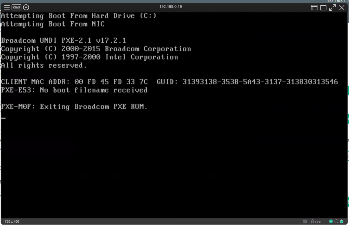

August 1, 20224 yr Hi everyone! My server is Hp Mircoserver Gen8. I into the safe mode , In order to migrate "appdata". All down I click web button "restart" and the unraid can not boot. this is my ILO remote control screenshot, I'm sure I can't boot after this screenshot. Maybe I should reinstall the unraid? Edited August 2, 20224 yr by wnd

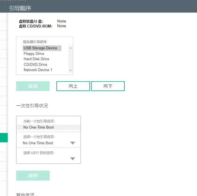

August 1, 20224 yr Author 18 minutes ago, trurl said: Looks like your BIOS has forgotten which device to boot from I check my ILO boot device, the USB flash device is None.
August 2, 20224 yr Author Thx everyone, I reinstalled my flash drives and reboot my server,it worded. maybe is safe mode balbalbala... but who care. thx again!
