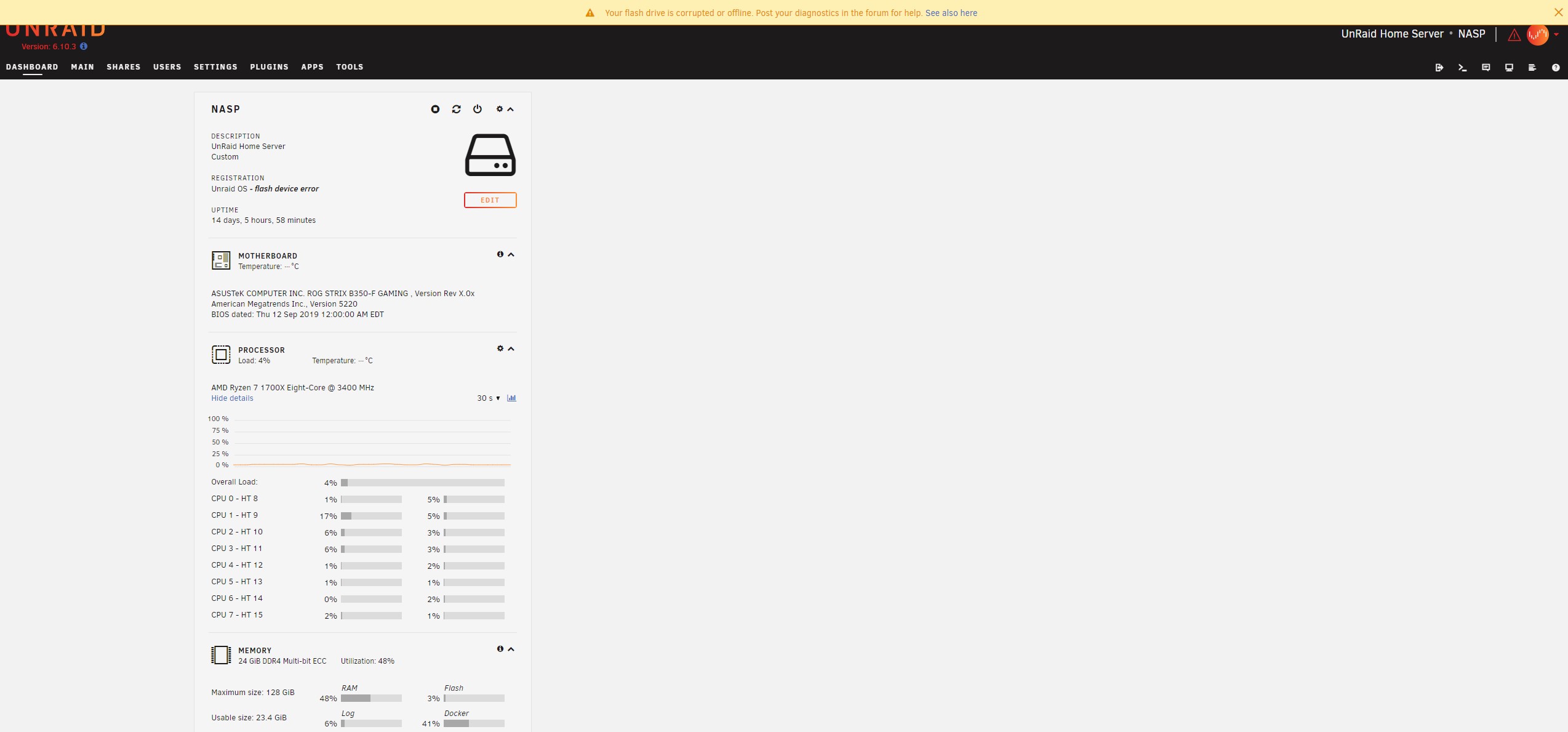

August 1, 20224 yr Had server running for couple years, 7 months powered on last stretch before updating to 6.10.3 been running about a week, just signed in to add access to a share and it's saying flashdrive corrupt or offline? 1. Is it possible to just pop in a new flashdrive and import settings to it, if not why? I know it boots from the drive and then it isn't supposed to use it, though some personalized settings in unraid are now gone with the drive like skin colors and vm's not showing. I was under the impression that the drive was loaded into memory on start up and then not accessed? 2. I am still able to sign into the server as I have not taken it offline yet and can get disk assignments, however it is not showing vm's, are they hosed? 3. Although I am able to sign into server, after I noticed the banner about flashdrive all my nas drives are not accessable from computers anymore. 4. If/when this is sorted out and I get another flash drive in there is it possible to setup a dual usb drive boot for redundancy, I can't seem to find info to set this option up and find it odd that for a system that is all about redundancy it does not have that option.
August 1, 20224 yr Community Expert 4 minutes ago, FrostyOne said: it's saying flashdrive corrupt or offline Where do you see that? Screenshot? attach diagnostics to your NEXT post in this thread

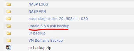

August 1, 20224 yr Author Here's a shot of the banner showing flash drive error. Also a shot of a backup I found but it's on a backup that's on the array, lol. I should be able to disconnect that single disk and access it with a sata adapter to my computer correct?

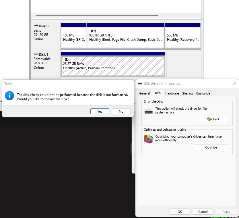

August 2, 20224 yr Community Expert Flash drive has disconnected. Shut down, put flash drive in your PC and checkdisk. While there make a backup. Then reboot. USB2 ports are often more reliable for this.
August 2, 20224 yr Author Well it looks like there is no life on the usb drive, it won't checkdisk, it shows up in disk management.
