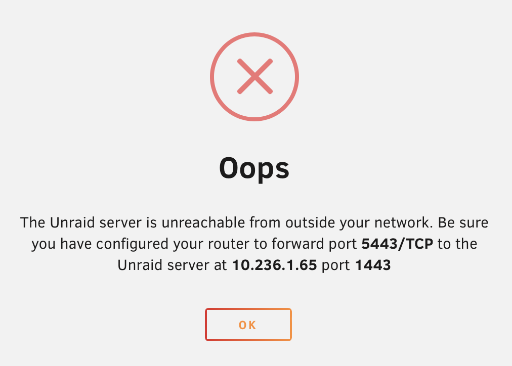

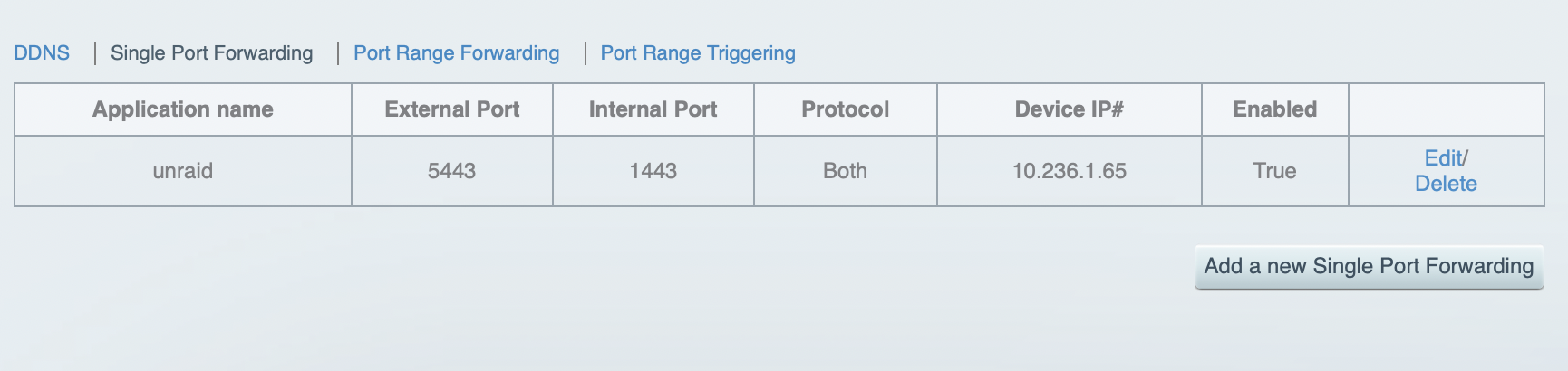

August 3, 20224 yr Hi all, after following the guide for setting up remote access I have had success with provisioning a certificate but im being snagged up by a port forwarding issue. I am a networking noob, so Ive taken a screenshot of my config on my router swell as the error I receive when checking the connection on Unraid. Have I setup port forwarding correctly?
August 3, 20224 yr The "protocol" should be "TCP" rather than "Both". But I doubt that would prevent you from connecting. I'd recommend contacting your ISP, it seems like they may be blocking you from accepting incoming connections.
August 4, 20224 yr Author I'll give that a go, of that doesn't work I'll get in touch with my ISP. Thanks so much for your help.
August 9, 20224 yr Author To anybody that finds this thread and has the same problem, remember to port forward from your modem to your wireless access point if they are seperate units lol, at least I got to the bottom of it! Thanks for everybody's help.
