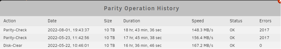

Parity checks reporting the same number of errors with each run
I built a new Unraid sever earlier this year and dropped in 3x10TB, and 2x6TB drives, with 1 of the 10TB drives acting as parity.  The disks all formatted and worked properly.
About a month later I experienced a power outage and re-ran parity after it came back online.  The parity check reported 2017 errors but reported all corrected.  My first scheduled/automated parity check ran earlier this week (8/1) and completed, again reporting 2017 errors.
Is there a step that needs to be performed to clear the errors?  Or do I have another issue (ex. bad drive)?  I've run the fast SMART tests against all drives and they all came back clean.
Where did you see that it said they were all corrected?

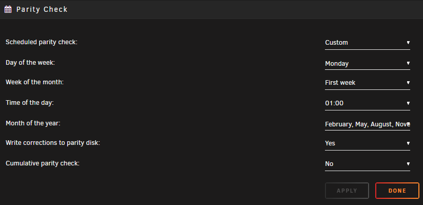

34 minutes ago, trurl said:
Hopefully you have that set as noncorrecting also.
The scheduled task is set to 'Write corrections to parity disk':
At this point do you recommend that I start a manual parity check with the 'write corrections to parity option' enabled?
It is normally recommended that the scheduled checks do NOT automatically correct errors.   The reason is that you if you have a drive misbehaving and you are not aware of it you do not want it corrupting parity.   If the scheduled check reports anything other than zero errors then it is time to investigate why.   Ideally you should always run correcting checks manually after you have fixed any hardware issues.
