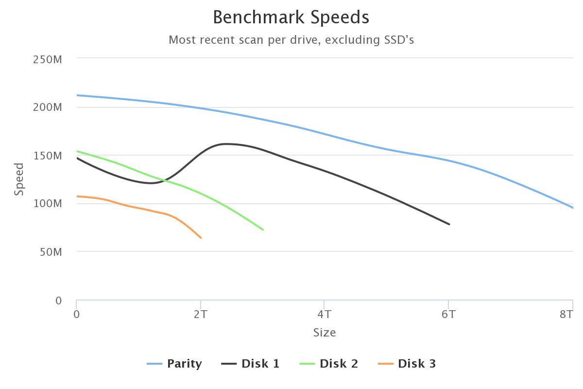

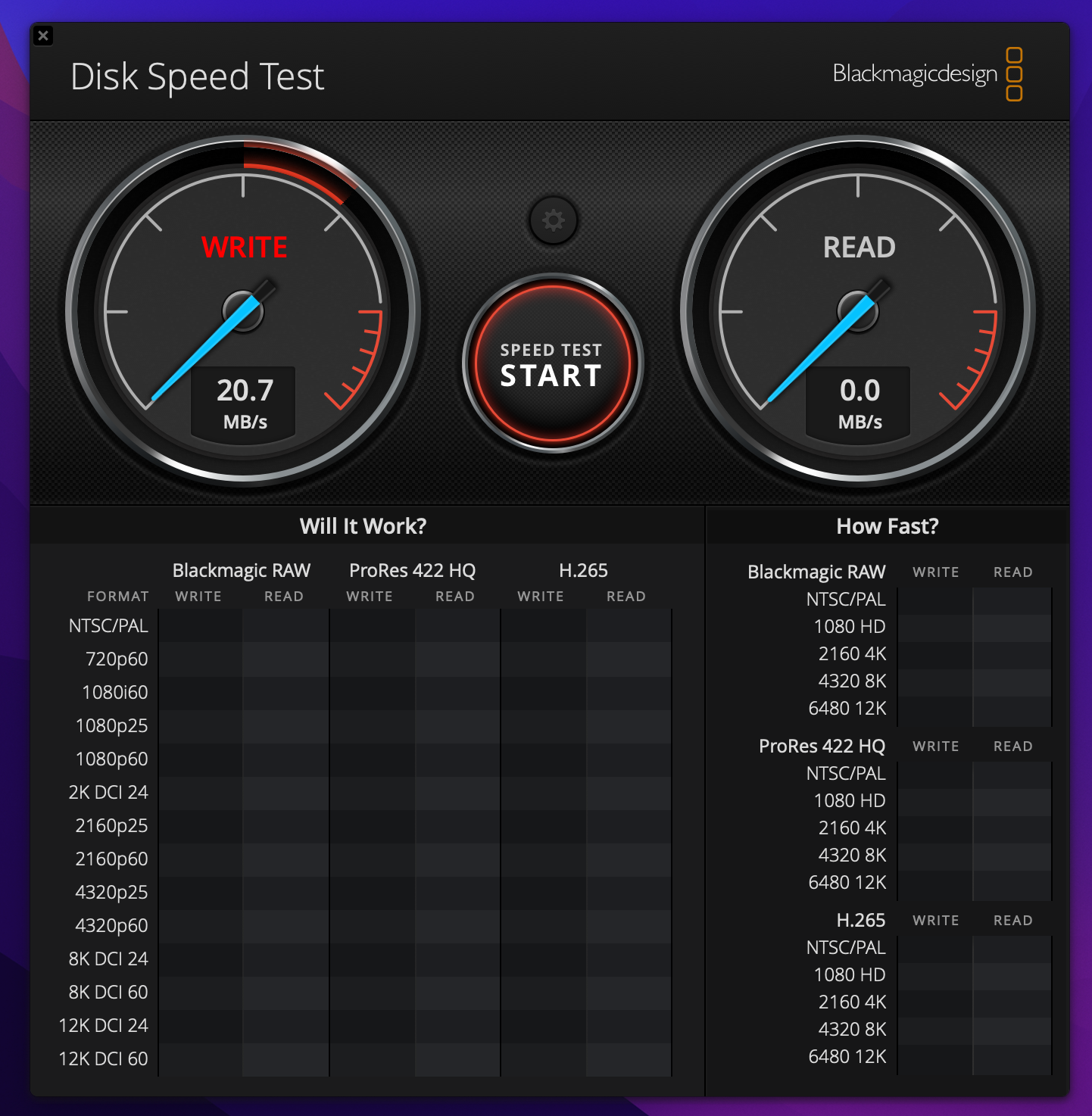

August 4, 20224 yr Im getting about 19MBPS up and down, it's really slow. This is wether I write to the cache drives or not. Ive attached a diagnostic file, any help would be much appreciated. Ive turned on turbo write, and I've done a disk speed check and they are all good for 100MBPS. Any Help would be greatly appreciated. server-diagnostics-20220804-2029.zip

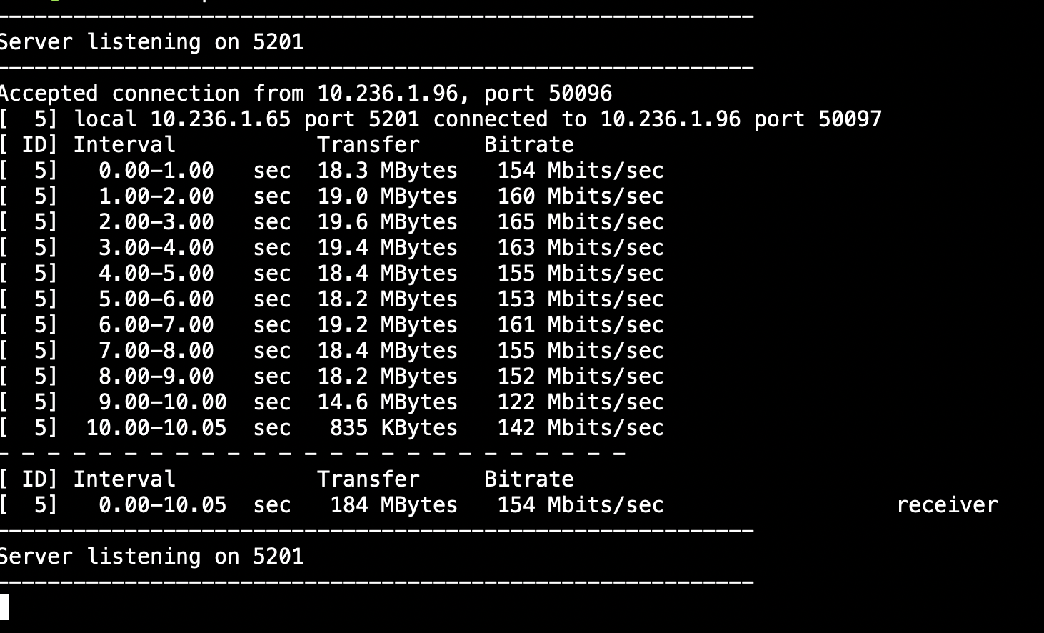

August 4, 20224 yr Community Expert Start by running a single stream iperf test in both directions to check network bandwidth.
August 4, 20224 yr Author Thanks for pointing me in the right direction, for whatever reason im only getting 150mbit on my LAN connection, tried several different ports, still really slow. Everything is checking out as a gigabit connection. And I tested the same connection with different devices and the speed is there, just not for unraid for some weird reason. Any ideas?
August 4, 20224 yr Community Expert This is usually NIC, cable, switch, etc, see if you can try with different ones.
August 9, 20224 yr Author Thanks so much, the problem ended being the PC falling back to WIFI even though LAN was plugged in. No getting 800-900Mbit. Can't believe I overlooked it lol.
