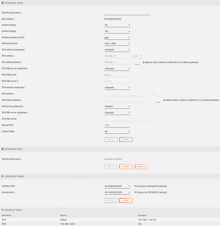

First and foremost, I am sorry even to be asking this. Coming from a networking background, I feel dumb after spending a few hours on this project.
Backstory:
I upgraded my internal network with new 10G SFP Ethernet modules and Cat7 networking. The new setup is simple:
Ubiquity Dream Machine Pro to un-managed switch via SFP, un-managed switch to HP DL360 Gen9 via SFP. I then swapped from 100Mb Ethernet to the SFP port by plugging in the new SFP, hooked up an Ethernet to my router, and then swapped the 192.168.1.3 IP reservation from the old Ethernet to SFP. Rebooted, logged right in, no issues.
Once I verified the SFP module and port were working and assigned the 192.168.1.3 in DHCP, I rebooted and disabled the original internal 4x Ethernet ports via the bios, again,  logged right back in with no issues. After all this, I had my system running with Eth0, Eth4, and Eth5 (SFP ports). I shut Eth5down, leaving me with Eth0 and Eth4.
Issue:

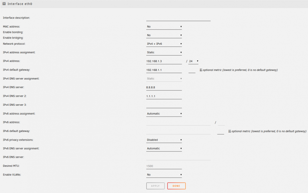

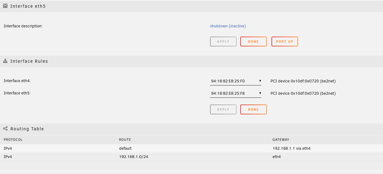

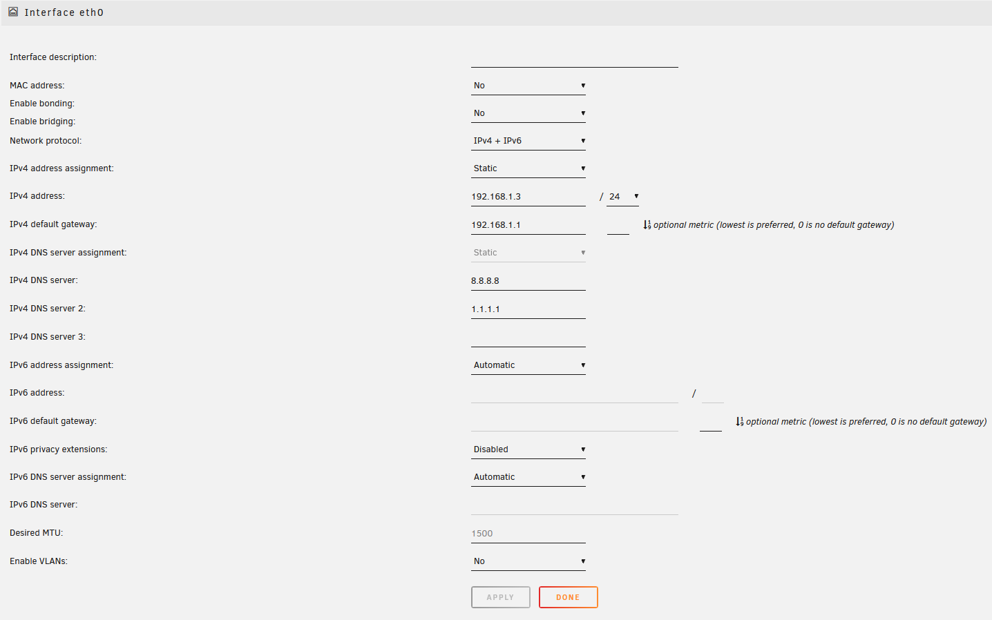

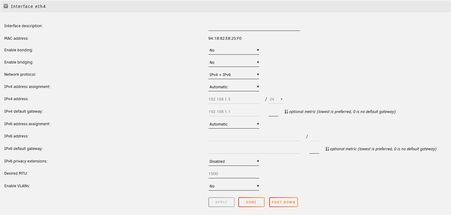

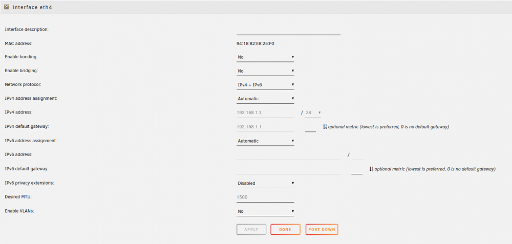

Now this is where it gets weird. "ifconfig" shows no Eth0, and "ifconfig eth0." shows "eth0: error fetching interface information: Device not found." I have to manually assign the 192.168.1.3 IP to Eth0 for it not to pull a 169.x.x.x address. I believe I have everything set up correct; attached are pictures of the Network Configuration page.
Any help would be appreciated regarding what I may be doing wrong or if I am way over thinking this lol 🙃🙃🙃
Solved by JorgeB
There's no eth0 on interface rules, delete/rename /config/network-rules.cfg and reboot.
Hey JorgeB! Thanks for the tip, let me give that a shot and see what happens. Will rename for now, and if it works I will delete the old copy. :)
@JorgeB You are a wizard; that seems to have done it! Everything appears to be working flawlessly now. I have to ask, what do you think went wrong here? Did I not prep this correctly, or did something strange happen on one of the reboots to cause it to wig out?
Possibly the NIC detection script got confused, probably nothing you did, glad it's working now.

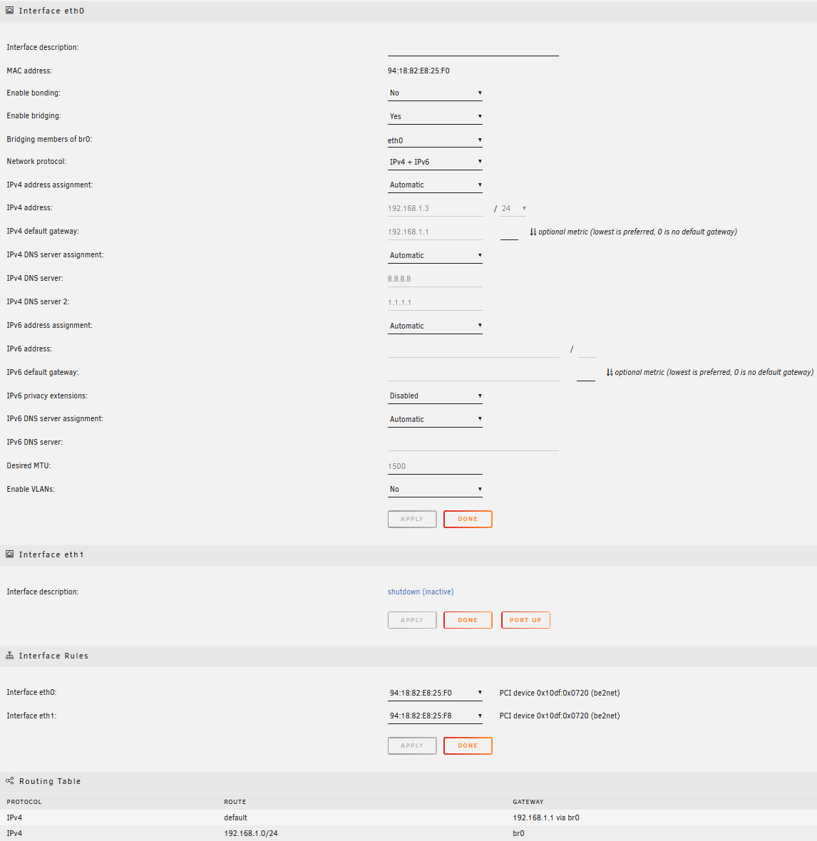

How can i  set Eth0 in this screenshot?
1 minute ago, TRusselo said:
Are you sure?
Sorry, I was referring to the first part of your comment which was that eth0 and eth1 were swapped. That could have been fixed on Settings -> Network Settings -> Interface Rules rather than physically removing the nic.
Once the nic has been removed and eth0 has gone missing, then deleting the file and rebooting is the best way forward.
