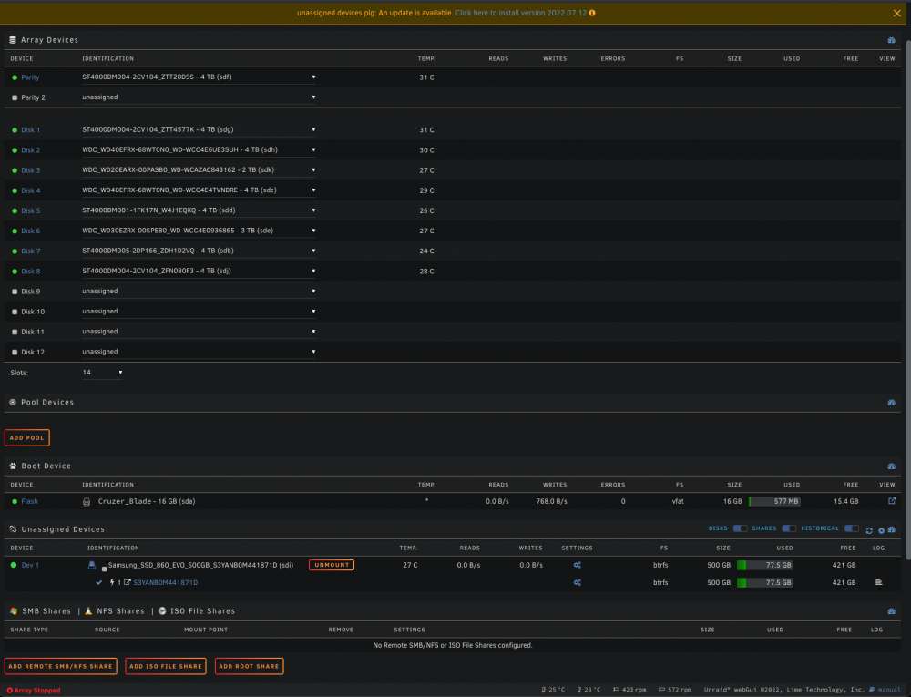

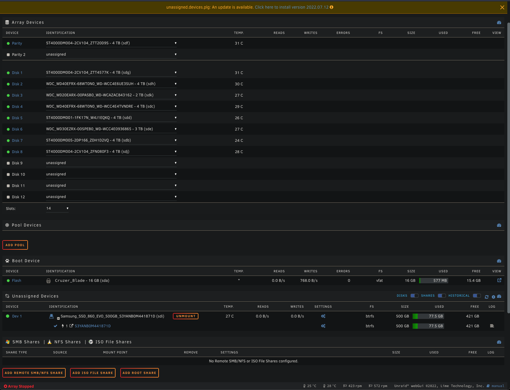

Post a screenshot of Main - Pool Devices
Done thank you let me know if there is any other info you need.
Possibly a silly question, but have you made sure that the SSD is not mounted in Unassigned Devices when you hit the Add Pool button?
Yes i have tried that it is mounted in the screenshot as i thought that it may help with creating the pool.

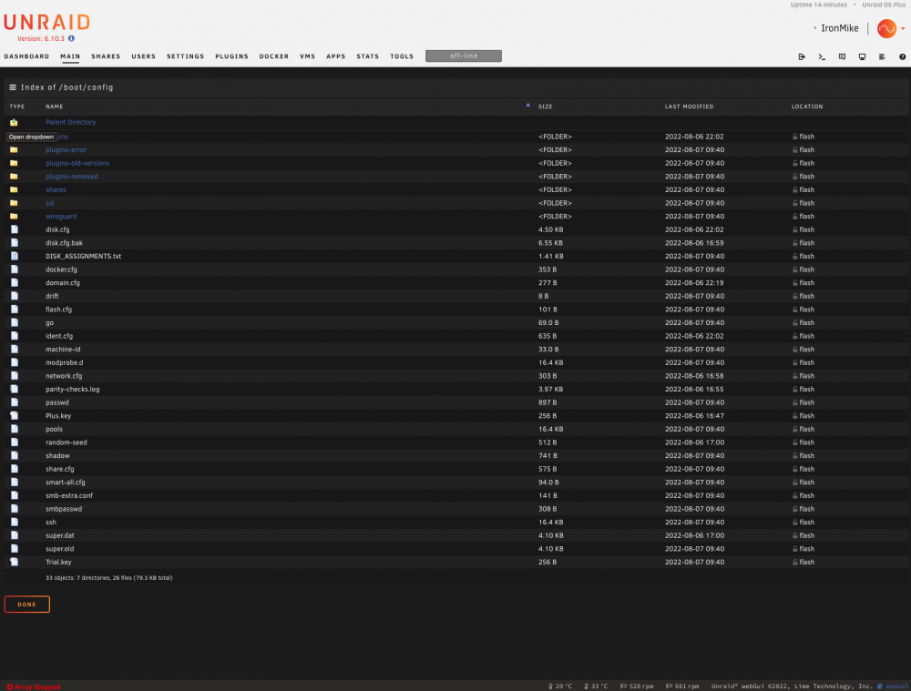

Looks like a flash drive problem, Unraid cannot create the pool config folder/files:
Aug  6 08:14:10 IronMike emhttpd: scandir: /boot/config/pools Not a directory
@JorgeB ok what would you recommend in this situation can i manually create this directory? Or do i need to look into replacing repairing USB Drive? Permissions?
I would first try recreating the flash drive, backup current one, recreate it using the USB tool or manually, restore the config folder, try again.
Ok i will try that and keep you posted thank you for the help.

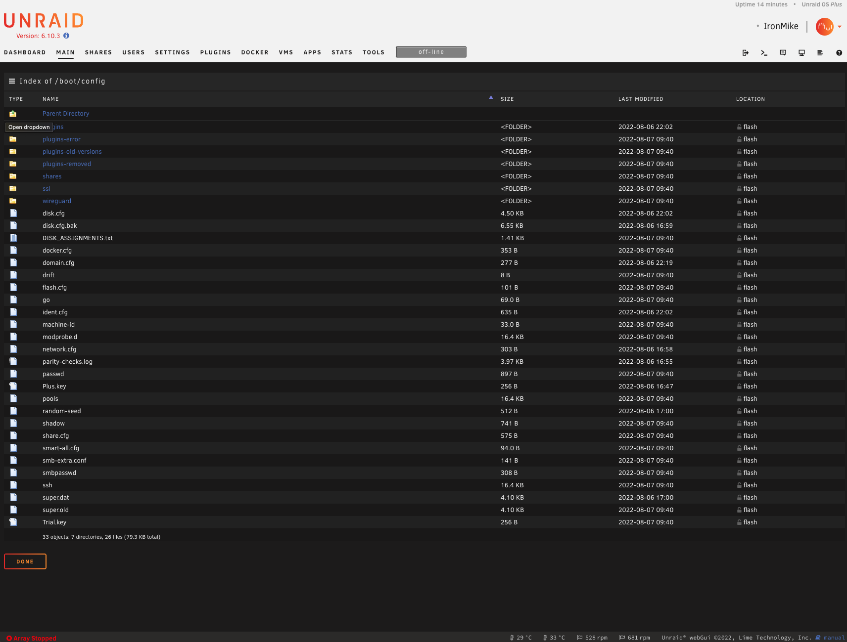

Navigating the the /boot/config/ i can see a file tabled pools but no folder is this the issue?
Delete that file, it should not exist.
That was it thank you. Removing the "Pools" File resolved the issue.
Again thank you all for your help resolved in under 24hours and much appreciated.
