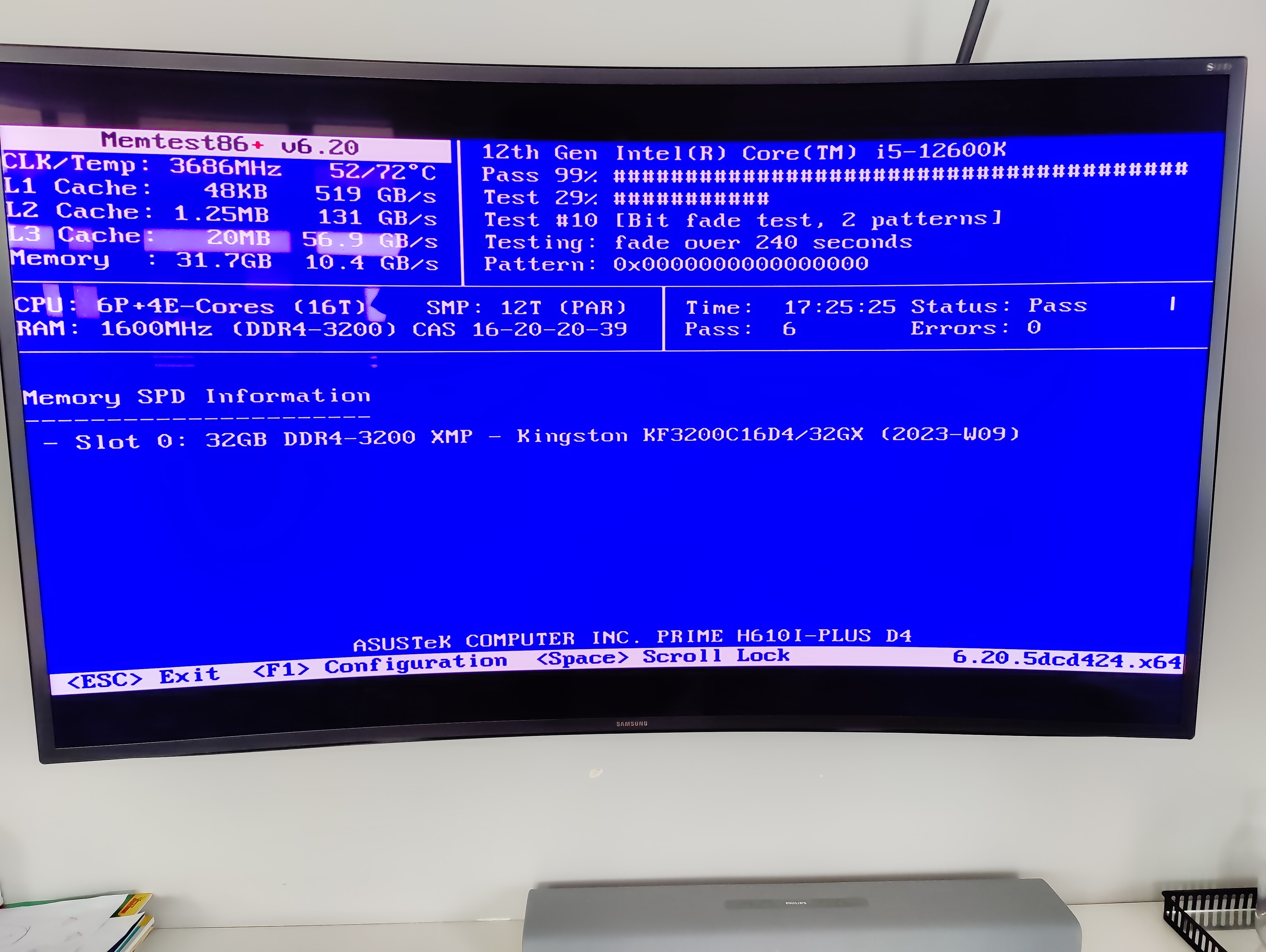

Thanks. I stop and look to change. I never do that. Can You tell me it's in Ai Tweaker tab > DRAM Frequency?
Ok, I change Frequency to 2133 and set mode energy efficient but still have errors in memtest.
ok, then I would return the RAMs. 2133 should always work (but "energy efficient" ? turn this off and try again. dunno if it has bad effects)
Hi @MAM59 can You tell me how long that test should work? It's still testing. I took out one 32GB and test second. Looks like only one have that errors.
1 to 2 passes is usually enough to find most issues.

Thanks. I order new ones. Can You tell me do I have to do something on unRAID when I change RAM?

OK, thank You for Your help. I already make return on Amazon and order new ones.
