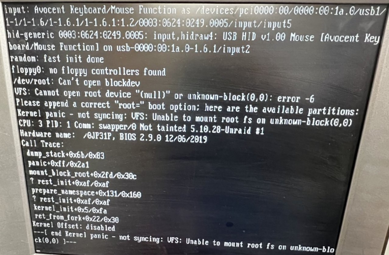

August 6, 20224 yr Within the last few weeks, I'd find my Unraid server unresponsive. I'd reboot and things would work again. This happened twice. Today it happened again but a reboot no longer fixes the issue. The server doesn't boot. I get a Kernel panic error. I guess my flash drive is bad? I was able to copy all of the files from the flash drive to my PC. I have another flash drive to try. I've created another drive with the USB created. Is it as simple as overwriting the config directory from the old drive to the new?
August 7, 20224 yr Community Expert Yes, this is usually a flash driver problem, you can first try to re-format the original flash drive (after making a backup), if that doesn't work try a different one.
