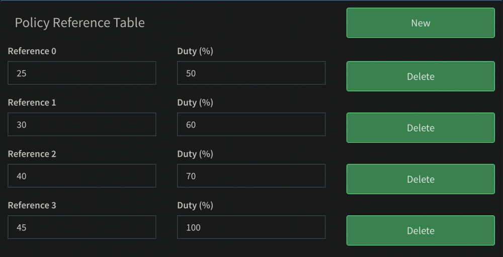

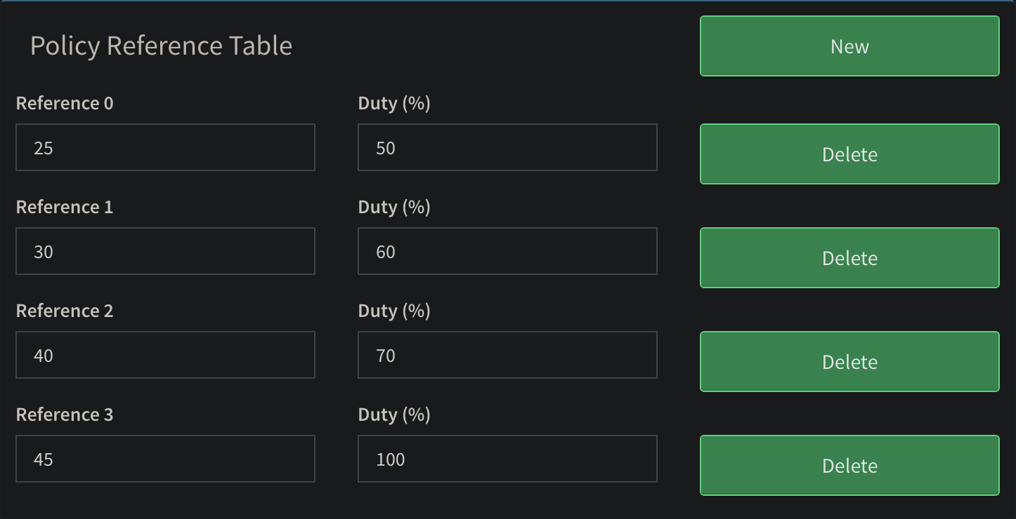

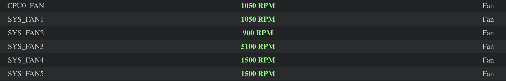

August 11, 20224 yr Author @Nightshade So, I kind of got it to run, what I did was take the exhaust fan of the Noctua NH-U9 TR4-SP3, and placed that on CPU0-fan, then I placed the intake fan of the Noctua NH-U9 TR4-SP3, and placed that on FAN2. I made the following policy; So what I gathered was the Reference is the Temp, and the Duty% is the fan speed. So for the example above I have CPU0 Fan to the exhaust and Fan2 Fan the intake of the CPU, I also added Fan1 as the exhaust of the chassis in this Profile. In the Policy Reference Table it's saying if the temp (Reference 0) reaches 25C then set the fan (Duty%) to 50 percent and so on and so on. Before I figured this out, I was getting the CPU with a fan speed of 150rpm, right now it's a 1050rpm. (see below) As you can see, CPU0_FAN, SYS_FAN1, SYS_FAN2, are the Exhaust CPU cooler, Exhaust Chassis Fans, and Intake CPU cooler, respectively. I hope this helps you understand it a little better. Now I haven't been able to figure out how to get Fan 4 & 5 work off the HD temps. I haven't had success in trying to create another Fan profile run together. If there is anyone that knows how to use the BMC management please, I would appreciate all help.

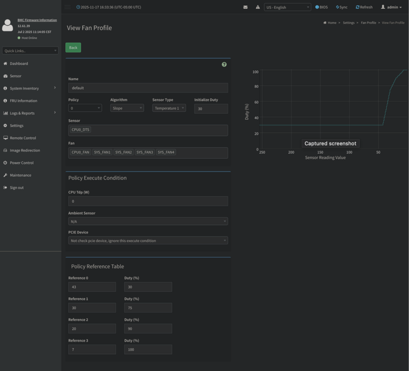

June 25, 20251 yr I have a Gigabyte MZ32-AR0 REV 3.0 (latest BMC Firmware 12.61.35, latest BIOS M23_R40), and I see the same problem, all fans always at full blast. There is no rpm sensor readings for any fan. Fan profiles in Gigabyte Management Console have no effect and only list 4 mysterious fans (BPB_FAN_1A, BPB_FAN_2A, BPB_FAN_3A, BPB_FAN_4A) similarly to what is shown in page 109 of the user guide for Gigabyte Management Console ( https://download.gigabyte.com/FileList/Manual/server_manual_mgt_console_user_guide_ami_v1.x.pdf ).The user manual for MZ32-AR0 revision 3.0 ( https://download.gigabyte.com/FileList/Manual/server_manual_MZ32-AR0_e_v3.0.pdf ) actually shows in page 19 that this MB has 6 fans (CPU0_FAN, SYS_FAN1, SYS_FAN2, SYS_FAN3, SYS_FAN4, SYS_FAN5).I found that the user manual for MZ32-AR0 revision 1.0 ( https://download.gigabyte.com/FileList/Manual/server_manual_MZ32-AR0_e_v10.pdf ) shows in page 90 that they had Fan Control settings in BIOS, but it was removed for the newer revision 3.0.@gyrene2083 , did you have to do something special to display the correct fans? What version of BCM Firwmare and BIOS are you using? Edited June 25, 20251 yr by corescarbon

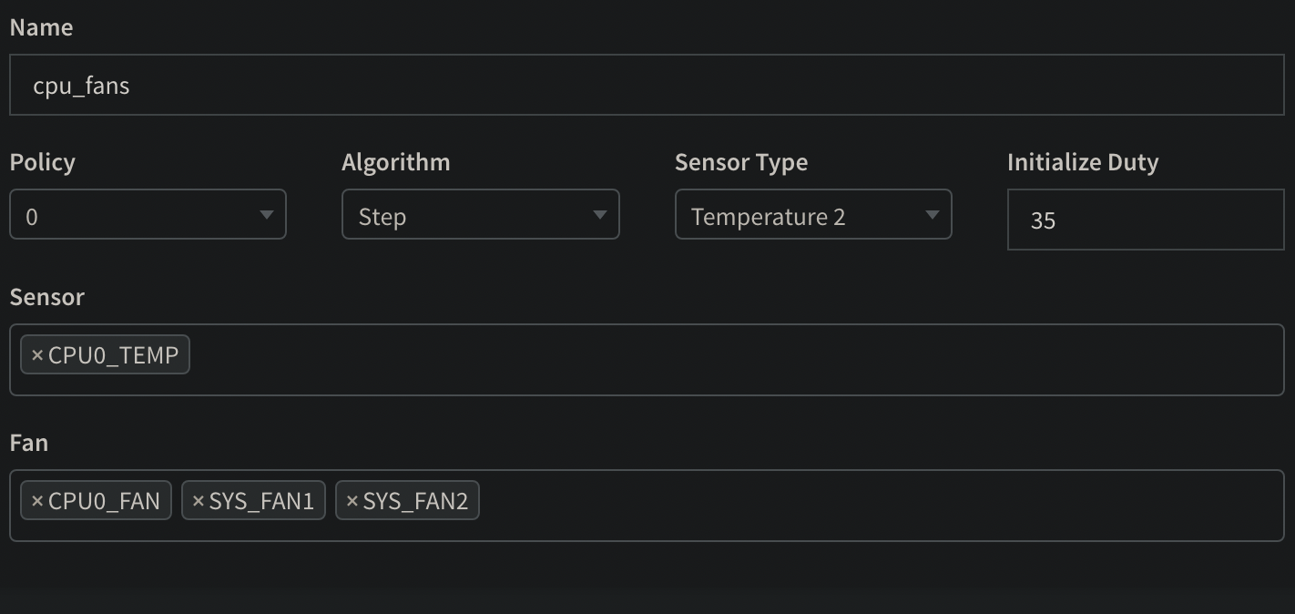

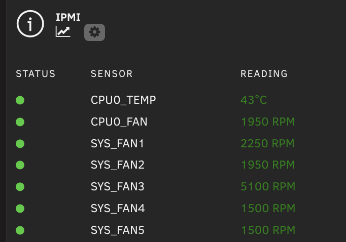

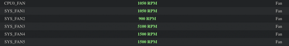

November 17, 2025Nov 17 Author 16 hours ago, ack0049 said:Would you mind providing your ipmi script that you got working? Or, at the very least, could you let us know the hexadecimal IDs for each fan header?Thanks.Hello, @ack0049 I actually checked my scripts, and apparently, I don't have it running. But here is what my setup on this mobo looks like. I made some changes to the BMC fan control a while back, and so far it seems to be working. Here's a screenshot of what I have. Here are my fan speeds right now. FAN1 are my two rear fans, and FAN3 are my Noctua NF-A4x20 fans (2). I have blowing on my nvme.I hope this helps.
