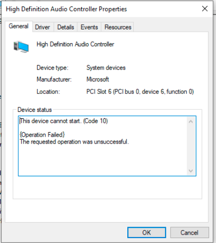

Hi Folks. hoping that someone would be able to help me out with audio issues, When passing through onboard audio from an Asus motherboard to windows 10 VM. The sound was working fine and then suddenly after a windows reboot it disappeared. Under the device manager I get the following error when looking into the driver:
This device cannot start. (code 10)
My initial thought was that it could be due to RC version of Unraid so restored it to a stable version and issue remains. So far I have tried reinstalling drivers, reinstalled windows OS, also tried passing audio to a Linux VM without any luck.

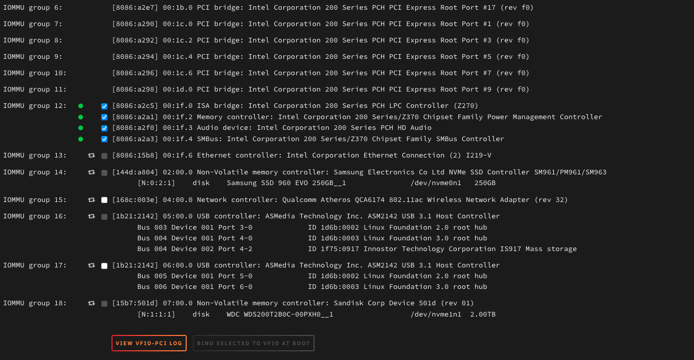

I have also tried the following in the config
pcie_acs_override=downstream,multifunction vfio-pci-ids=8086:a2af,8086:a2ba,8086:a2c5,8086:a2a1,8086:a2f0,8086:a2a3,10de:1b06,10de:10ef,168c:003e,1b21:2142 modprobe.blacklist=i2c_i801,i2c_smbus
but still no luck.
Would really appreciate if someone is willing to help.
Just an update, it's been fixed after a week of trying everything. The solution turned out to be completing shutting down the server and unplugging it from the power. A simple restart won't do anything. The idea came from the following post where it is mentioned at the end that the author of that post had to do same thing.
