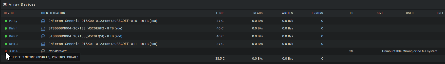

Upon seeing that the entire Yotto was missing, I shut down unraid and removed the new toshiba drive which was making worse sounds by the second. Booting unraid back up, the seagate drives from the Yotto had returned but for a total capacity of only 32TB, the 8tb emulated drive was completely gone. Instead of the Identification dropdown saying 'missing' with the old drive serial underneath it, it now shows as unassigned. But, even stranger is that unraid still shows the slot the drive used to be in with a red cross that when hovering over it shows a tooltip reading the following: 'DEVICE IS MISSING (DISABLED), CONTENTS EMULATED'. After some poking around, I do know for certain that the data on this missing drive is not being emulated as some files are missing that would have been on it.
Side note, the emulated disk has also disappeared from my Historical Devices panel at the bottom of the page.

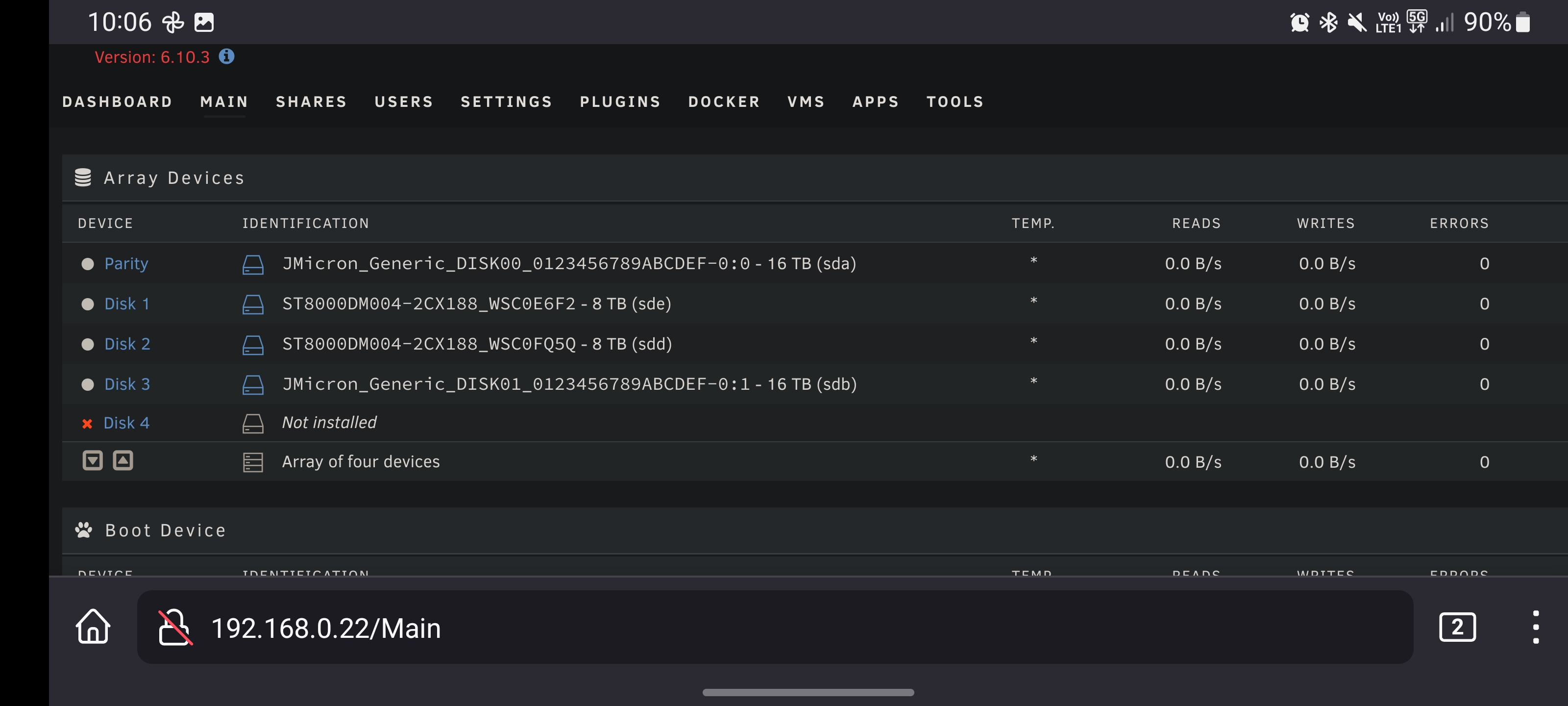

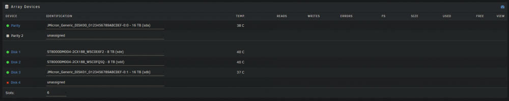

When starting the array in maintenance mode, the offending disk (labelled Disk 4) shows as 'Not installed' with a warning on the end of the line stating 'Unmountable: Wrong or no file system'. There is also the option at the bottom of the page stating that an unmountable disk is present and gives me the option to format it.
This all leads to the question of what should I do? I have contacted Amazon for a replacement of the new drive which will happen... sometime? They have given me absolutely no timeframe on this other than more than a few days. I obviously can't be using the array in the state that it is currently in. The last thing I want to do is lose any of those files so if there is a chance of data recovery from the parity data then I would like to keep that option open, but if there is anything I can do in the meantime to get access to this data again then that would be fairly helpful as there is a decent bit of important data on that drive.

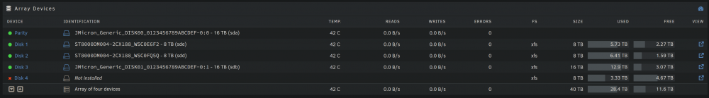

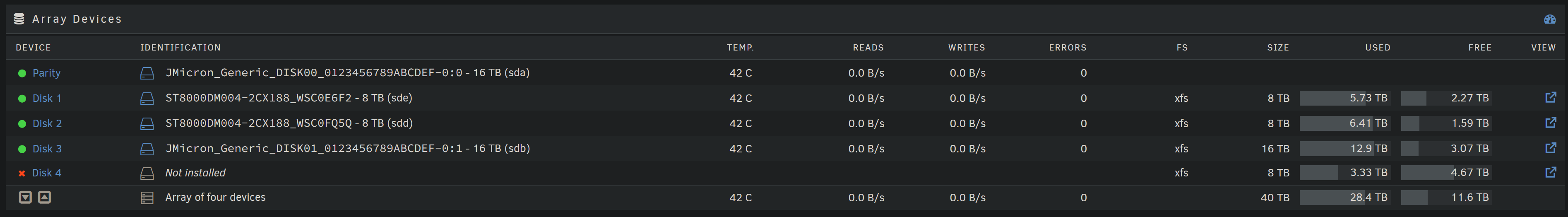

By chance I have a couple of screenshots from before the issue which I have attached, I've also attached screenshots of anything after the issue that I think could be relevant but please ask for more if it could be useful.

Do NOT format the drive - that will write an empty file system to the drive and update parity to reflect this resulting in you losing its contents.
The correct procedure to follow is documented here in the online documentations accessible via the ‘Manual’ link at the bottom of the GUI.

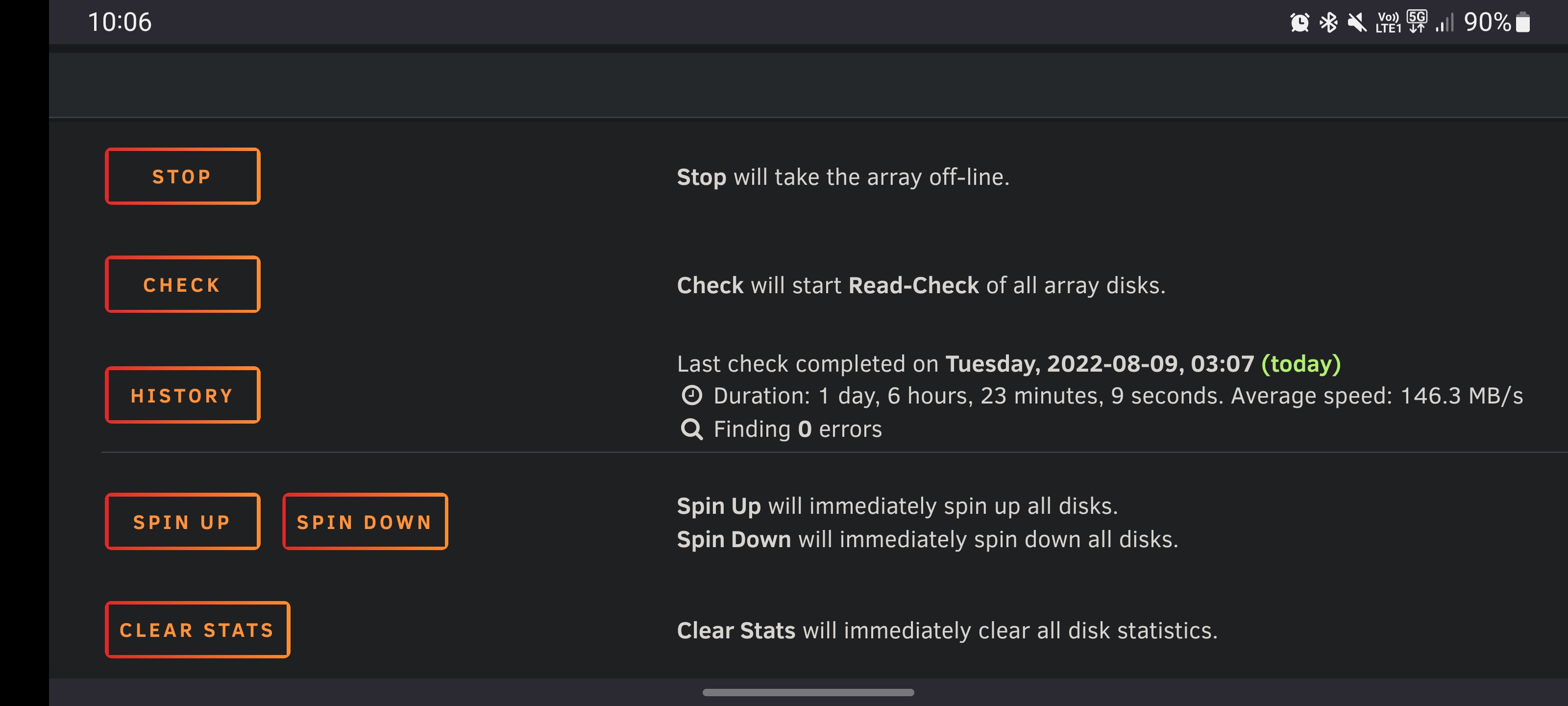

Okay, thank you. I will start a check now
The check just finished this morning and it found no errors, there isn't a repair button on this page that I can find and the emulated drive still isn't showing up as storage in the array. I've attached some screenshots of the page again
Post new diags after array start in normal mode.
I think you must not have done check filesystem at all since check filesystem isn't on that page.
Apologies, didn't realise there were two different check buttons.

And now, the emulated disk is no longer mountable. This makes me wonder about something and I'm not sure about the answer so I hope one of the other knowledgeable people on this thread will respond.

It isn't missing, it is unmountable. You could rebuild it but the result would be an unmountable disk.
57 minutes ago, ElliotJMD said:
That's the diagnostics after starting the array normally
I think the diagnostics were asked for because it was assumed you had repaired the filesystem. Since you didn't actually do the repair it is still unmountable.
